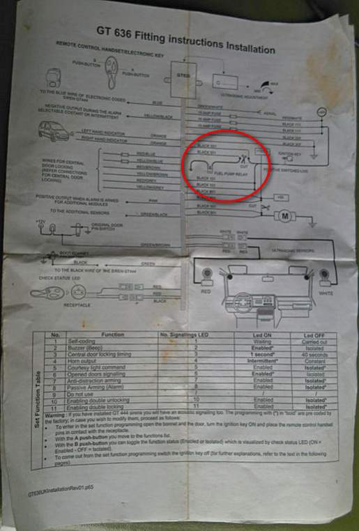

When you say you removed the alarm/immobilizer what did you do to restore the circuit(s) "cut" by it? Depending on make/model,
immobilizers often include the fuel pump circuit.
This is where I start to struggle it's an aftermarket alarm a GT636 I just removed the control box and unplugged the immobaliser. Thanks for the diagram I will have a look through it see if I can understand it haha. I have had search around and found a auto elec who works on on classic cars n kit cars near me so going to give them a ring in morning, I don't want to go tampering with something I don't fully understand really getting past my electrical skill now haha.thanks for help really appreciated will let you know how it turns out.
The alarm can cut power to the fuel pump. Are you sure when you're unplugging the alarm it's not just cutting the circuit completely, as you say it doesn't start now?
The car started last week with the same test today and I haven't changed anything inbetween just done some re tracing footsteps etc but could have easily snagged an old wire or something thats what im hoping anyway.i will have another look at the alarm after work tomorrow it's pretty easy to get too.
