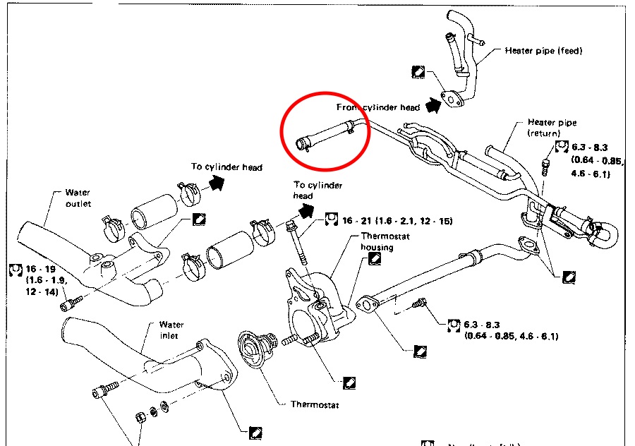

My silver tt has developed quite a coolant leak following a spirited drive. It seems to be coming from the underside of the plenum at the left hand side at the back corner. I can see a rubber hose which appears to be the place where the leak is coming from. The question is, do I need to remove the plenum to change it?

I'd advise you do it once and properly, doing the plenum water bypass. Pretty sure you can loop it out even as a temporary measure. Apparently it's to prevent an issue with the throttle bodies in very cold climates, i.e. not southern England.
https://z32.wikispaces.com/Coolant+Line+Bypass
Edited by Stephen
Wow, that is quite a procedure! Why not just replace the offending hose? How difficult could it be?
It's just a point of failure and getting to those pipes is a nightmare if in some cases not possible without plenum removal.
Why not link out the offending piece as temporary measure until another job that requires plenum removal comes about. Just a bit fiddly.
