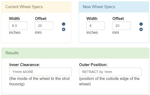

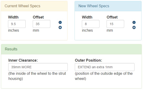

For example, a typical offset that many run. 9.5" @ ET35 (rear). In comparison to what I am suggesting for yours, 8" @ ET40 with a 25mm spacer giving you ET15 effective
Fronts, typically most run 8.5" with an ideal offset of ET25 vs 8" ET40 with a 20mm spacer (ET 20 effective).
Based on my suggestions on a known fitment vs advised fitment on the given spec, there's a variance of only 1mm. Sure, you need to take tyres in to account, but they're near as dammit.
