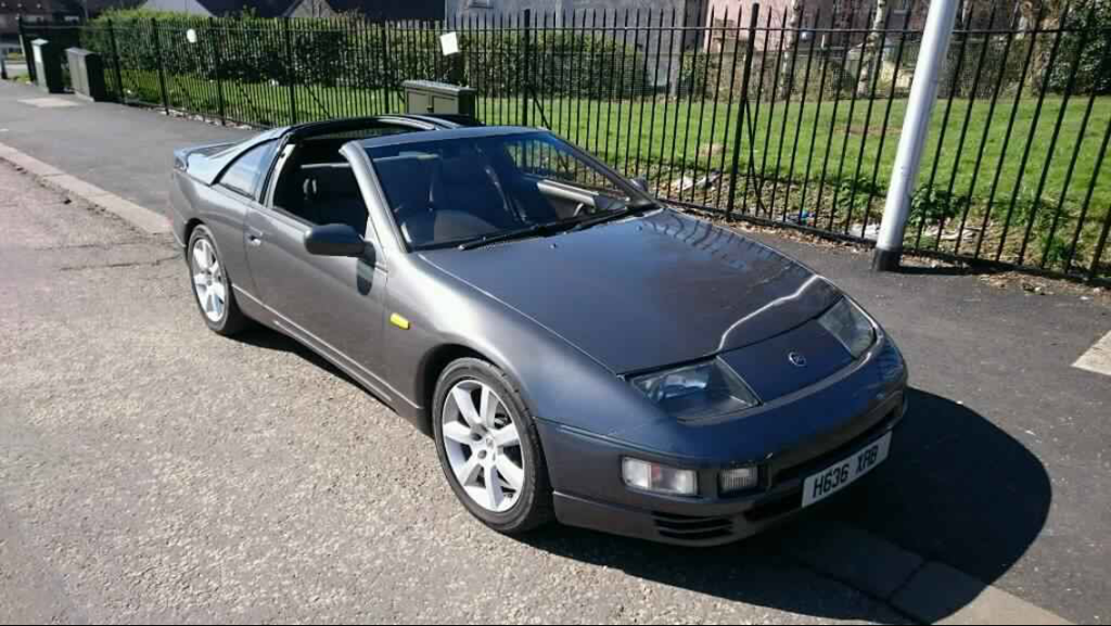

I've loved the Z32's ever since i first played Gran Turismo - back in the day. I've always wanted one but the time has never been right.... until now!
I've just purchased a twin turbo, auto Z. 49k miles on the clock so she's very much still a baby.
I got her for a good price but she has a small issue, the engine cuts out when it reached running temperature; i'm sure it's just a sensor. (diagnosing it Sunday)
But anyway, here she is. I love her, plan to convert to manual in a few months. Also on the look out for leather interior!

Hi and welcome Jay..... Nice looking Zed you have!!

Hi Jay and welcome to the club! Really nice looking car I always liked the gunmetal grey. I'm near Gloucester too and somebody told me they'd seen a grey car round here a couple of weeks back so I guess it must have been you. If you spot a black one that'll be me so give us a flash!
