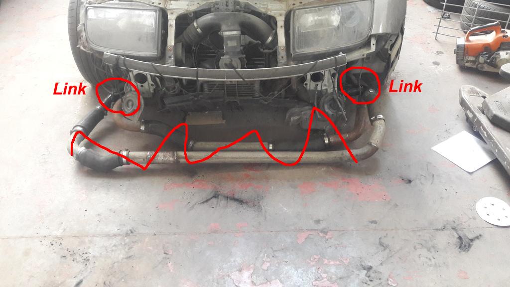

There is a default setting for a disconnected or failed maf which limits revs, with no inter cooler`s fitted the maf was not getting any air so was treated as a failed maf. Interestingly your temporary pipework was an over kill all you needed was to link the two sided pipes in an original configuration at each corner like in picture below.
Jeff

Never even had that thought when doing that with the pipes ill look into changing it when i get a chance as itd be easier to move the car around like that

Fair enough, if that's all you wanted though you could of just unplugged the MAF and driven it forward and back without that bodge pipe.

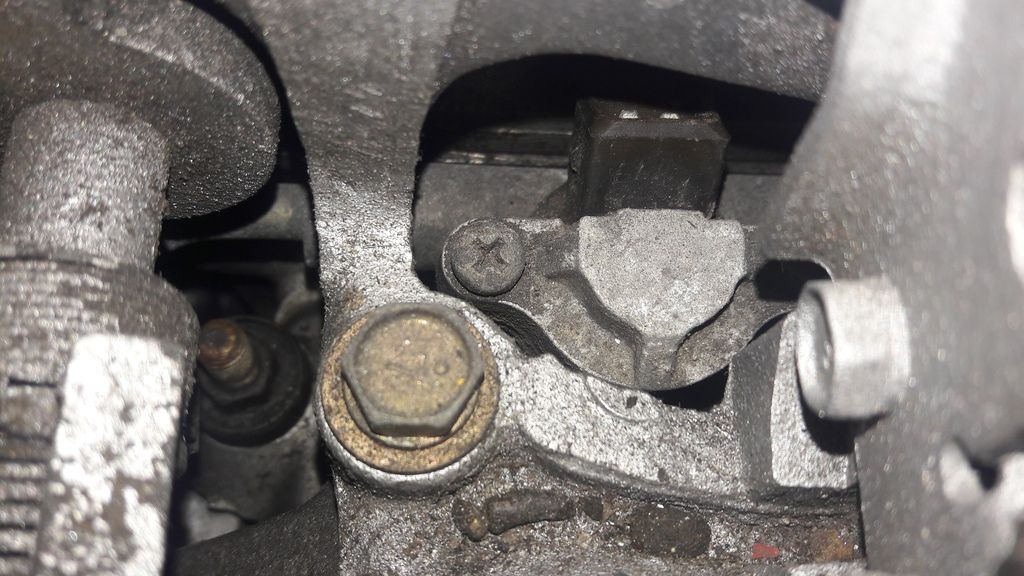

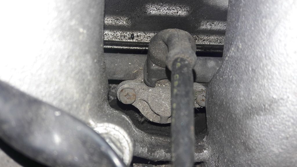

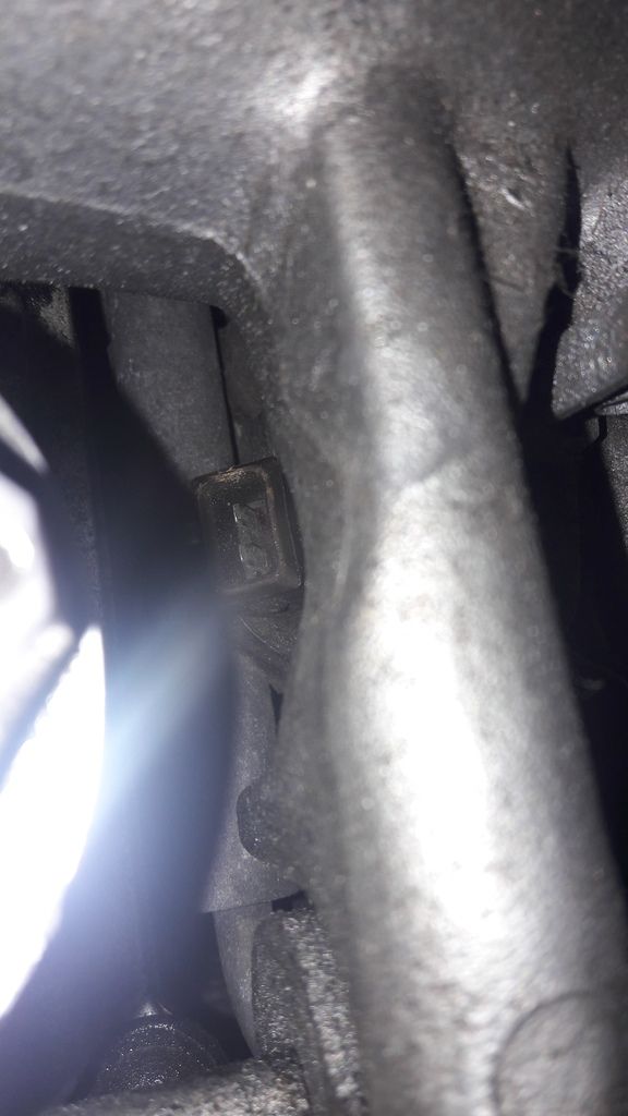

Throw up some pictures of the bits that are supposed to be different, we will soon tell you.
Ill dig an injector out in the week and put a pic up, i know the exhaust or at least the back boxes are different but not sure on others
See what colour the plastic top is on the injector, brown, red, blue, purple etc. that can be an indicator of what injector it is.

Ill have a look and see what colour the injectors are in a bit
