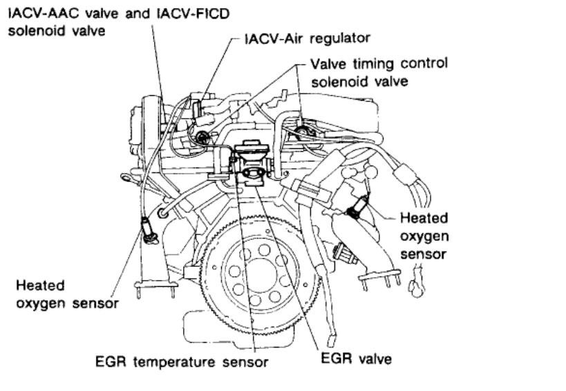

They are both for the cabin heater matrix matey2011-01-13_030006_95_300_back_of_engine_egr_loc.jpg
They can be removed at the flange, 2 bolts each. The picture, although not the best shows you the location.
