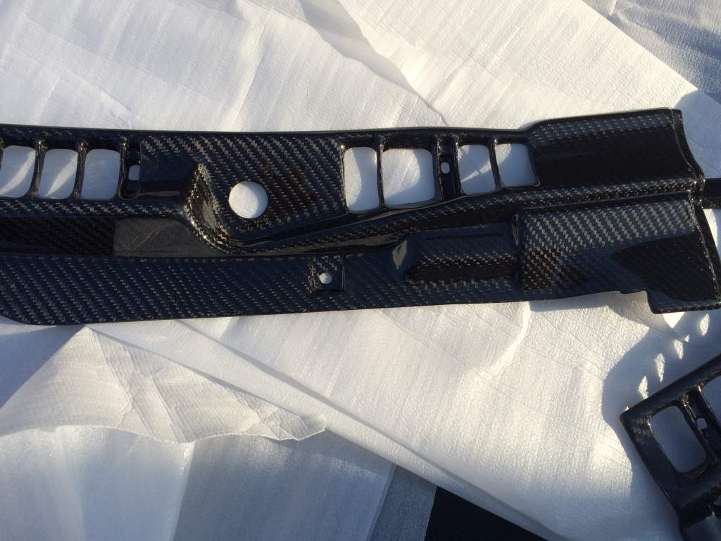

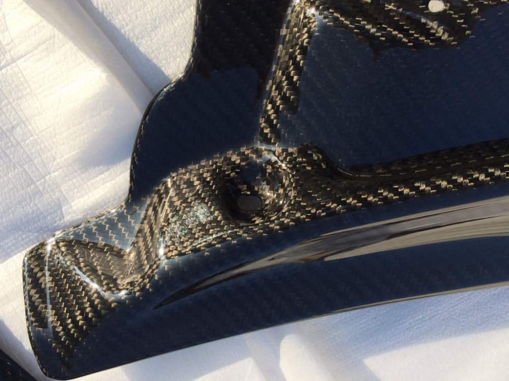

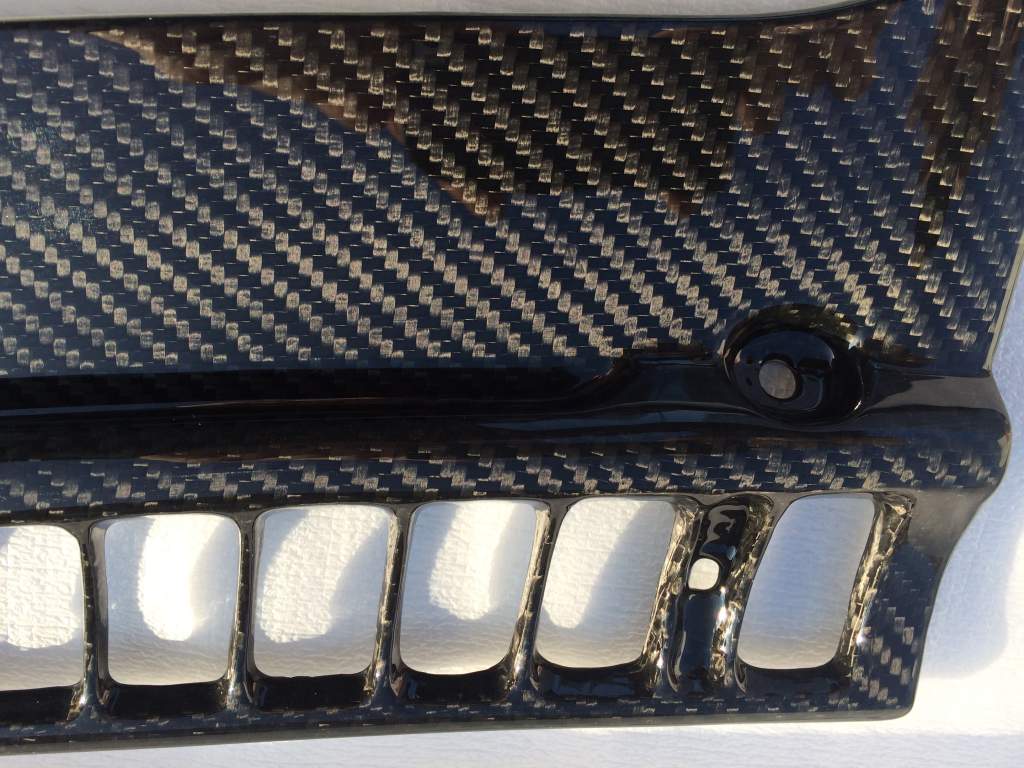

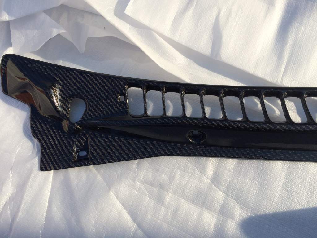

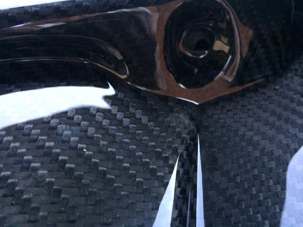

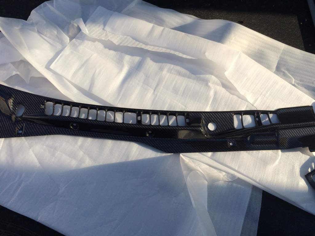

The quality of the carbon is very good, and the mounting points all look right compared to the set i left with him, although not tried against the car yet.
It looks like the molds he has obtained were the previously made ones that had the larger gaps already made. Unfortunately i didn't get a chance to see them before he sent them off for the test set.
I discussed this with him, and he claims that putting the extra ribs in could be difficult as the raw carbon material will have to be cut smaller when it is being made, and will be more difficult to put into place during the build up. This means the ribs have the potential to be weaker and risk cracking during use, which is obviously not desirable by anyone, whereas with the larger gaps, they are able to get the material into place easier and make the ribs stronger. He deals with quite a lot of car and bike parts, so has seen some of these issues before.
However, he will discuss with the factory to see what options are available, as these molds were obviously made a while ago and carbon manufacture has come along since then.
The way around for us is to bond black mesh to the rear of the scuttle which will blend in and would have been needed to take the place of the finer little mesh strips between the main ribs anyway.

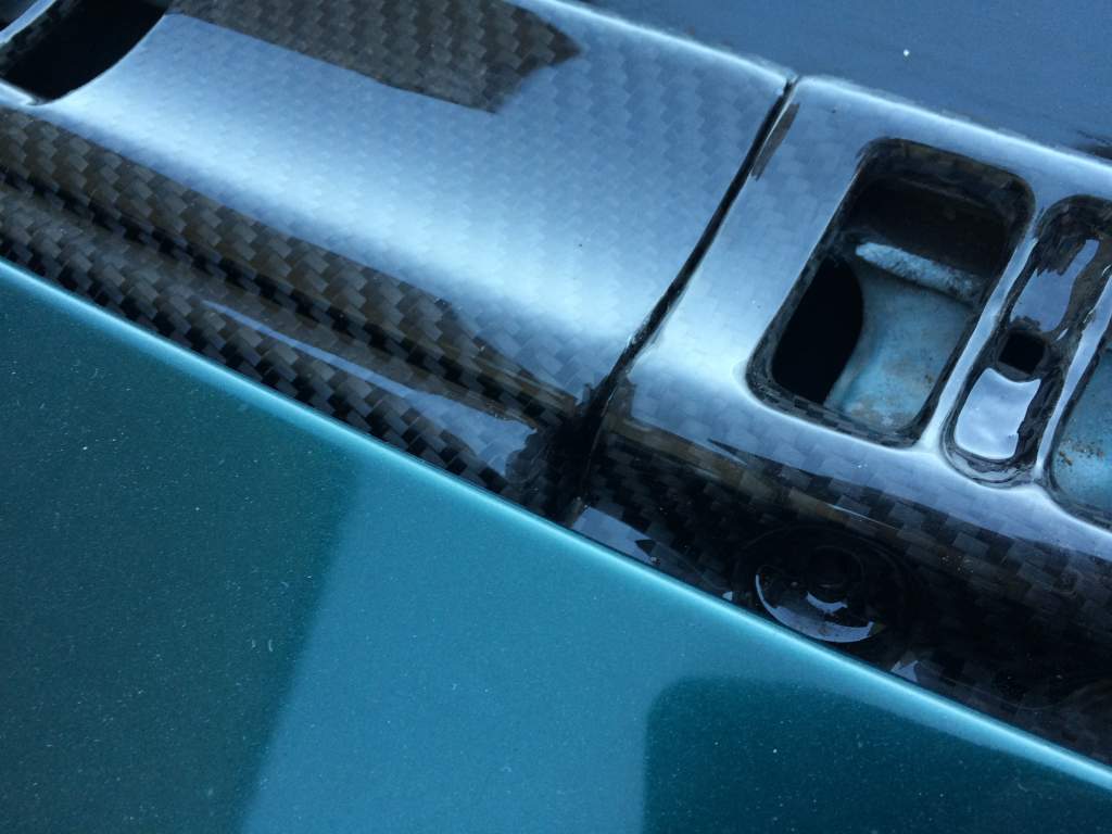

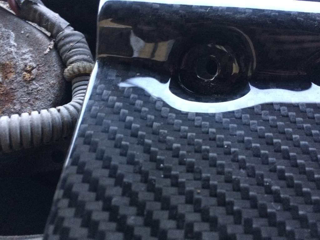

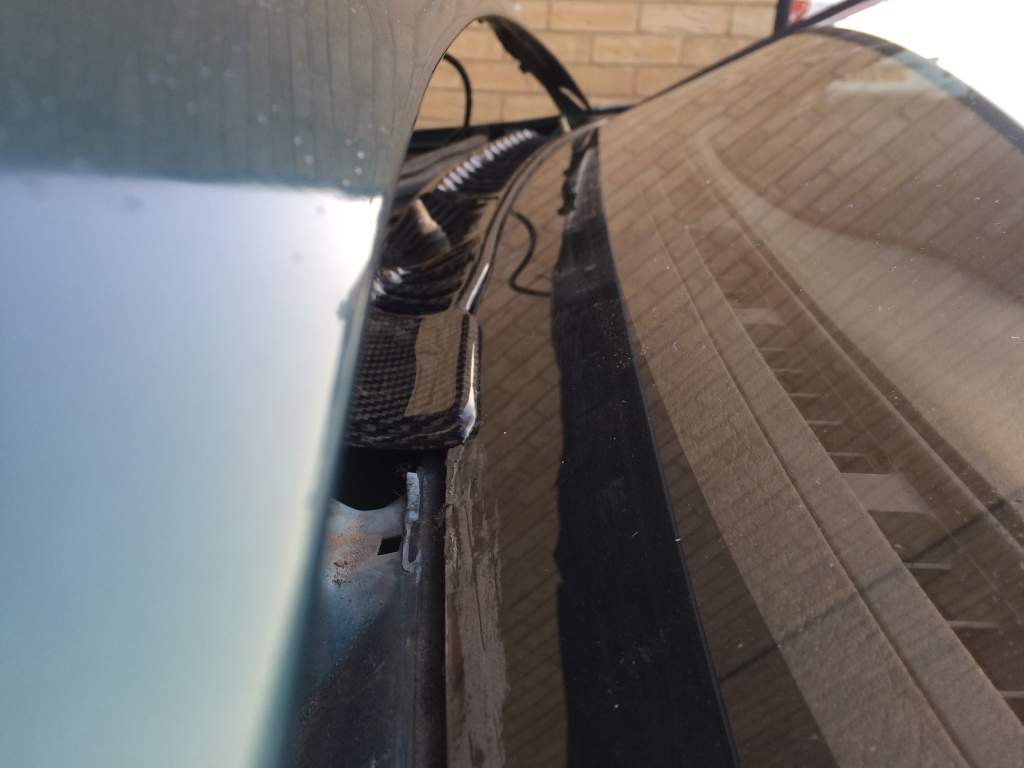

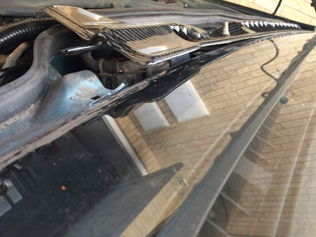

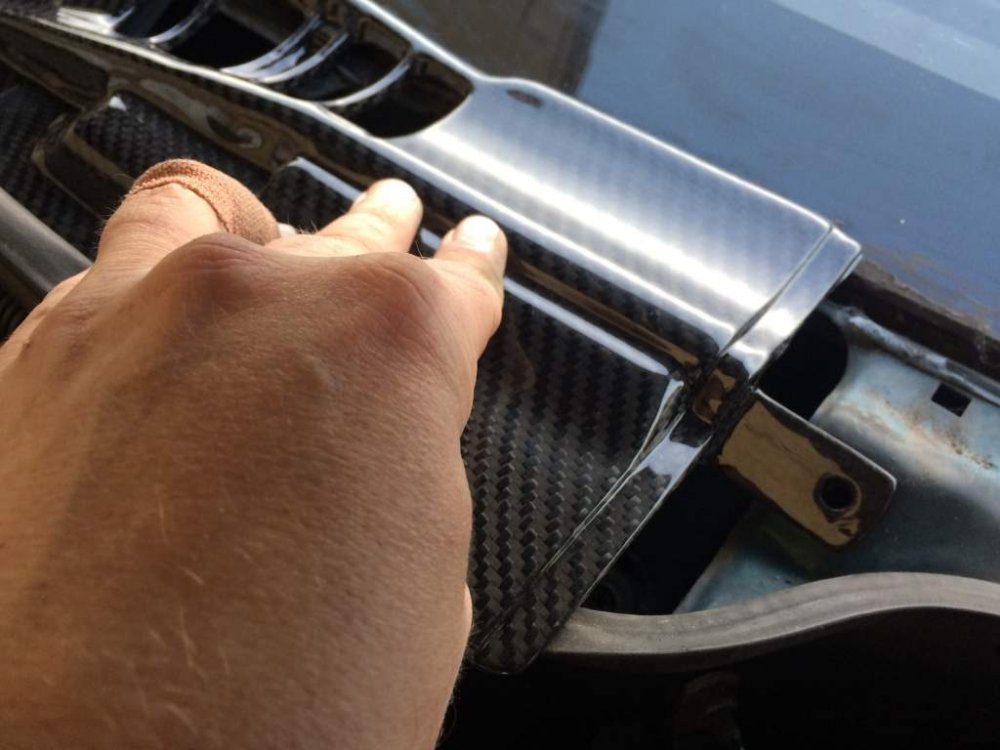

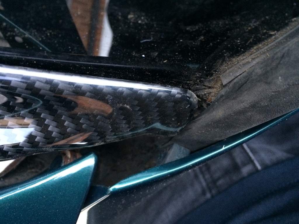

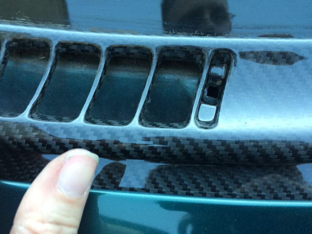

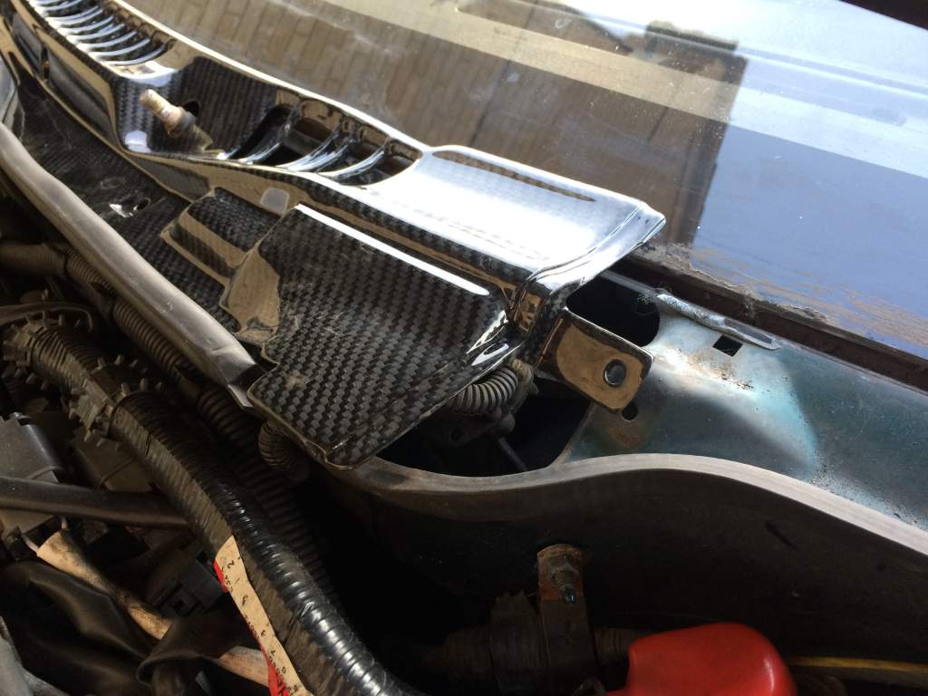

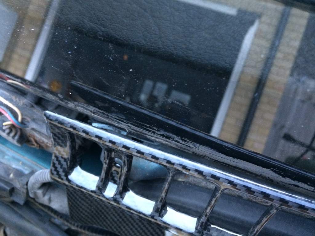

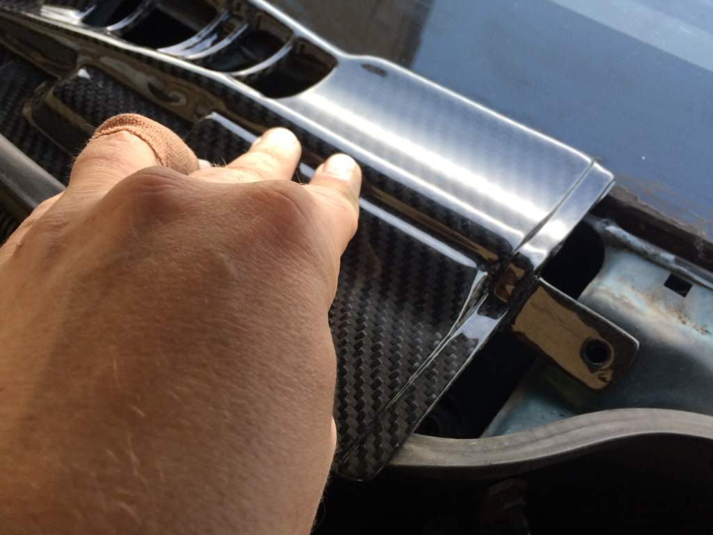

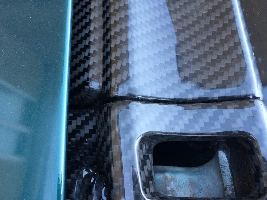

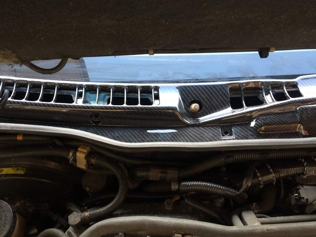

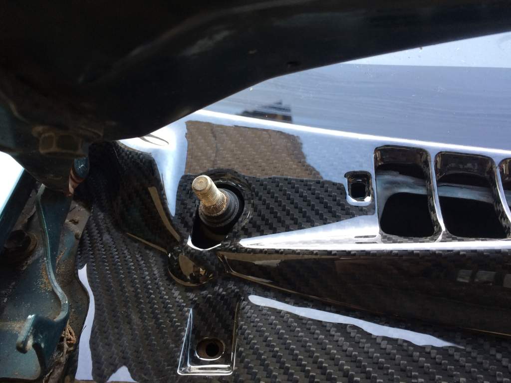

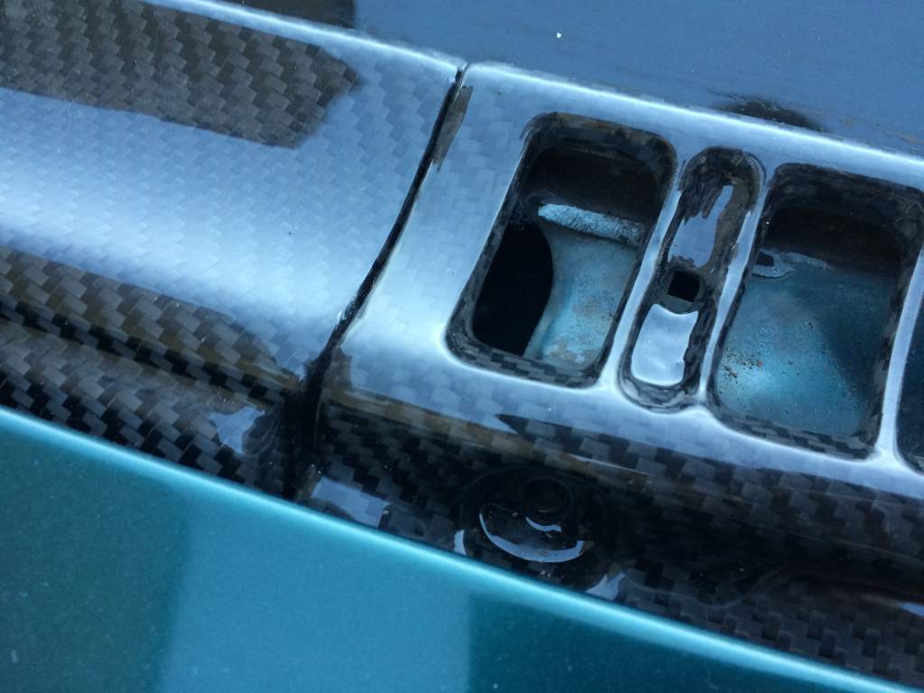

have some test fitting pics and comments, but probably need a bit more time and fettle, or some adjustment with the mold, particularly the smaller piece, mainly because they are much more rigid than the plastic oem pieces though.
the large piece lines up perfectly for all of the mounting holes, and although it doesnt curve with the window, flexes easily enough as shown and would easily stay in place.
the short piece will need one of the mounting holes opening up slightly, but the mounting holes are not quite 100% compared to the large piece. it is also much more rigid so i am not sure if the plastic clips would actually hold it in place or not when flexed to fit.
overall, they fit together well though, and they look good. i didn't try to fit the rubber trim piece or the clips as yet, i just wanted to check the alignment before the light faded.
Same as the old design Craig, the mounting point closest to the bonnet hinge on the small scuttle is a bit dodgy for sure.
seems that way Ian, i guess he got those old molds then. was that a problem before as well?
i will take them back with a car to show him the issues once i get the car back together again.
if we change the molds too much, then we may have to pay for new ones, which we should be able to do as a club if we have enough signed up for the group buy.
so i would prefer to discuss with him about making them slightly curved to fit the screen better if possible, especially the short one.
i hope he gets a positive result about discussing the extra ribs being put in then.
it might make a difference with the car, if we can adjust where we actually need the gaps to be and make them more relevant rather than just try to fit in with the OEM ones?
