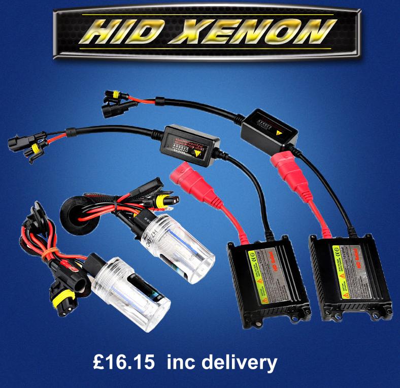

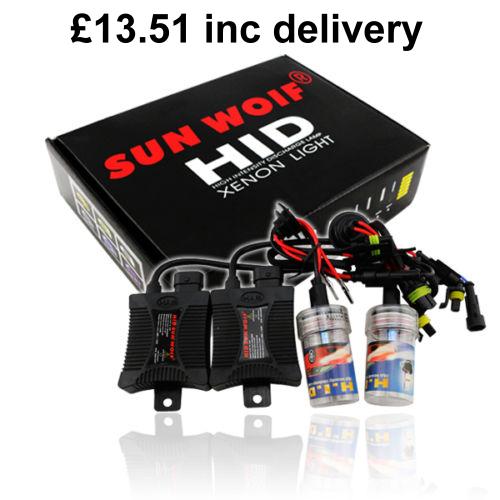

Hiy a buddy, well the technology has improved on the one`s on e-bay these days,was not uncommon for failures in the earlier days they were available so your small usage could bear that out. You might find by swapping the ballasts from left to right if it the bulb or the ballast, that way you could just purchase what is needed, having said that the kits are so damn cheap these days here is links to some.
Jeff
Cheap or what !!
http://www.ebay.co.uk/itm/Xenon-HID-Conversion-Kit-H1-H3-H4-H7-H11-5000k-6000k-10000k-UK-Stock-Free-P-P-/271515192686?var=&hash=item3f37910d6e:m:m6P7dnRJkNaWix410MorRZw
http://www.ebay.co.uk/itm/SUNWOIF-55W-HID-Xenon-Conversion-KIT-H1-H3-H7-H8-H9-H11-H4-3-4300K-6000K-8000K-/281413571138?var=&hash=item41858e5242:m:mqIHFWn80x-oJMCnQ_qukSw

I have VIP HID kit £30
I fitted them 2 years ago with no problems.
Correct you just need somewhere to hide the ballasts
And 8000k is very blue tinted
I prefer 6000 or 5000 for an ice blue/white, or 4500 for a yellowish tinge
