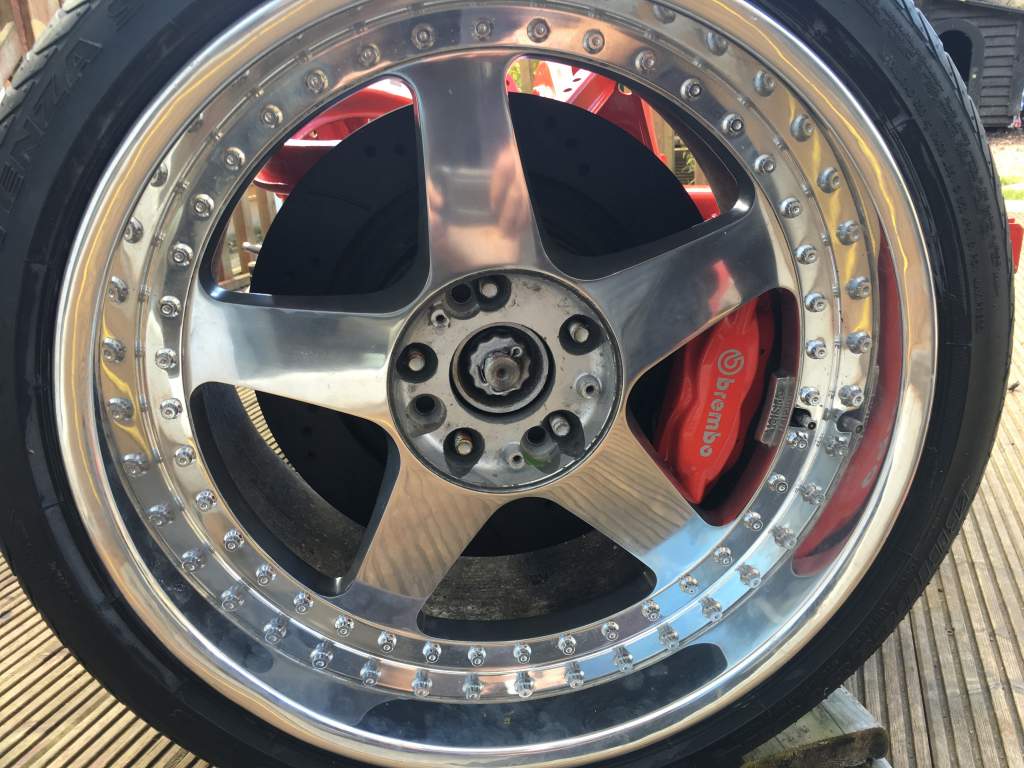

I'm running 4 pot calipers with 350mm discs, not a cheap conversion though, brackets, calipers, lines, discs and pads all add up to a pretty penny,

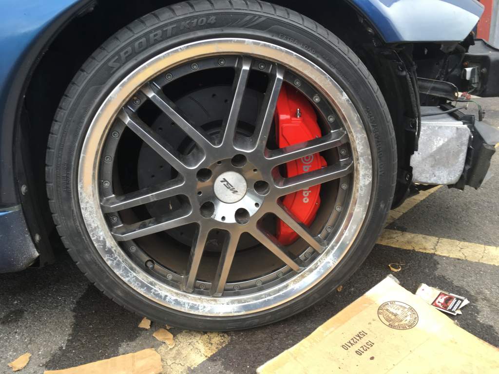

I'm thinking of selling my front 6 pot setup as it's too big for my 18" wheels
Rear with 4 piston Brembo's + 350mm discs
Front with 6 piston Brembo's + 355mm discs
[ATTACH=CONFIG]104155[/ATTACH]
[ATTACH=CONFIG]104156[/ATTACH]
