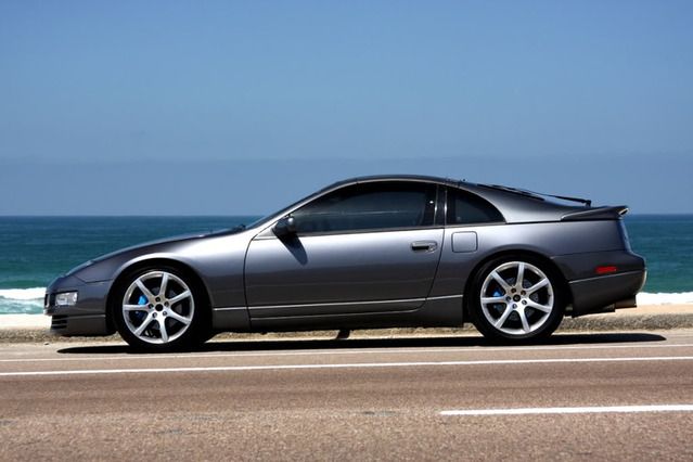

RX8 wheels....look good on a Mazda 6, but a little 'low-rent' for a 300zx. If you want that style of wheel, then try and find yourself some 350z anniversary wheels, they do work pretty well on the Z32, although not something I'd go for either. Not that easy to find in the UK though.
These are nice and fairly hard to come by.
http://www.ebay.co.uk/itm/Nissan-350Z-Skyline-Infinity-G35-Alloy-Wheels-Tyres-/272484099564?hash=item3f715165ec:g:orgAAOSwPCVX56ty
However these are my favourite if you want a wheel from the 350z/G35 era on a Z32
http://www.ebay.co.uk/itm/Nissan-Skyline-350GT-350Z-18-x-8j-Wheels-Brand-New-Tyres-5-x-114-3-/132039068096?hash=item1ebe2449c0:g:ieIAAOSwa~BYRGnw
IMG_0323.jpg~original
if I'm being honest, I'm just looking to swap my 19s out for something a little smaller and bola like. I like the 7twenty style ones too (type 49) but with the extensive work in im having done to it at Lees, something cheap for now is the option...or a swap of course. I like the 2nd image the best although not the style I'm looking for. Appreciate the comments. Thank you.
