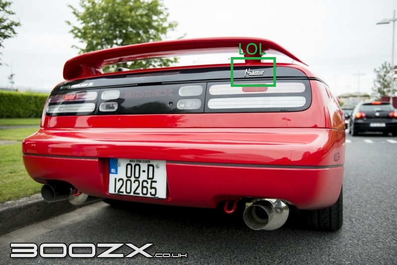

Looks like a nice car though, but would benefit with having those nasty headlight stickers removed and the cheap looking Halford decals stuck to the rear end removed. Strange goings on under the rear bumper.
Few other nasties, the turd-coloured retrim is questionable and what the hell is going on with the re-positioned indicators and the empty hole with a bit of wire across it? That's hilarious.

Lol. Those are some real genuine badges not the back right there haha
As if Nismo would produce something that looks like that.

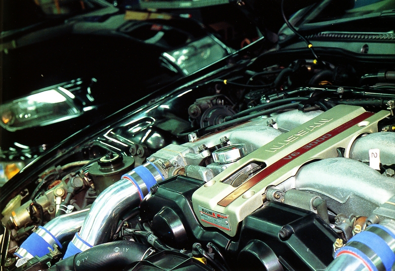

Just for the record Nismo did get involved with production Z32s with the "Refresh Program" based at the Nismo Omori Factory.
Customers could have their engine and chassis overhauled by Nismo engineers. The cars would have a badge fixed to the front
of the throttle cover as in the picture below.
[ATTACH=CONFIG]103171[/ATTACH]
[ATTACH=CONFIG]103170[/ATTACH]
I don't call it a Nismo Z32 :lol: Badge came with the car!
[ATTACH=CONFIG]103174[/ATTACH]
