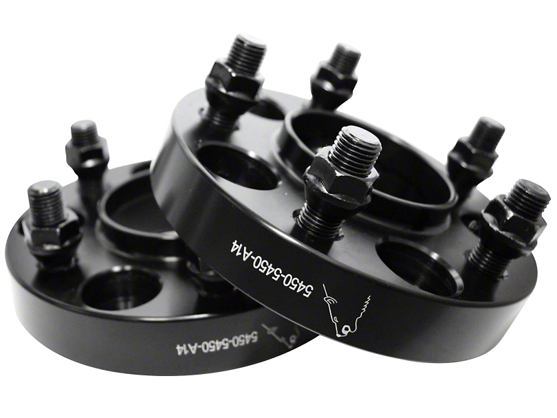

Put the number plates on at the weekend so this is something of a rebirth for it! Swapped the wheels over from my old zed as the ones it came with had a terrible offset, needed 10mm spacers to get over the front stock calipers and thus only had 3 turns on the nuts.

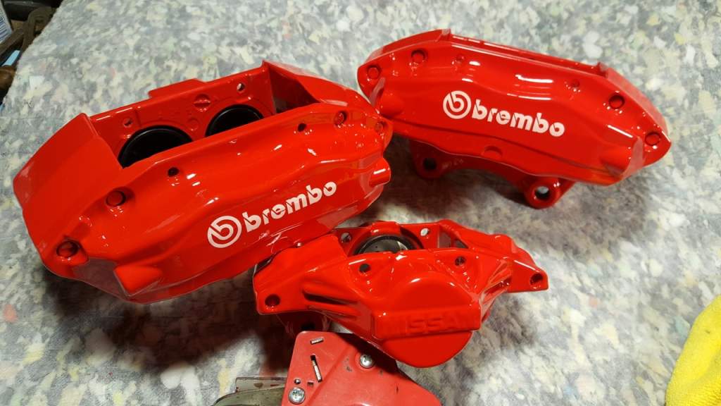

In terms of actual work, brakes have been sent for powder coating, now have a passenger seat rail (bride RO) but the rail is so low you can't pull the slider handle up as it's touching the seat! So I'm having some spacers made up at the moment, should be here soon. Will make the seat the same height as the drivers. I should have just got two of them really, but live and learn.

Finally got a chance to get some work done last weekend, forgot to post though! Got all the brakes finished, very pleased with them
