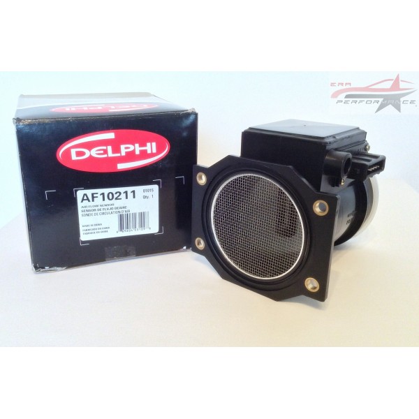

Hi all just a note to say a big thankyou for all your help. Maf was to blame and got one from work all running.
Well we didnt really list one. So I used some suppliers and got a delphi one delivered...not easy to get hold off
Af10211..... is this an incorrect part. Seems to work spot on
Be interesting to see what kind of signal readings it produces on a Consultant screen.

I didn't pay that price for it..... got it cheaper. dows any1 know where I can download an diagnosis software from and where to buy a 14 pin connector
