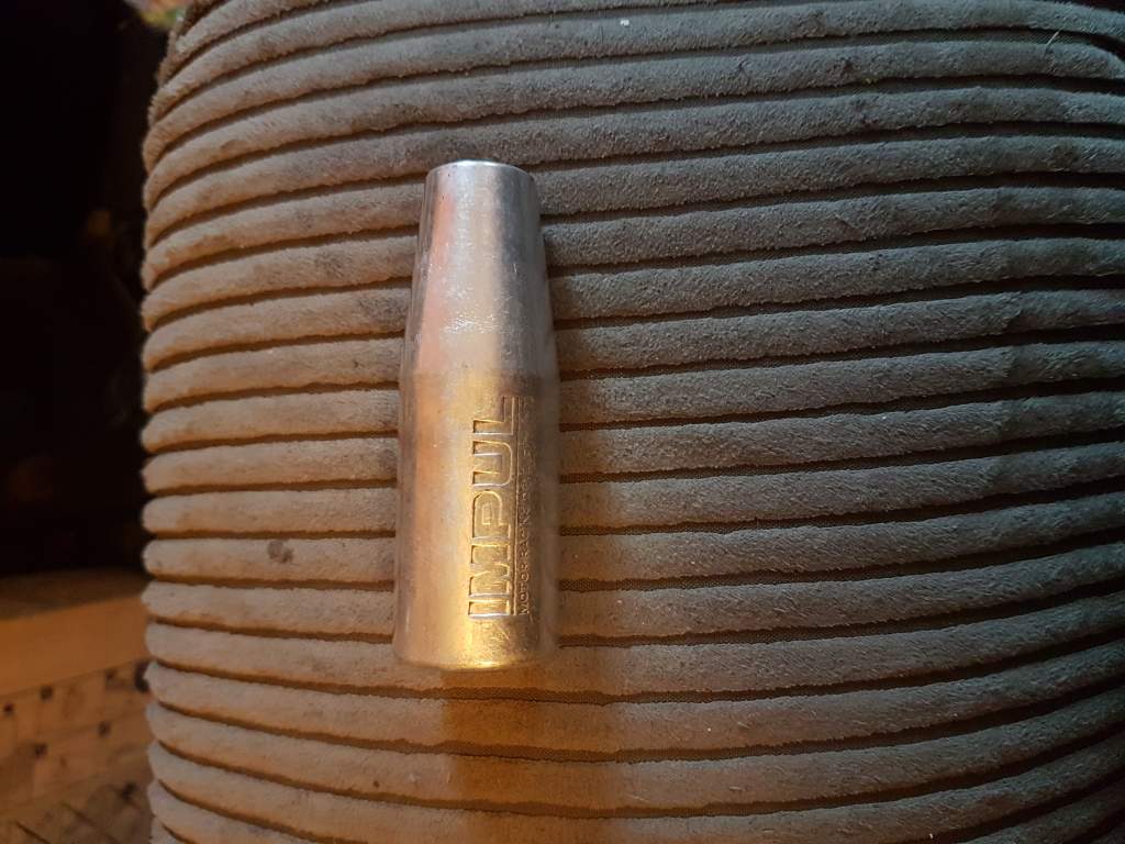

As my car is an Impul 932s, I'm trying to get original impul parts to complete the 'set' if you like, and one of these was this gearstick as one of the options:
So there was my task.
So I took an aluminium rod and cut it to length
Then did a big chamfer, drill a large and small hole in the end and tapped a thread into it.
Then used a piece of stainless steel, thinned it down to the right size and put a thread in that.
Then I briefly did the top by chamfering it but its rushed and will need redoing.
Here's what it looks like:
So body nearly done.
I moved onto the brass bushings because it's not worth buying them
Drill hole in the centre
Thin down to minutely the diameter for a snug fit. (Admittedly I overshot twice)
And hit it really hard with a hammer.
And the smart ones of you will notice the previous owners budget attempt at a short shifter, but welding a bit on to make it longer [emoji38]
Not to everyones taste but I want to make my car as the original from IMPUL with all options checked.

How on earth are you going to stamp the "Impul" legend into the knob....?
I can't really do it, so the best I can do is acid etch it into the surface.
I'm sure someone will be able to laser engrave it?
At which point for one, its economically unviable. Working on the thought that one from Japan would cost double its cost to your door you'd be looking at £50-60. You'd be paying an engineering company for an hour, set up etc. What's an hours labour, 50? And you've still got a fake and the end.
Well done on learning some stuff Ali.
As Stephen says, it would probably not work out well from a pricing perspective, but perhaps I could bribe the school teachers into using theirs. I don't know how well it would work on such a curved surface though, may have to do one line and then rotate it etc.
