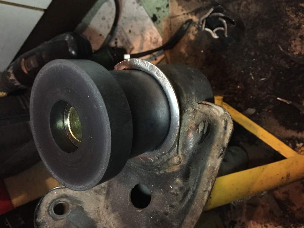

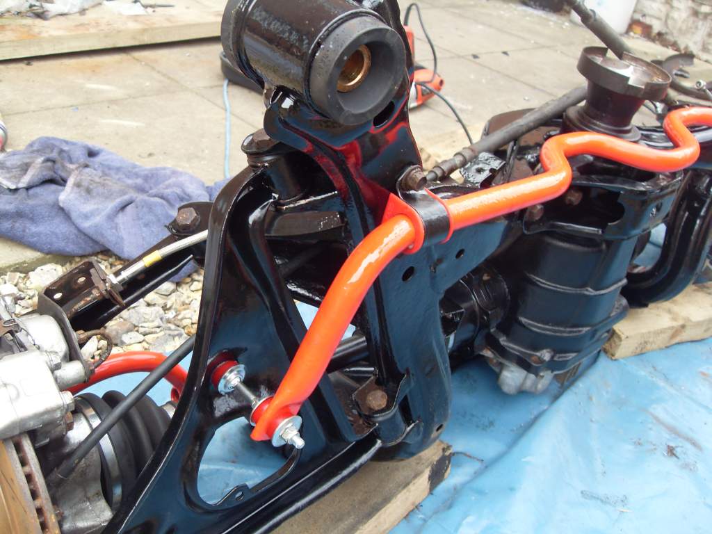

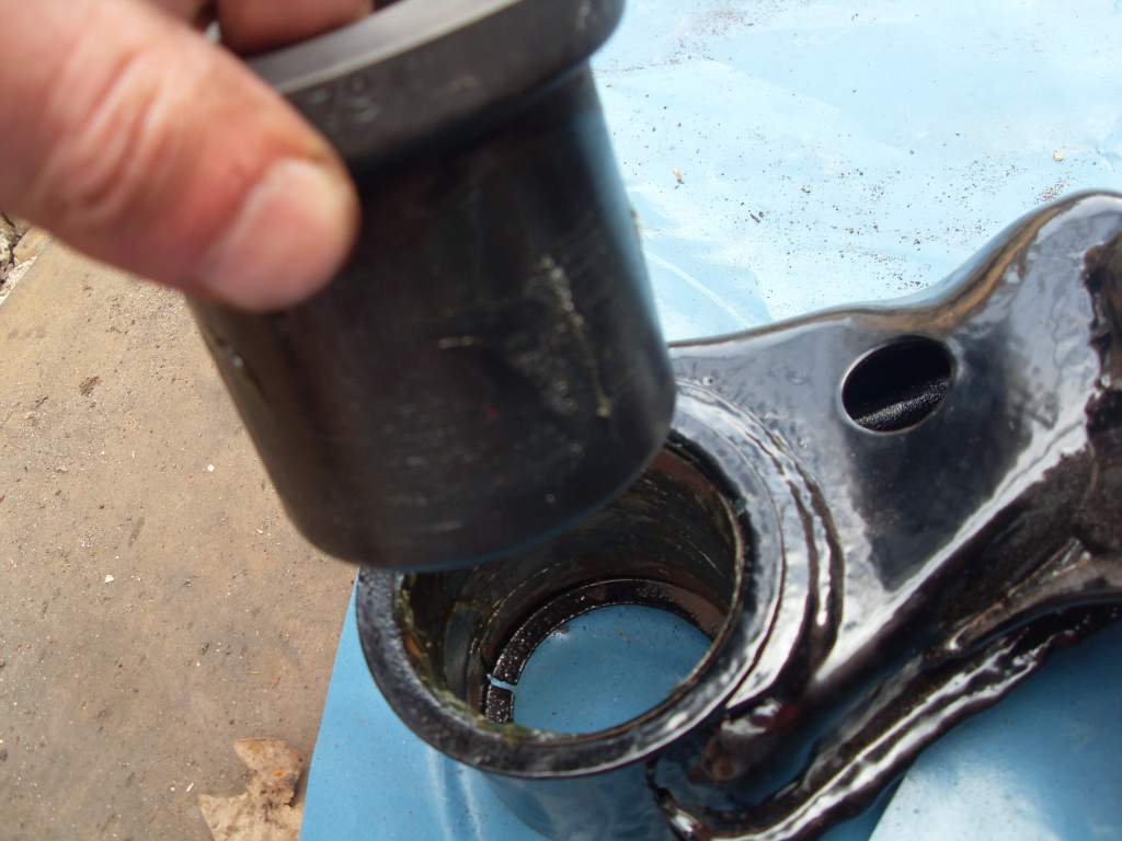

burn them out them remove in inner skin then fit the new poly bush when i did mine there wasnt a metal sleeve that came with them looks like they have changed the kit a bit.
here the pics of mine
[ATTACH=CONFIG]102090[/ATTACH]
What sway bar is that mate? Is it much better than the stock sway bar?
Edited by Alic
stock uk bar so its thicker than a jap one

Dan, the kit in the link above was including a new outer sleeve as many people remove this, not realising that they need to retain it, if fitting new Poly bushes.

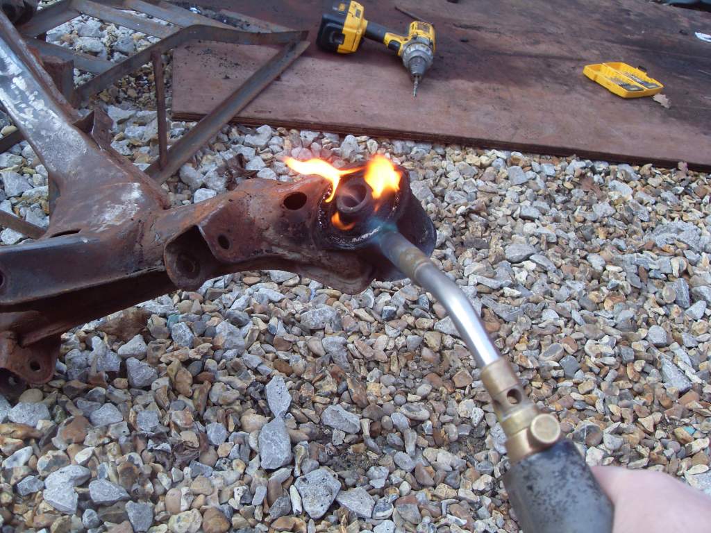

I had little difficulty in swapping out the diff bushes, blow torch made short work of them:thumbup:

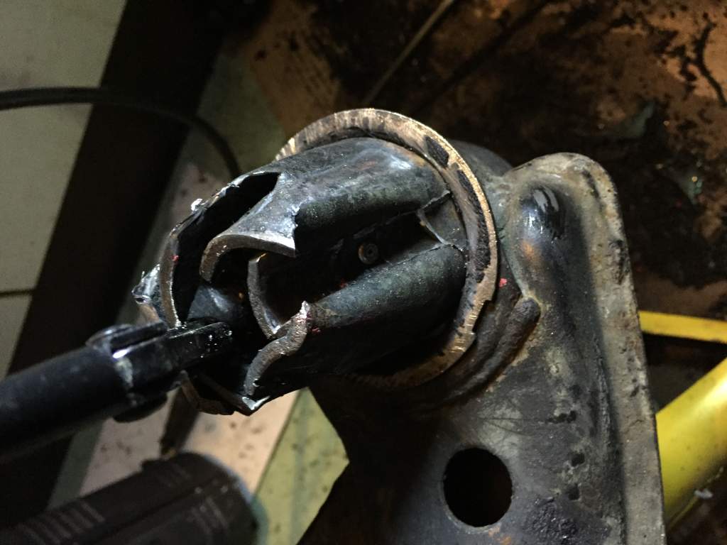

Remove the guts of the bush and cut the outer sleeve with a hacksaw carefully. Then fold inward and cut again if required. Taking your time is the key to success I think with these.

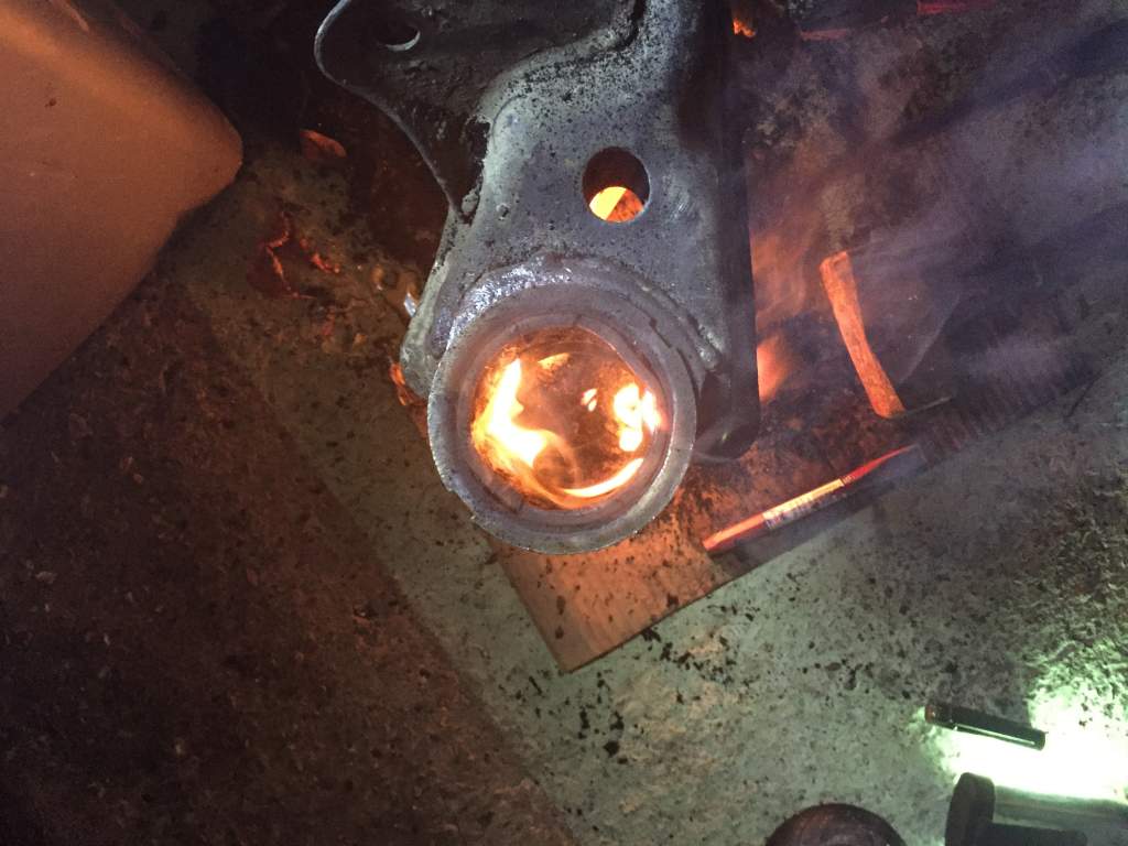

Well a little update. I removed the old bushes, what a pig of a job, that was!

I've removed 4 sets of subframe bushes now .I use a good quality hole cutter both sides to remove most of rubber and centre tube then hacksaw thew bush case but don't cut into subframe.Then chisel bush in on itself folded in and hammer it out .Ive done all 4 in2 hrs .

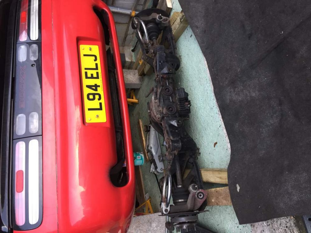

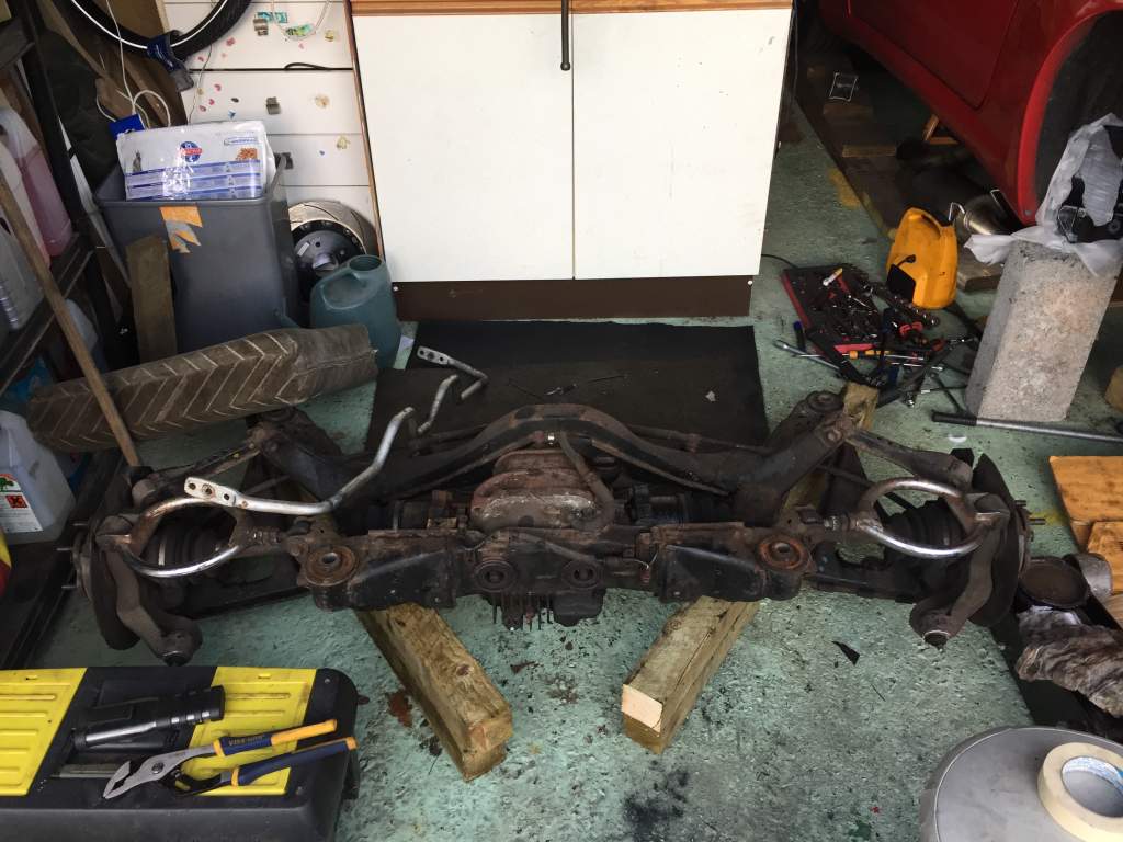

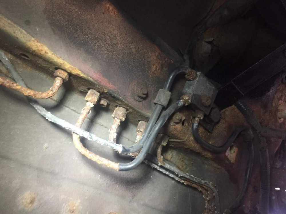

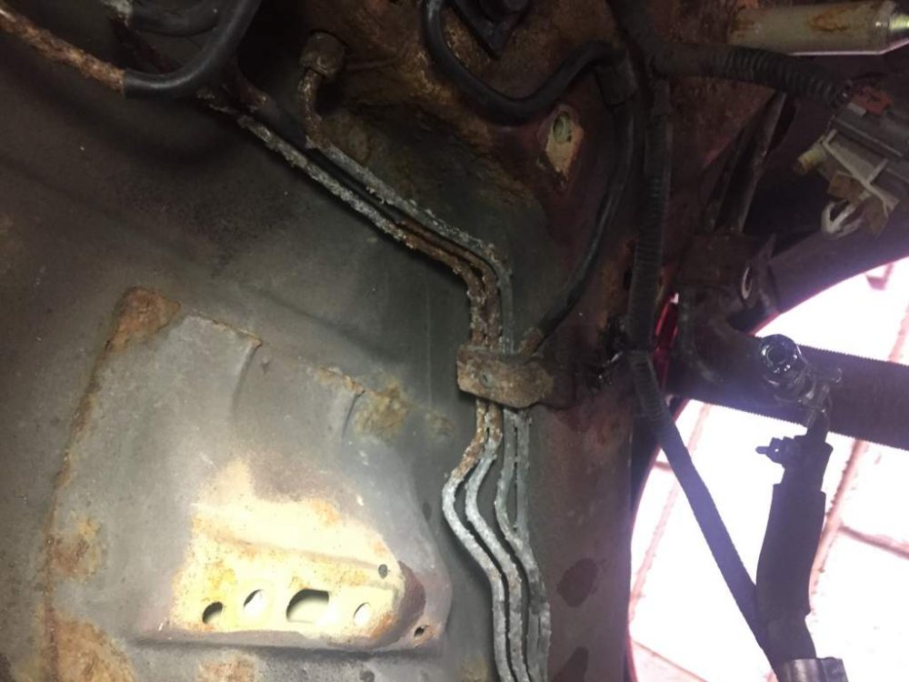

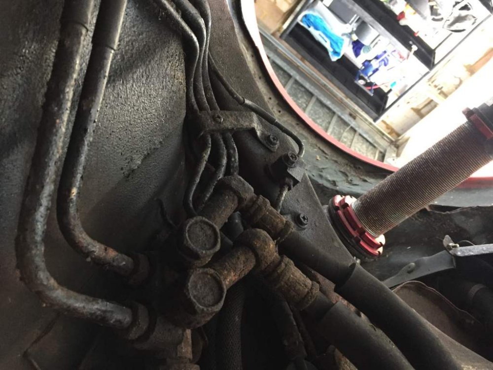

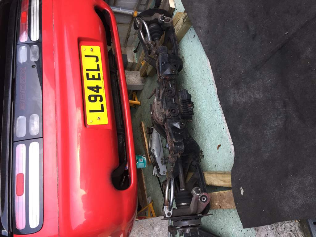

Well today the subframe was finally removed from the car, not to bad once everything was out the way. Nearly missed the 2x feeds from the top of the diff, that go to the oil cooler, but seeing as I am going to remove it anyway I just cut the hoses to the cooler.
Tomorrow I will start remove the control arms etc so I can get all the parts powder coated.
Oh sorry, neither of mine had any diff cooler lines or an oil cooler.
Also what happened to the HICAS on that? It looks absent, but there is no lockout for it
Already remove the HICAS Alic, jusr prior to dropping the subframe. A nice new Driftworks lock bar is going back eventually.
Still a long way to go as I will be replacing all the rear brake lines at the same time.
No worries about the oil lines, I saw them before I went to far, just couldn't get to them until the frame had dropped slightly.
Well on the way then Howard,those brake lines should be easy now whilst its all apart.Quite a weight all that lot to lower down isnt it !
The diff alone weighs more than a small planet. :lol:
