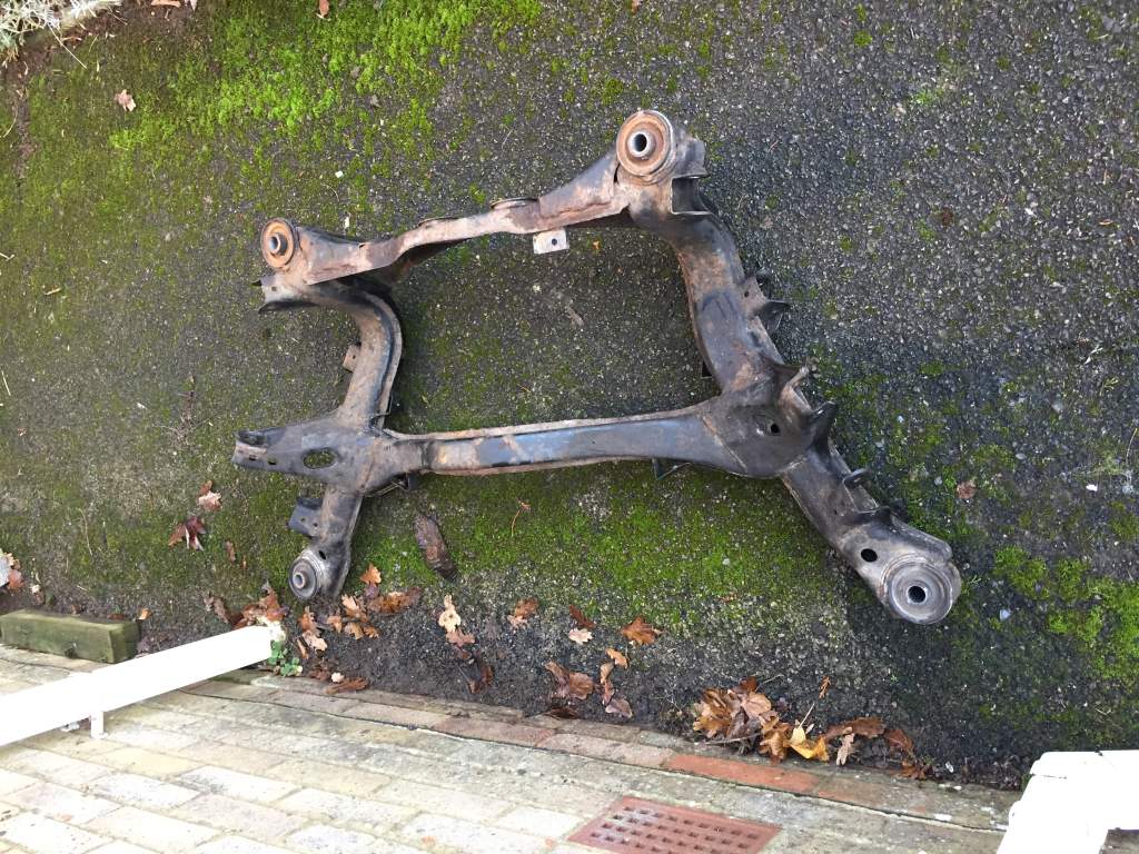

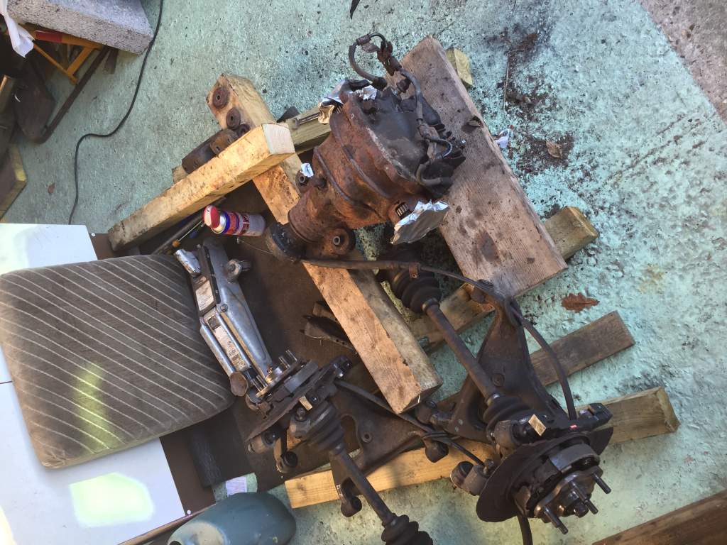

Old subframe stripped of everything
Now just a pile of parts to start cleaning up, painting and re-bushing
Out of curiosity was there oil in the diff cooler lines you cut? What condition is the diff oil cooler and motor?
No oil in either on the lines. The oil cooler isn't to bad, can't remember the motor, but I will get some photos for you.

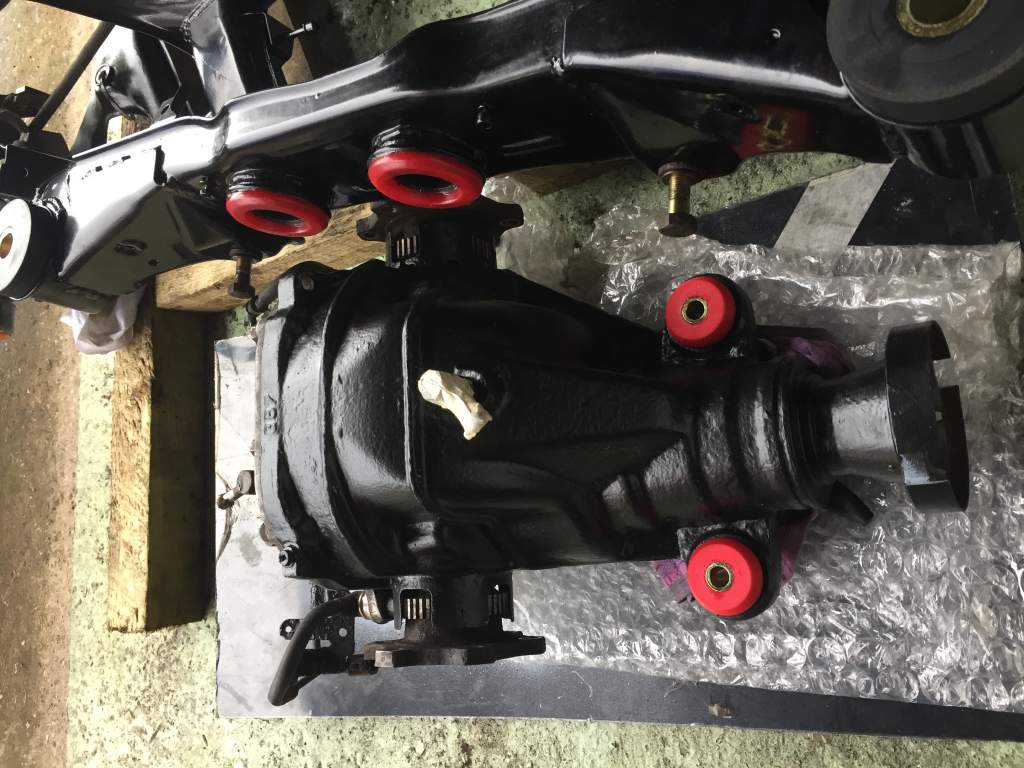

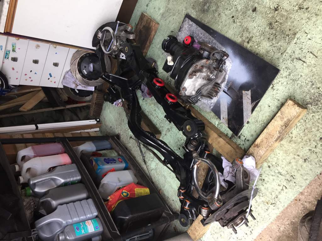

Managed to get to spend sometime on the car yesterday, and finally get most of the rear suspension etc, bolted to the subframe. All of the OEM bushes have been replaced in the control arms, tension rod and hub knuckles, with Driftworks poly bushes. Whilst stripping the lower control arm, I installed new ball joints. I had to admit defeat on the ball joints, in the hub knuckle for the HICAS. After spending nearly 4hrs just on one of them, I gave up and took it to my local garage who pressed them out for £20 :yes:
The subframe bushes and diff bushes have been replaced with Energy Suspension units. They weren't that difficult to replace, just time consuming really, carefully, drilling cuttting and a bit of burning involved. Differential bushes being the easiest of the lot. The diff oil has been drained and I'm just awaiting the new Redline oil from Opie Oils. I also replaced the 2 mounting studs and nuts on the diff as the original items were heavily corroded.

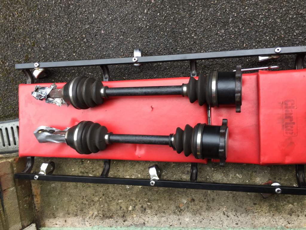

The subframe was powder coated by a local firm. All of the other parts diff, arms etc, were cleaned up with a wire twisted/knotted wheel in the angle grinder. Hydrate 80 (a rust neutraliser) was then applied to everything, followed by zinc primer and 2 coats of POR 15. I gave the drive shafts a good clean plus coated them with Hydrate 80 again and POR 15, for good measure. I have new Driftworks lockout bar to fit and that is pretty much it. Now time to move onto the rear brakes lines........

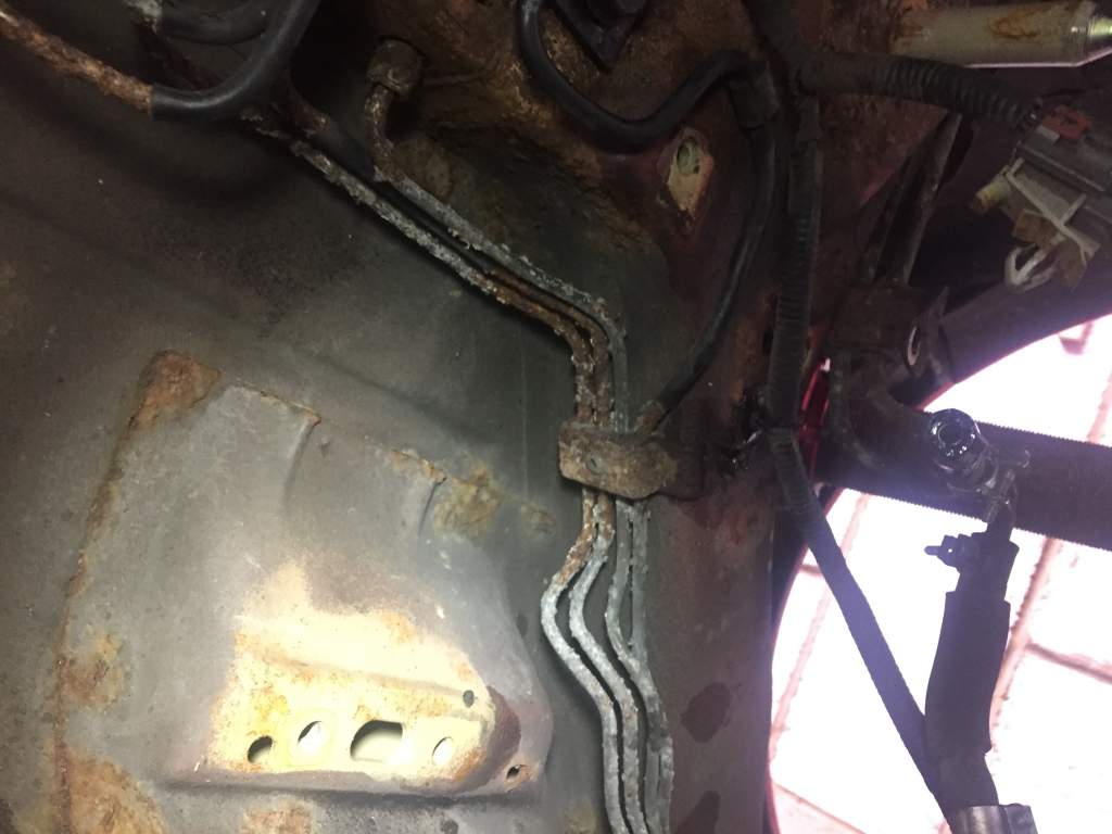

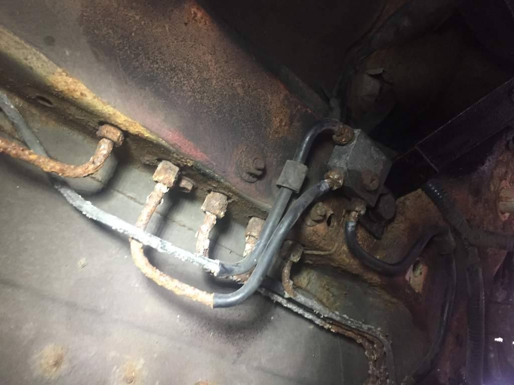

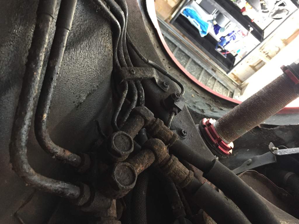

The rear brake lines not looking good....
[ATTACH=CONFIG]104764[/ATTACH]
[ATTACH=CONFIG]104765[/ATTACH]
Hi matey,
just done my brake lines using 3/16 kunifer pipe, I bought a kit from ebay that included a pipe cutter and flaring and bending tool tool similar to this
https://goo.gl/images/2iQFI5
on ebay from vintage warehouse 65
be sure to get the heavy duty flaring tool for the kunifer pipe
I also covered my pipe in a heat shrink material to give it the factory look, best way I found to bend the pipes was to have the original laid out and then start from one end
bending to match the old pipe but also cable tie the pipes together as you go along
have a look in my rust arch repair thread mate
Cheers hanks for the tip on the cable ties, I will give that a go on the remaining pipes. Already borrowed a similar tool for the pipe flaring, it's not to bad once you have done a couple. Hopefully finish the pipes this weekend, just need a couple of coats of Hydrate 80 and sealer then should be good to steady re assembling everything.
