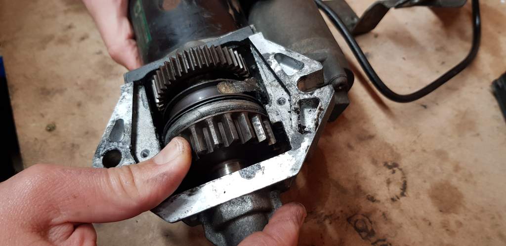

Clamp it in the vice and put power to it.
You should be able to check if it goes fully in.
Its not 100% a test of whether it will turn an engine as you cant load it up on the bench.

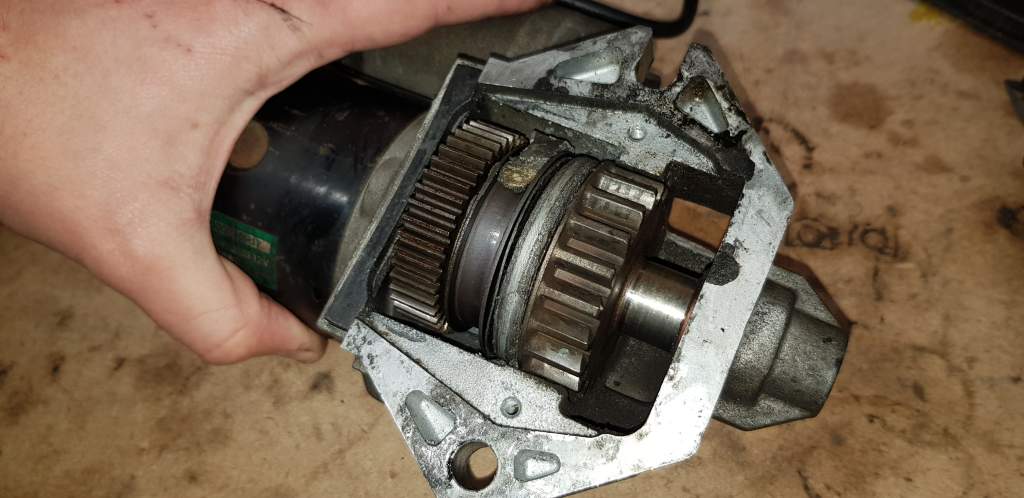

Just did and the start motor is dead.
Connected it to a freshly charged 12v battery and its not even making a noise.

Sooooo,
After i replacement Starter arrived from Mike Sandford (many thanks).
Fitted it and gave it a bash and it nearly got there :(
First time i tried it i cranked ok, but after that it stopped again.
Trying to discover the route cause is slackened off the belts slightly and hey presto, it cranks first time now.

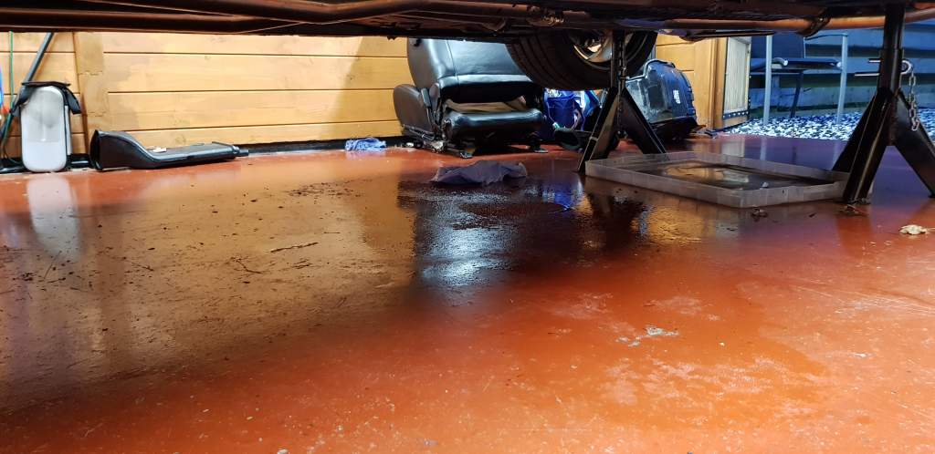

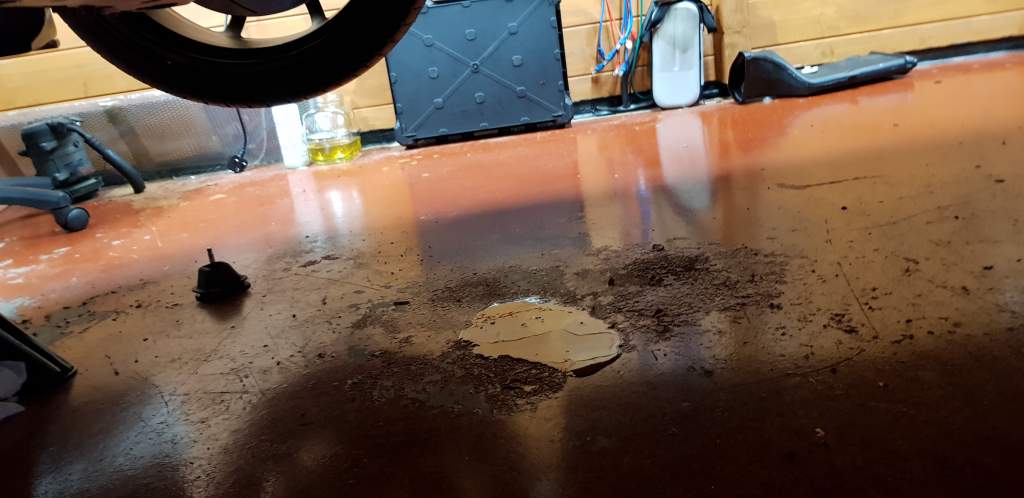

Then i heard alot of dripping from under the car so quickly pulled the key.
And now i have a puddle of fuel and oil on the floor.
As its not starting properly due to under fuelling there was a buildup of fuel in the exhaust which eventually came out 1/2 way down as the bolts are not tight.
I pulled a few coil packs / spark plugs out to make sure it wasn't flooded.

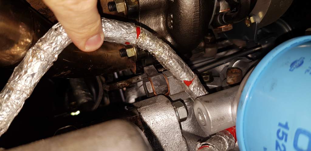

The other issue was a oil leak from the driver side turbo feed.
Seems i have a little corrosion which i thought was passable as i cleaned it up but guess not as it poured out.

Ok, so...
1) you sure that’s fuel that’s leaked out the exhaust and not just condensation tainted with fuel? If that much fuel made it into the exhaust I think you’d have hydrolocked the engine
2) have you checked you timing is set to 15deg BTDC? It’ll struggle to start if it thinks it’s at 15 Deg but actually isn’t. You’ll need a timing light to verify
3) increasing fuel pump priming time won’t effect it actually running. The noise you’re hearing from your pressure reg is due to fuel prime being too long and it’s returning fuel back to the tank.
You want to either adjust your post start enrichment, or your main fuel table (which is what I’d do). If you want to bring your laptop to the NEC on Saturday I can show you how to make the adjustments you’ll need
4) you sure that oil line is torqued up correctly? The copper washer should take out any surface corrosion on that joint (because it’s such a soft metal)
Edited by nickz32
Bloody autocorrect
It could be condensation mixed with fuel as its not as strong smelling as raw fuel.
The oil pipe leak is dripping concentrated from one area away from the banjo and when
you look further up the pipe its completely dry.
It's the master fuel level that I have been changing on the ecu, as I believed it was too low.
When I last adjusted it to increase the level the engine actually nearly started but I also heard
the leaks coming from below so I stopped the attempt to check.
Oil line is perfectly torqued up and its a damaged pipe, I recall clearly taking it off before rebuild
And when I removed the heat shield it was very pitted and rusty but I thought it could be saved.

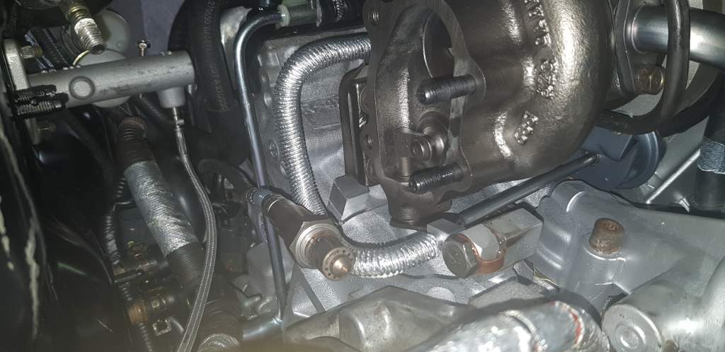

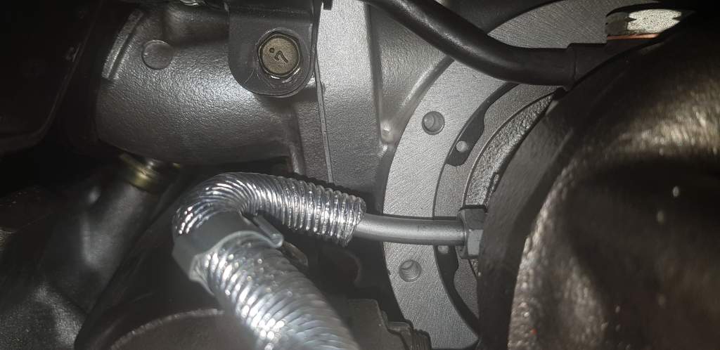

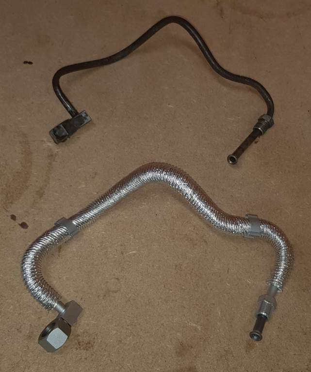

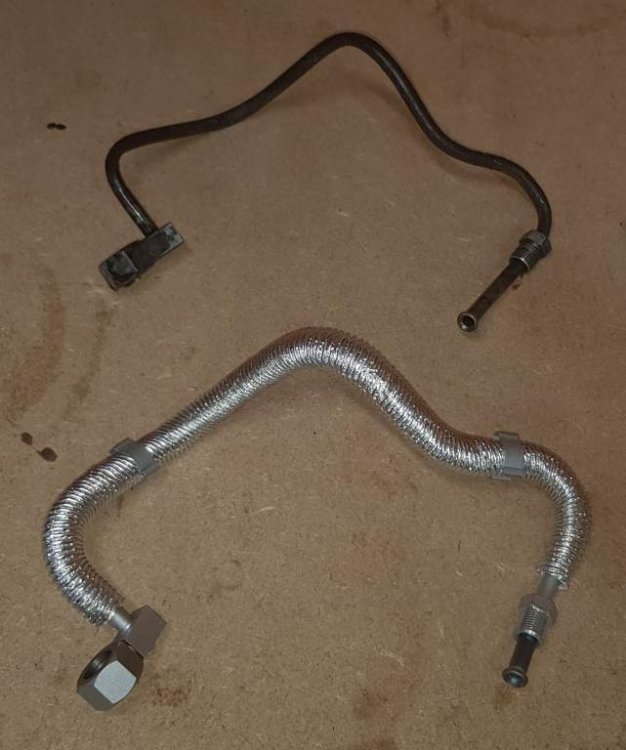

Out with the old, in with the new.

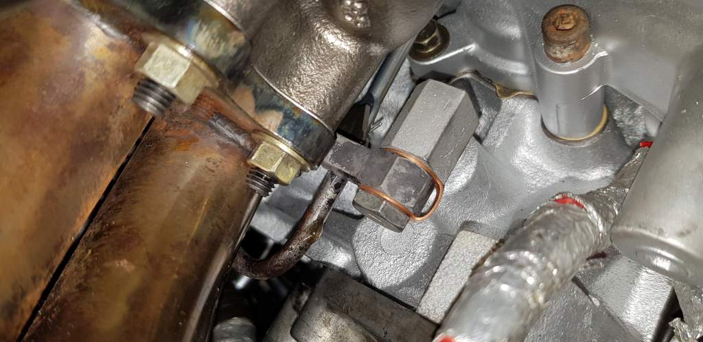

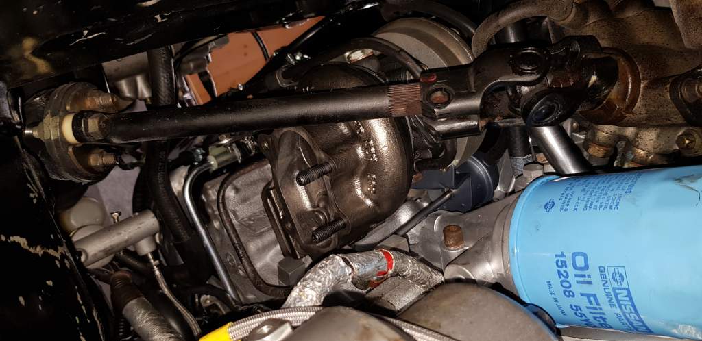

This is the turbo oil feed pipe which i've just replaced.
And it was another bitch of a job to do.
Not much room to maneuver any sort of spanner in the space so i eventually unbolted the steering rack.
Bottom bolt was easy enough but it was the top one that took the longest to get removed,
then the new part wouldn't catch the thread on the turbo and that took over an hour to get back on.
