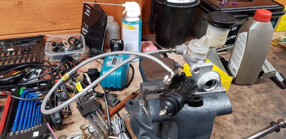

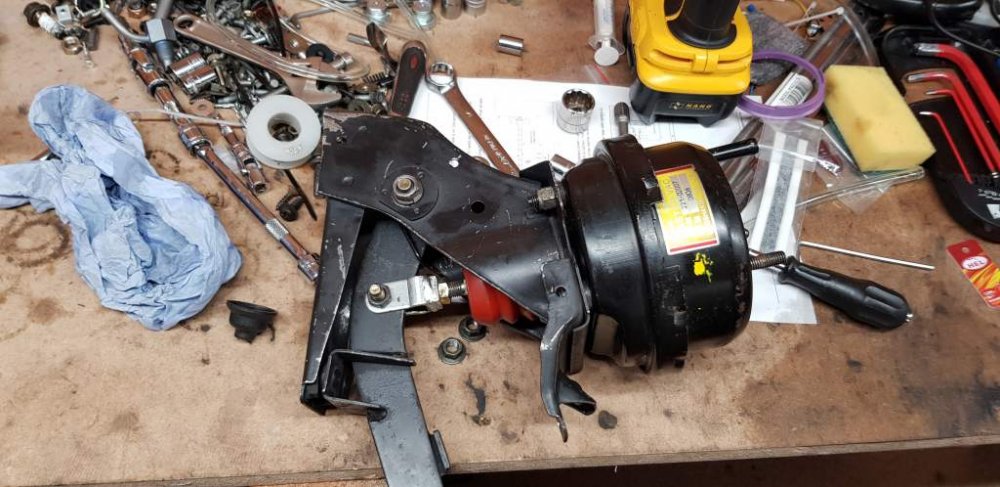

Clutch booster and pedal back out along with the master cylinder.
Fitted everything together externally and i've managed to bleed the valve when not connected to the booster or pedal.
Basically stuck the master cylinder in a vice and pumped it with a socket screwdriver end.
I'm going to assemble it all again external to the car and try it out now see if the piston moves.

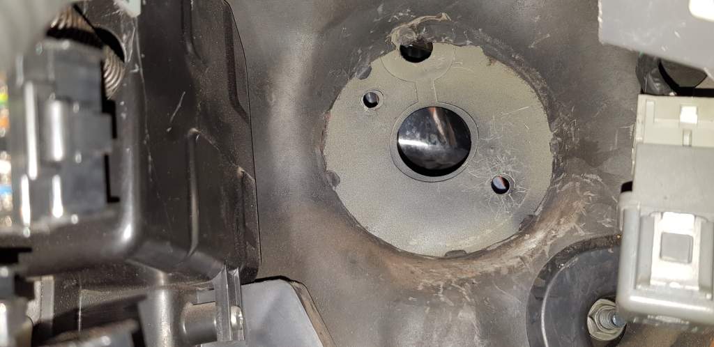

The problem is when i put it back in the car it stops working and i think i may have sussed it out.
This being an ex auto, we had to take off the faceplate covering the clutch area inside and out.
And i beleive looking at this the rubber membrane covering the bulkhead may be getting sandwich between the master and booster.
The extra gap is enough to stop the piston working,

As you can see on the picture the rubber parts would get sandwiched between the booster and master cylinder.
I just need to cut a larger circle of the rubber away to give more of a flush and flat seal.
