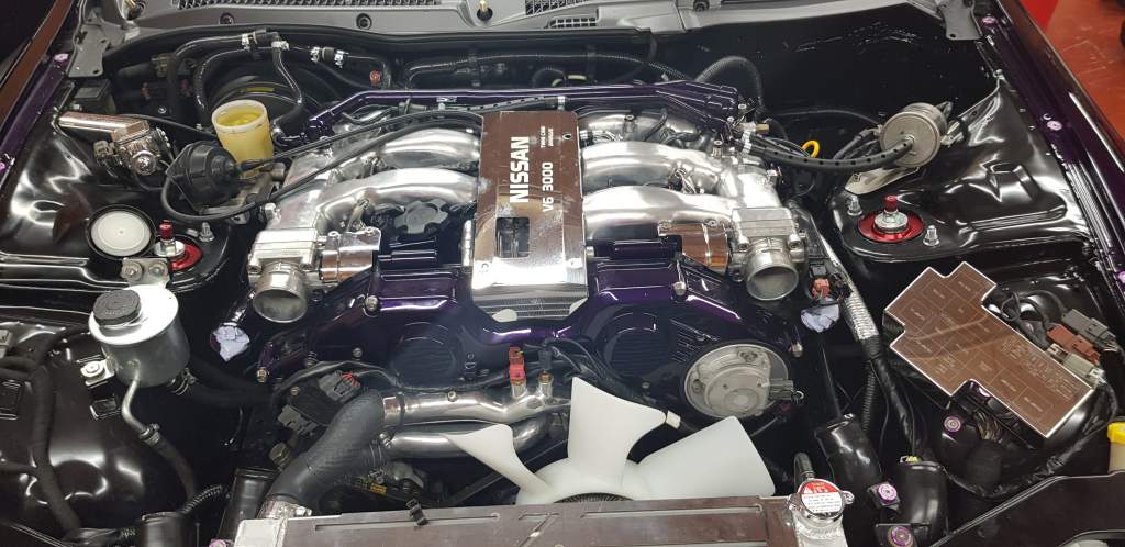

Managed to find the two copper washers and finally fitted the power steering hose.
£80 worth of various fluids and everything should be topped up shortly.
Was about to fill the radiator today too but luckily I noticed the drain plug was missing; anyone know where to buy a new one ?
Fitting the front intercooler pipes tomorrow then time to jack the zed up a few ft ready to fit the gearbox.
I have to say I love the satin black engine bay. :tt1:
I’m thinking of doing the same so it doesn’t look out of place if I change the body colour.

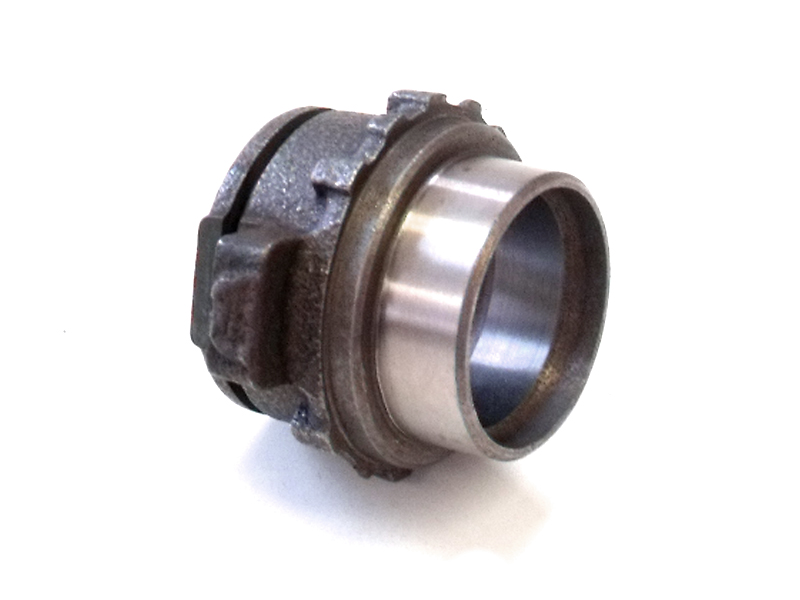

Planned on doing lots today but i'm guessing it was a day destined looking for lost parts.

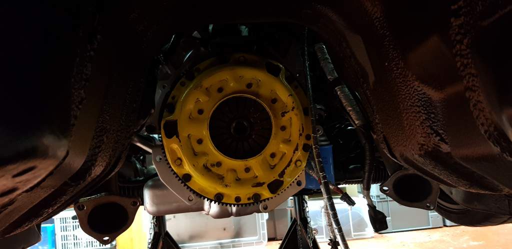

The plan was to get the car jacked up, new flywheel fitted, clutch fitted then prep the gearbox with its new parts.
But after fitting the clutch and moving to work on the gearbox I've realised that the throw-out bearing sleeve was missing.
Its likely still attached to the old clutch fork which was also missing.
Now I have to order a new one and the gearbox install will be delayed for a few days.

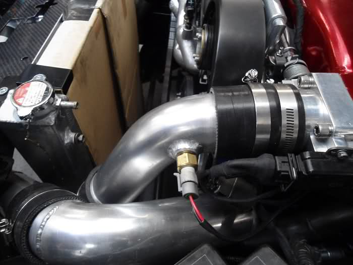

Also needing a new boss welded onto the intake pipe and i'm thinking the best and easiest place to put it is like the following :
[ATTACH=CONFIG]114819[/ATTACH]
If it helps? My sensor bung is positioned on that same pipe, but on the other side (I.e nearer the centre line of the engine)
Does the IAT sensor have any effect on the G4s’ control parameters or is it just for user monitoring? The only reason I ask is that I can imagine the temp rising as it passes through the hot plenum, can the IAT not be positioned directly on the plenum; maybe on one of the runners just before it feeds into the pot?
Wish you had asked Lee,I have a new fork,carrier and Bearing on the shelf.The IAT sensor Joel can not go on the plenum because of heat soak.
