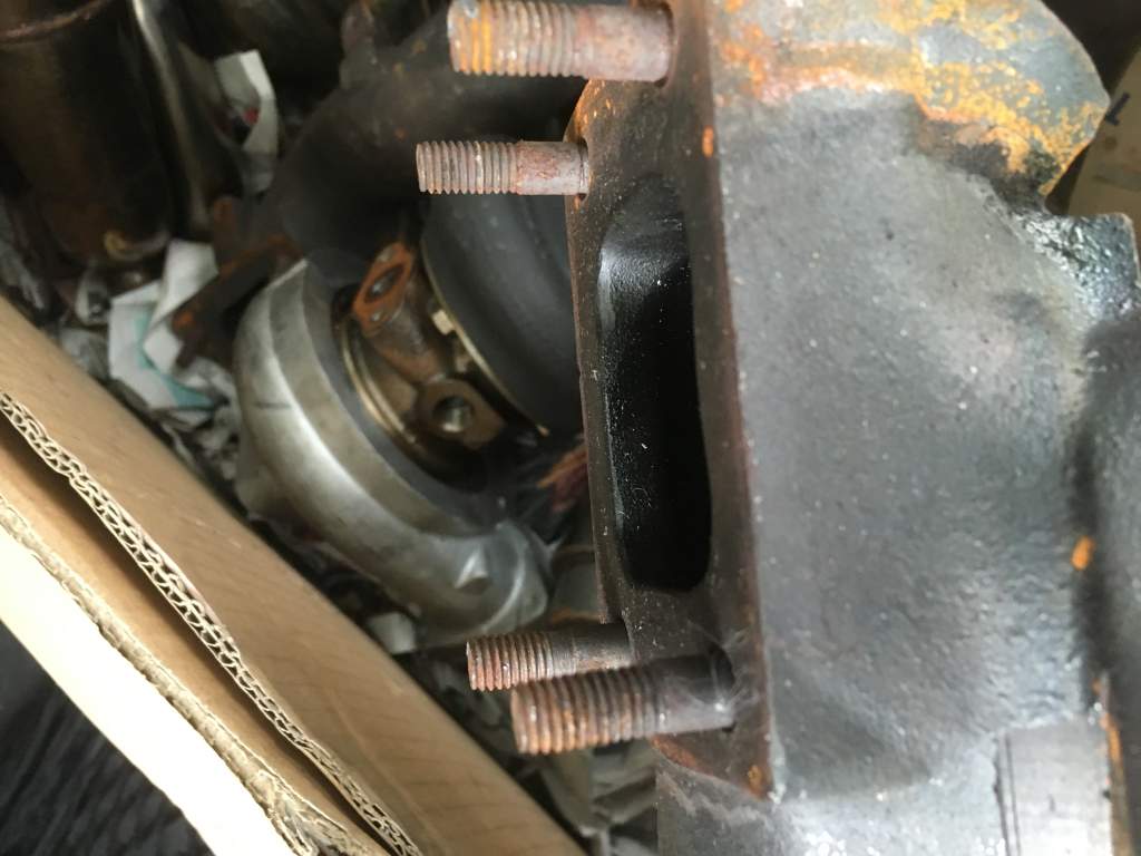

You mean these studs Ash
For the turbos to bolt to??

you'll need them too depending on turbo, but I mean the 12 manifold to head studs, if you look particularly at the nr manifold top rear youll see there only just a nut size gap, the oem stud is too long, the supplied ones are slightly shorter, there are a couple more that don't fit well with oem studs, but once I realised I changed the lot.

really? mine came with them, where did you get them from?
had a bag of manifold to head nuts,washers and studs, turbo to manifold studs nuts and washers, heat shield bolts and gaskets...
centre of the picture between elbows and manifold, long joined bag of bits, same packet as manifold to turbo gasket....
