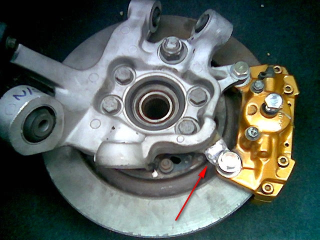

350Z REAR BREMBO calipers. Link needed please.
Can anyone point me in the direction of the pictures/explanation of where to cut and weld the mounting lugs.

Do you already have the 350 calipers Pete? Pretty sure that the R33 rears are virtually identical and require much less effort. Alternatively if you wish to go bigger then 370z discs coupled with Evo Brembo rears which require a bracket.
You may find it more fruitful searching for conversions to S14. A little search revealed a company called DB power give a few options, may be worth a chat.

Picture of AndyP's (now Craig's) rear Z33 setup:
[ATTACH=CONFIG]101360[/ATTACH]
Now THAT is what I was looking for. :thumbup:
You need a friendly and competent welder to do that, as they don't like taking the risk of messing with structural braking components.
