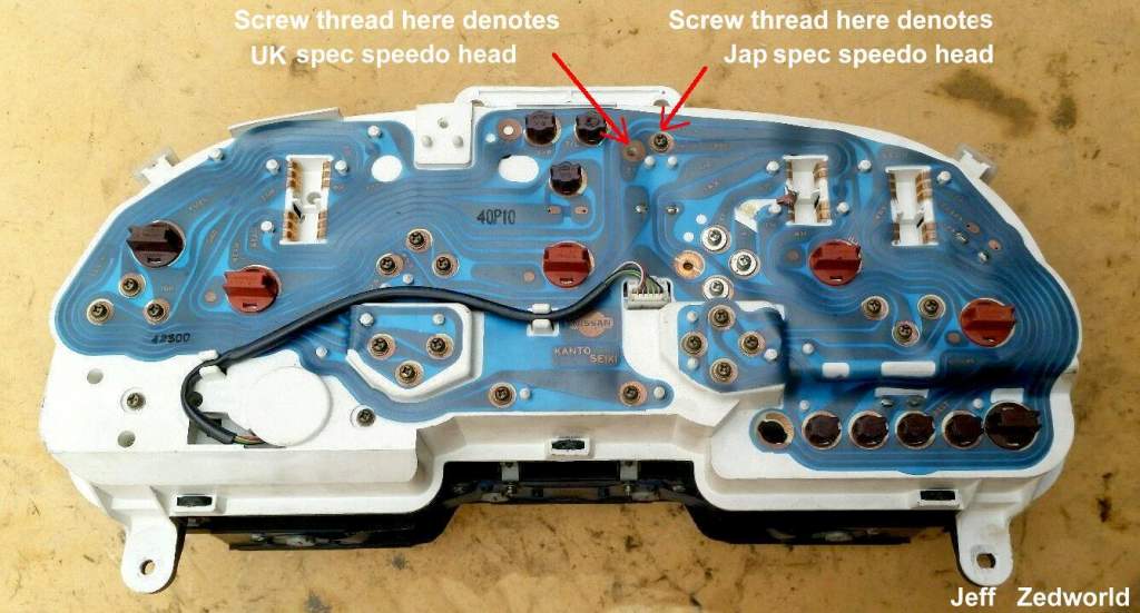

See picture to clarify what speedo head is fitted to the cluster you bought, and check the tech link of mine below to see if that is your problem.
Which ever one you have there is only thread in one position so it cannot be moved except by changing the head.
http://www.300zx.co.uk/forums/showthread.php?175083-Speedo-soldering-tech
See picture showing screw thread position on speedo head for a UK spec unit below.
Jeff
