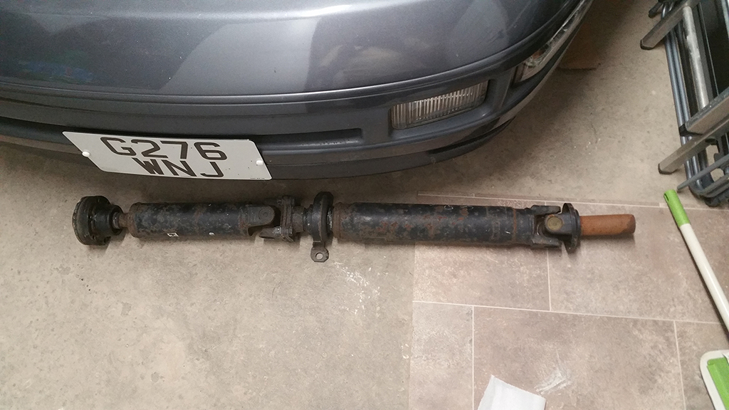

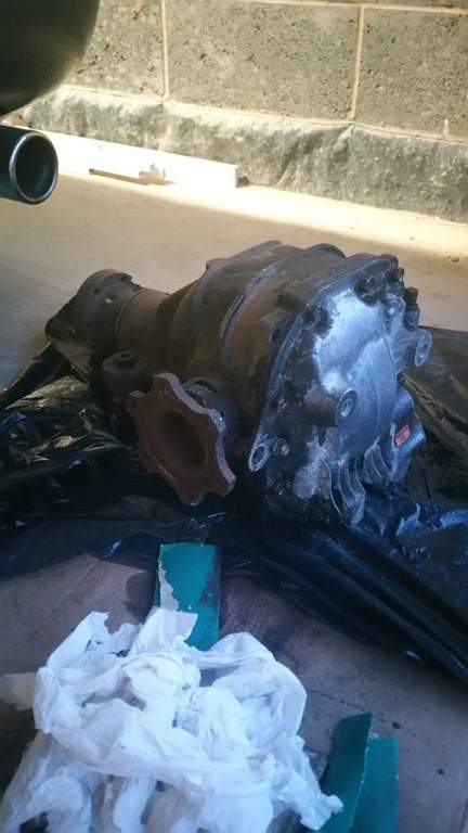

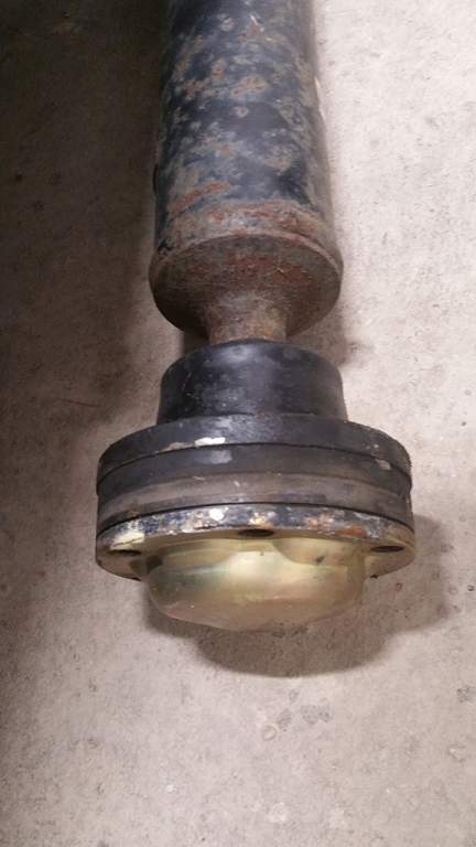

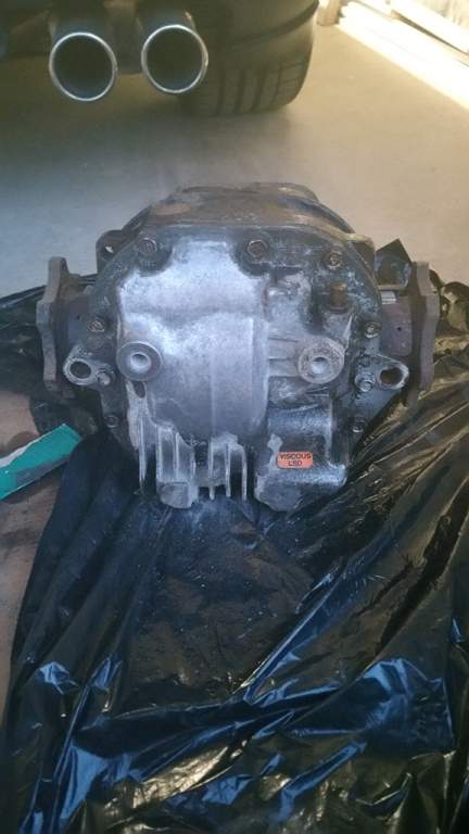

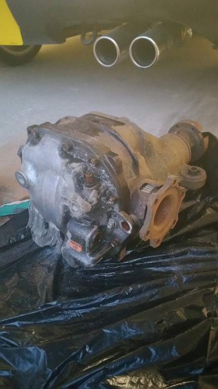

Just an update and query, I met Mondo today and acquired a diff and 2 piece prop, many thanks Si :thumbup: They are both in need of some attention and a bit of tarting up so I figured whilst they are out of the car to sand and paint them, replace any seals, bushes etc I don't expect to make a work of art or anything, but some guidance on what I should be doing and parts required would be helpful! Yet to find any guides on "refurbing a diff" without taking it to a specialist and spending hundreds! So far I just wire brushed, used WD40 and sanded down some of the casing and it comes up nice, I have sprayed WD40 on all bolts and the fill/drain plugs to loosen them up as I intend on taking a look inside and cleaning it out.
So apart from making them both look nice, what do I do next and although a silly question...... How do I know how much oil to put in the diff when I put it all back together? :confused:
How much oil is the same as any car, up to the level of the fill hole (so until it starts coming out), so just make sure the car is level when you fill it
Anyone got any suggestions for removing the fill/drain plugs? Covered in WD40, correct fitment for the plug into an extended bar, beating it with a hammer and it's just sat their laughing not moving.
Do you mean it's too tight or you can't grip it?
Too tight just use a longer breaker bar or impact wrench.

Think an impact wrench and a better way of securing it to get the most purchase, as it's out of the car it is somewhat tricky to stop it from moving around. I'll take it to a local garage tomorrow and see if I can get some help!

They are recessed plugs not hex bolts.

Only just saw this Pete, cheers for the offer, I went and bought some new tools today including a longer 1/2" breaker bar which did the trick on the plugs. Differential is now empty (ish), as you could have guessed managed to remove all but one case bolt which is stuck fast, going to get an adaptor for my breaker bar to get it off then clean the innards out, refill and clean up.

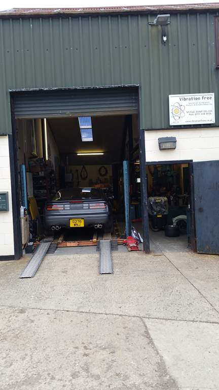

The car is fixed and I cannot recommend VibrationFree highly enough! Turns out it was the prop, my understanding is that most shops when they balance a prop can't spin up past 1500rpm, further they need to fit it to an adapter, all of which introduces discrepancies in the balancing process. They were able to check vibration from the front and rear of the prop independently, then counter weight the imbalance all whilst the car was in situe.
All ready to start:
Something a bit unnerving being 20ft in the air whilst revving the tits off your car.....
Either way, onwards and upwards, the car is fixed and once again, I would highly recommend them. Thanks to all for your assistance it has been appreciated.
