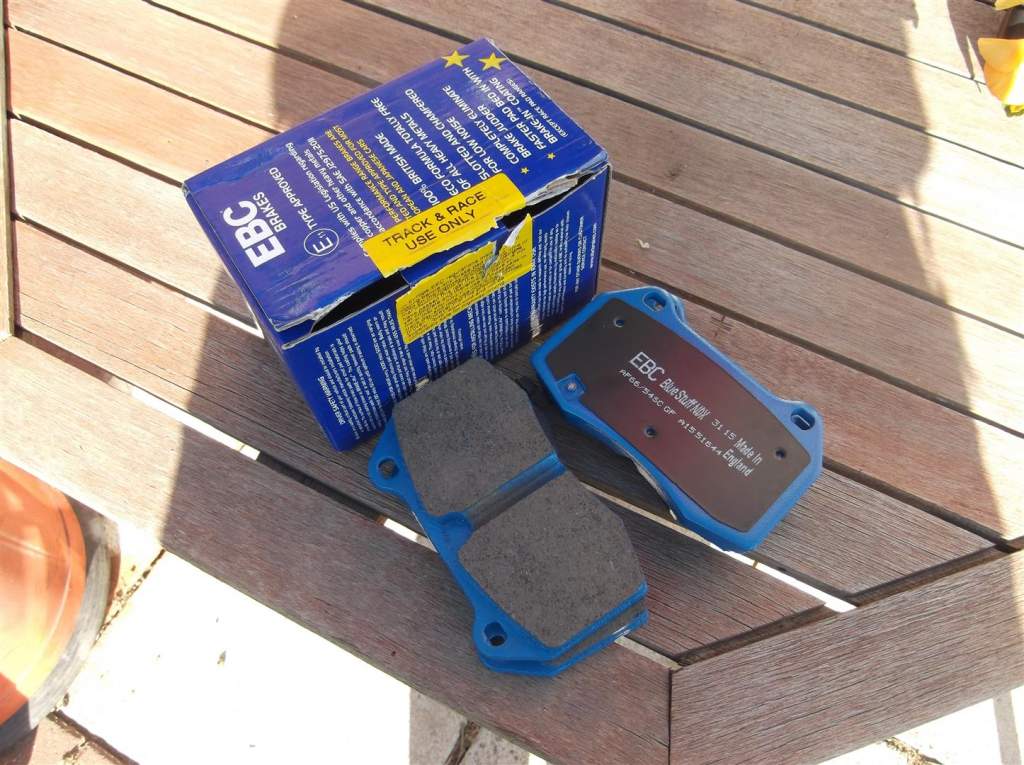

So this time round I have decided to select a budget track pad.... EBC Blue Stuff.
Im looking forward to seeing how these measure up under load.

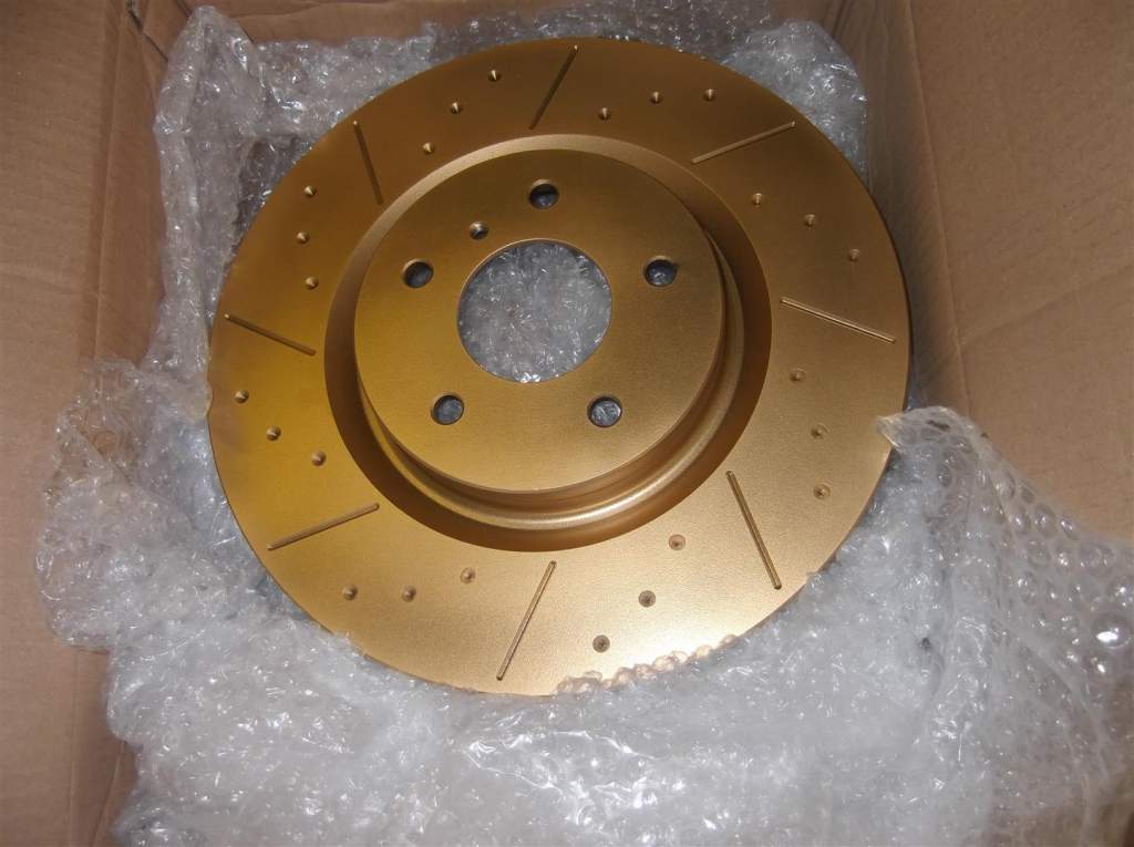

I also decided to get some new discs too although I dont really need them...:innocent:
I would be interested to see how you get on with them Pete, I have used EBC yellows and melted them in less than 2 track days, and so have steered clear since. Good luck!
Yellow stuff described as Medium. Blue stuff as hard according to EBC.
Both have 0 to 500 deg continuous use. Yellow stuff to 650 intermittent. Blue stuff up to 750deg C intermittent.
Probably good enough for OAPs on track:lol:
Only time will tell. They were only £102 delivered so if not up to it then I will return to Porterfields.
Yeah, at a fraction of the cost they're worth a try! I thought I was mad paying the 330 quid for front pads when I bought my pagid rs29, but they were worth the money and have paid for themselves in longevity
