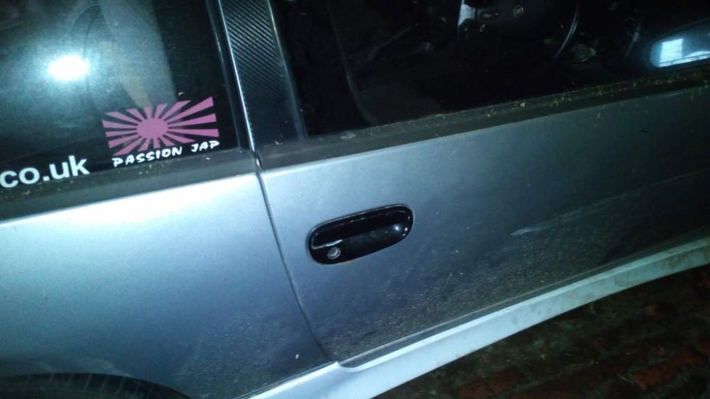

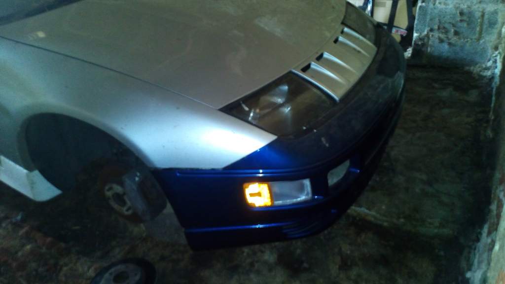

So I went to stockpile parts today since I ran out of room, and I couldn't resist fixing her back up a bit.
1: replacement for handle in
2: rear shock absorbers. These were a bitch to get in on my own, and to take the piss the last top stud sheared off so I will have to do it again...
3: wheel studs on as it only had 2 on the front wheels
(No pics :pinch:)
4: fibreglass nose panel modified to sit better, but it's still an awful fit so I'll probably get a stock nose to replace it with.
