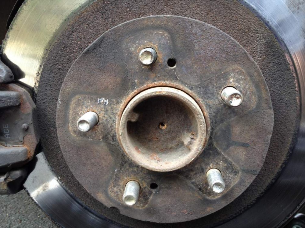

The only thing I did find although it’s doubtful it would cause any knocking, is the brake discs. Can someone confirm to me what if anything, should be in these thread holes?
Anytime I've removed a wheel, the is a countersunk hole in the disc to affix to the hub, usually just one.
Thanks
those holes are there to assist in removing the discs..you can screw long bolts in there and those will push the disc of the hub.
Most cars have these threaded holes in the brake discs in some form or another
Thanks for clearing that up!
