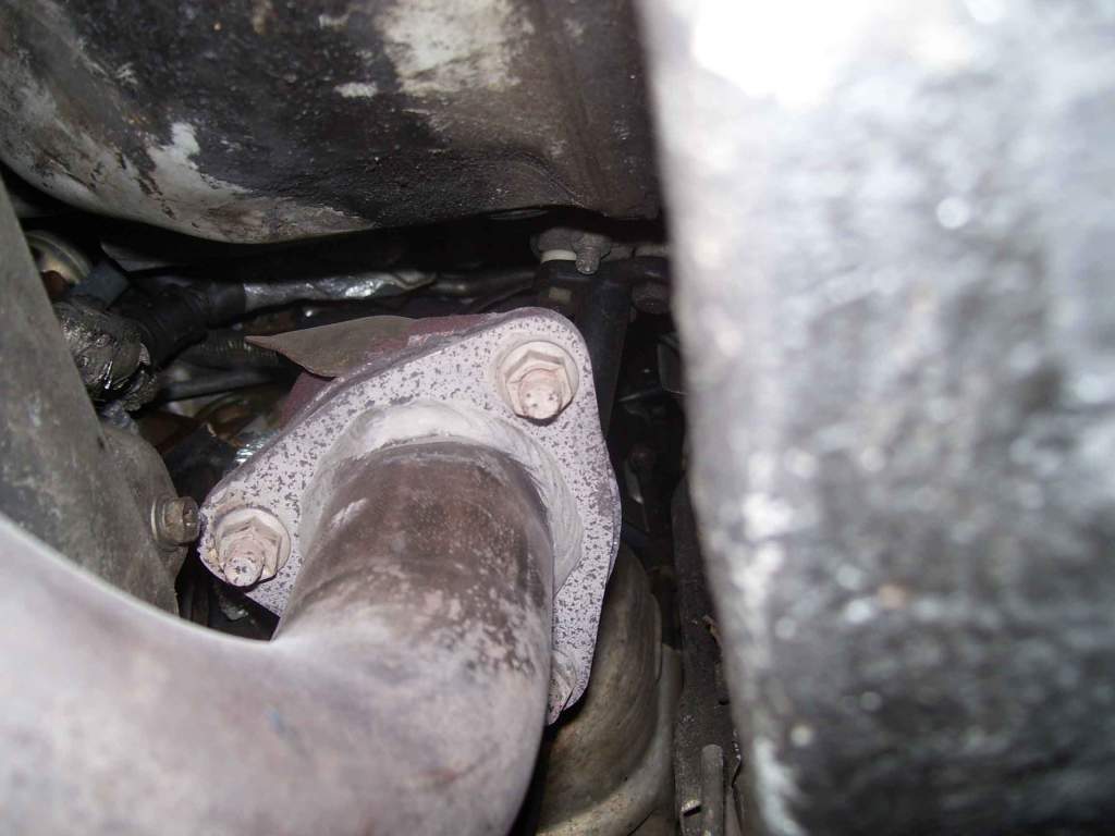

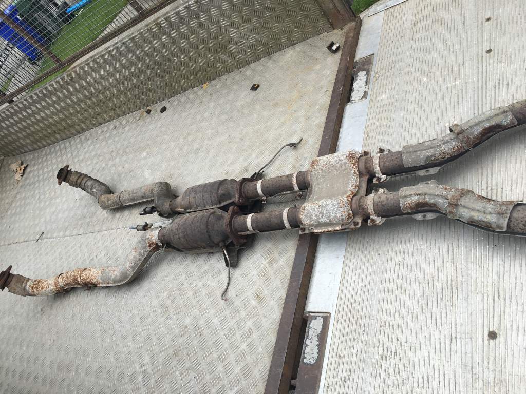

What is this? I have divorced elbows/downpipes and they where a direct replacement for my stock cast iron ones. 45degree angle. So I have divorced downpipes with the stock cat pipes. Which shouldn't mate up according to your sketch Stephen and those n/a downpipes there's a picture of wouldn't fit a turbo unless you cut them to reweld a flange at the correct angle.
Now there's a weird one! Yeah my elbows were 90'. When I got my decat/testpipes I was sat there looking at it and I would if needed an adapter of 45' (there's also a side angle too) they simply wouldn't fit. Maybe there's some variation between between markets, is yours a Euro spec spiff?
I think he has the lower picture Richie provided mated to the stock elbows. The upper picture is what I have as a complete assembly, you can't intermix those because of the 45' flange. This is why we need some pictures to establish exactly what's fitted.
Edited by Stephen
The lower pic is the same design as the standard exhaust section that bolted to the original elbows. You can see the 90* elbow/ bend on my OEM pic below.
But that shouldn't matter, I haven't seen any downpipes stating they only fit lhd or rhd, Japanese, euro or us. What matters is do you have a 4 or 5 bolt turbo, that's what everyone asks when you ask for advice on aftermarket downpipes
Agreed Steven, I am 99% certain that mine are as you say, the second picture.

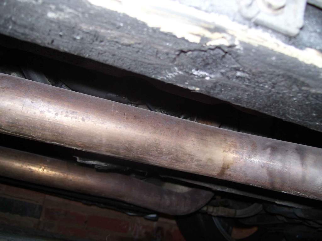

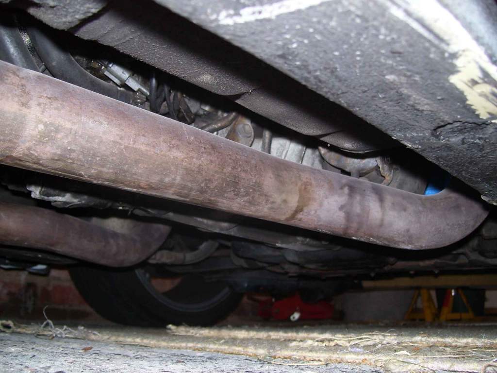

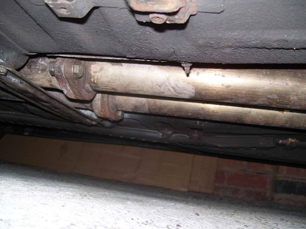

Richie,
There does seem to be a slight difference between the second picture of the test pipe you posted and mine.
My one doesn't have a bulged section at the joint to the rear section.
Please see photo 1.
At least we can confirm that they have the 90' flange though.

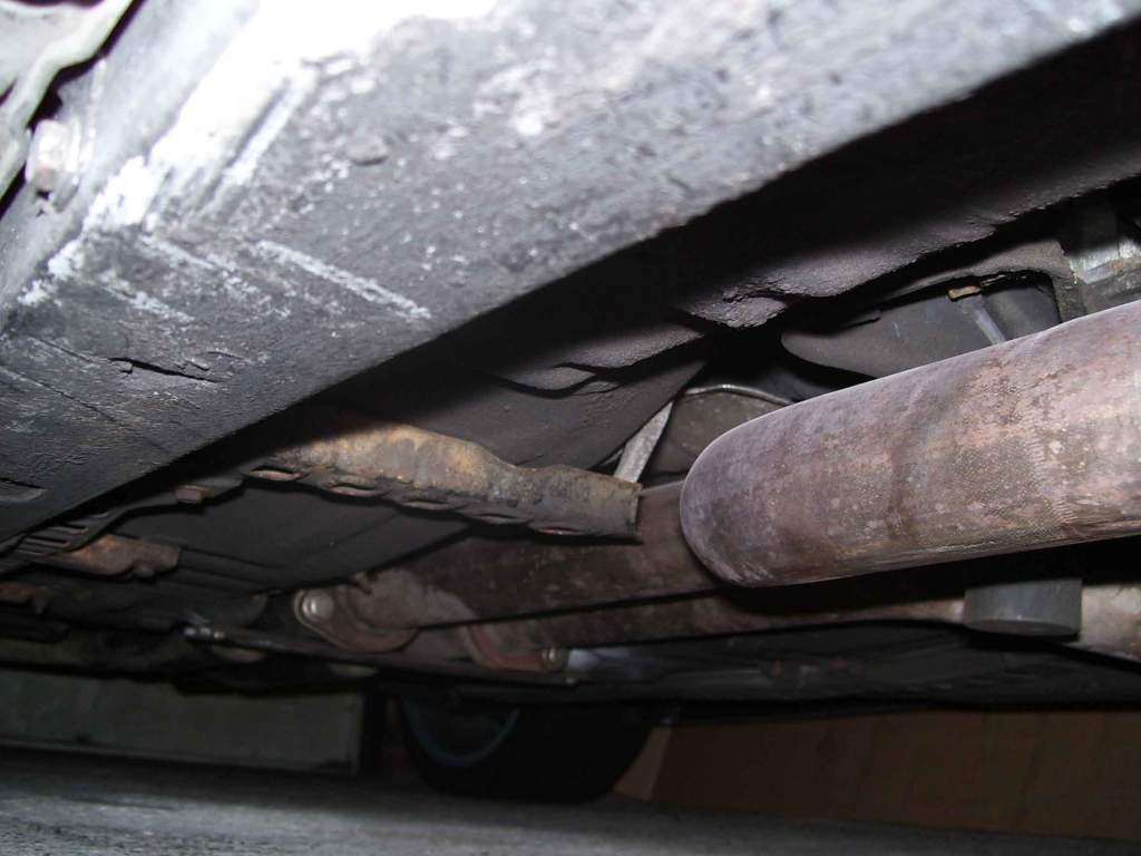

Hrm, I would expect euro and UK to be the same, ie as spiff posted. Kinda hard to tell from the pics. Does the flange run parallel to the floor?
From what I can see, they do appear to be parallel to the ground.
Richie,
Please see photo 1.
Yeah Dave, they're pretty much the same style with the exception of the bulged section / resonator. They still bolt up the same so you'll need to sell your ones and get the correct test pipes to match the divorced downpipes, hope this helps.

I'm not sure if they give a better sound as people all have differing tastes/ideas on what they see as a nice exhaust note. I'm personally getting a true straight through system from the turbos back, but again that's all that was available to me, should we get resonators?? Does it help prolong the life of the turbos?? Does it create back pressure or does it create turbulence with the exhaust gases? I don't know the answer to any of this, I'm sure some of our more qualified guys will be along to answer these questions. There's probably hundreds of these debates online which can be confusing as each one will be either pro or con and they'll have their arguments for each. I think it's up to the individual to decide themselves. So, after all that, I can't really give you an answer:innocent: All I can do is show you the difference between the NA decat and divorced downpipes with testpipes, so that you don't make the same mistake I did by thinking they're all interchangeable and will mate up to each other.:yes:
