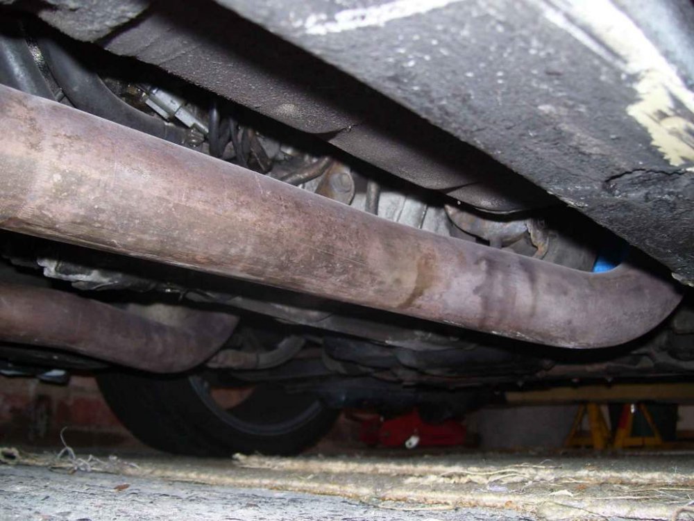

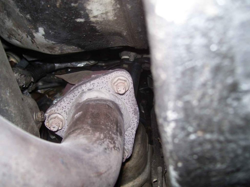

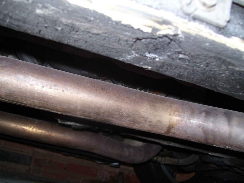

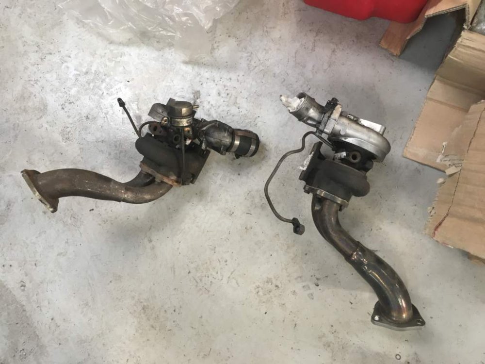

I wouldn't worry too much, they are both the same diameter, just a subtle couple of differences. Some people choose to fit the ones you may have to retain a bit more back pressure on the turbos and add extra quietness to the system. The best thing to do is take a few pictures and post them up and then we can can see exactly what you have.

Thanks again Steven, I will post some pictures.
As for the elbows, they are the original cast iron type with catalytic material inside. (apologies for my incorrect initial description.)

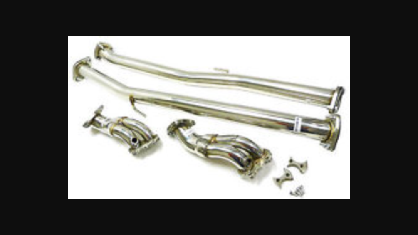

Club member no. 779:thumbup1:
Cheers Richie K.
That's the sort of thing I am looking for.
I need a 4 bolt configuration at the turbo and a 3 bolt at the pipe. (I believe)
Cheers Richie K.

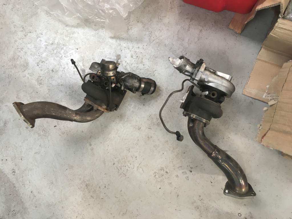

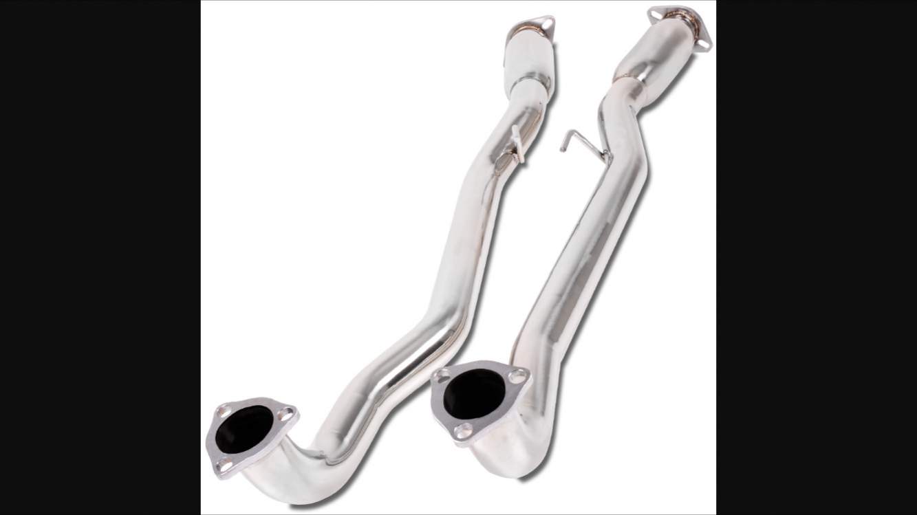

You'll need the centre section as well as I found that out at my expense already, these downpipes don't bolt up to the NA decats.
I will have these hopefully off the car in a few days time including the testpipes (decats/centre section)
Edited by Richie K

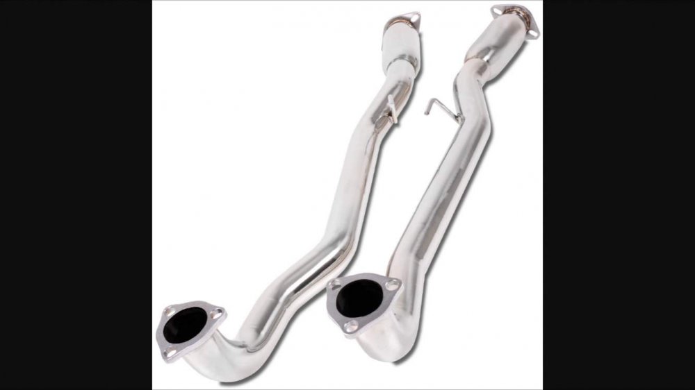

Would something like this be the matching setup to connect to my existing system?
Still trying to understand what fits with what.
http://www.ebay.co.uk/itm/Turbo-Down-Pipe-Test-Pipe-4-Bolts-300ZX-Z32-Fairlady-Twin-Turbo-90-96-/391346353365?hash=item5b1e0f74d5:g:x1sAAOxy63FS6BWH
That would replace from turbo to cat back. So yes it would suit however you'd be discarding your current down pipe/centre section. It's hard to explain the difference other than to say one has a 90' flange the other 45'. Il do you a little sketch if your still struggling. It caught me out when I brought mine some years back.
I can't profess that I understand at all really if I was honest, is the 90' flange at end of the stock down pipe and at 45' on non stock?
hence the mismatch?

So I need a 90' to 45' down pipe to mate up with a 45' test pipe?
Just need to be sure that it connects with the existing rear section okay.
I fear the worst somehow.
As per my pm's Dave,
TT divorced downpipes and testpipes
NA decats, these can fit a TT as long as you keep your standard downpipes
