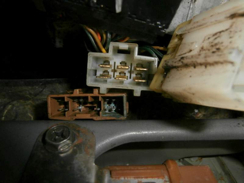

There are many good batteries out there and some rubbish ones but a major consideration is that parasitic current draw will KILL any battery if the car is not used on a regular basis. There are many known issues with the zed and like all older cars where corrosion in electrical connectors can actually be where the random current draw occur`s in the main any connectors in close proximity to the targa drains and other electrical connection behind the passenger front wheel arch for the head lights.

Some of the typical connector issues caused by targa drains here >
http://www.300zx.co.uk/forums/showthread.php?175920-Pesky-targa-drains-and-electrical-issues&highlight=targa+drains

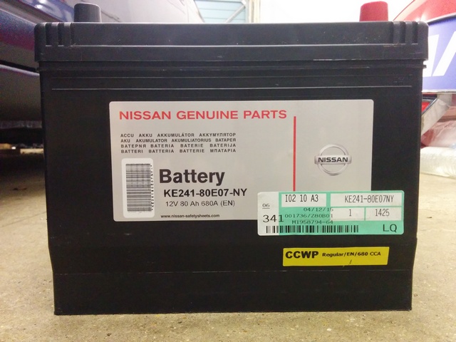

I like Nissan ones too, not prejudice as I work for them, but after 2 months of sitting at our bodyshop my zed fired up without help.
