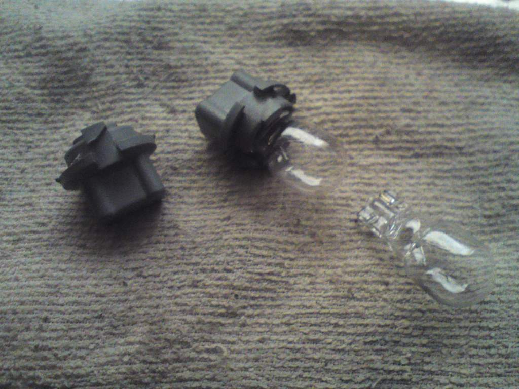

Bulb aperture is 13.5mm and the bulb diameter is around 13.2mm, they are the specialty bulb as sold by Nissan @ £5 a pop. I don't often say things are too expensive for these cars, but £5 for a shitty incandescent bulb is nonsense.
The correct bulb is the one Andrew posted, it's a 912 bulb and seemingly very little else uses this which is why it's so expensive.

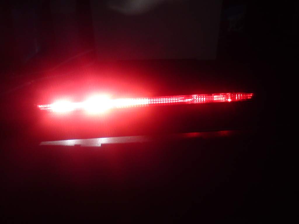

I've had red smd bulbs in my 3rd brake light for quite a while now, always believing they were redder and that is fact, backed up with a quick bench test i did today.

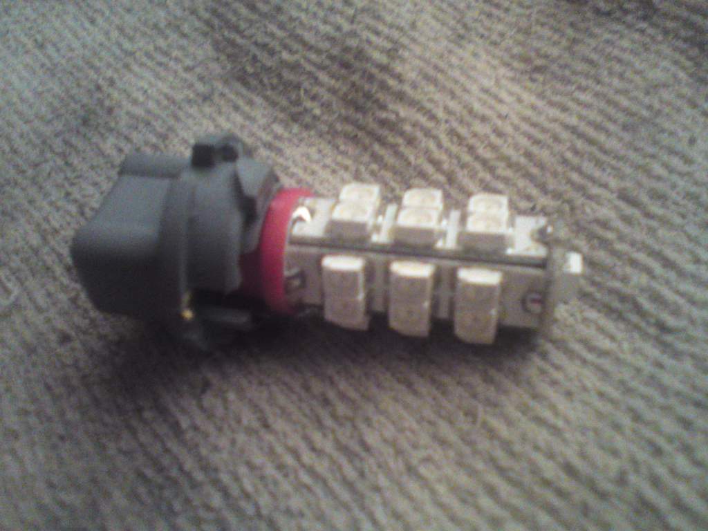

Here is a pic of the said quite long smd bulbs i have in use....
The incandescent 13w ones, the maker of the ones i own are Stanley - like all filament bulbs these do get incredibly hot very quickly, the smd ones barely get warm.

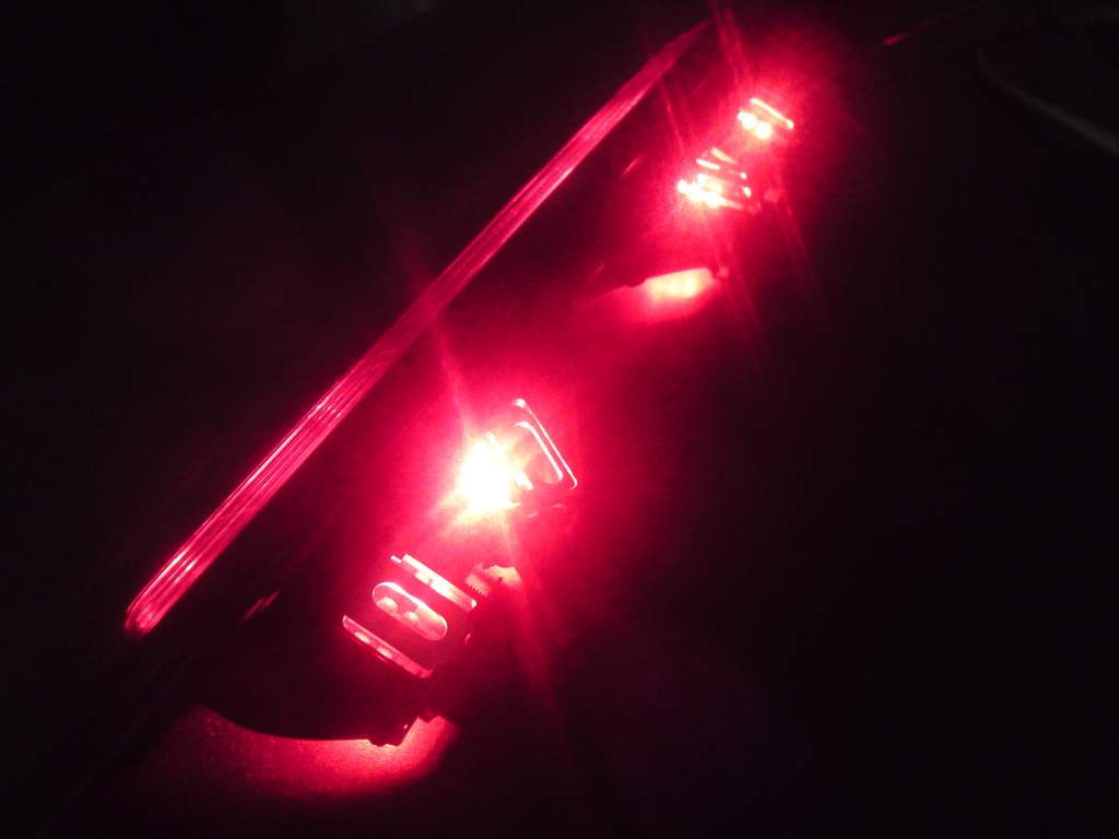

Here are all the red smd bulbs fitted, the spread of light is actually quite good, down to the fact perhaps they are 360 degree and have some length about them....

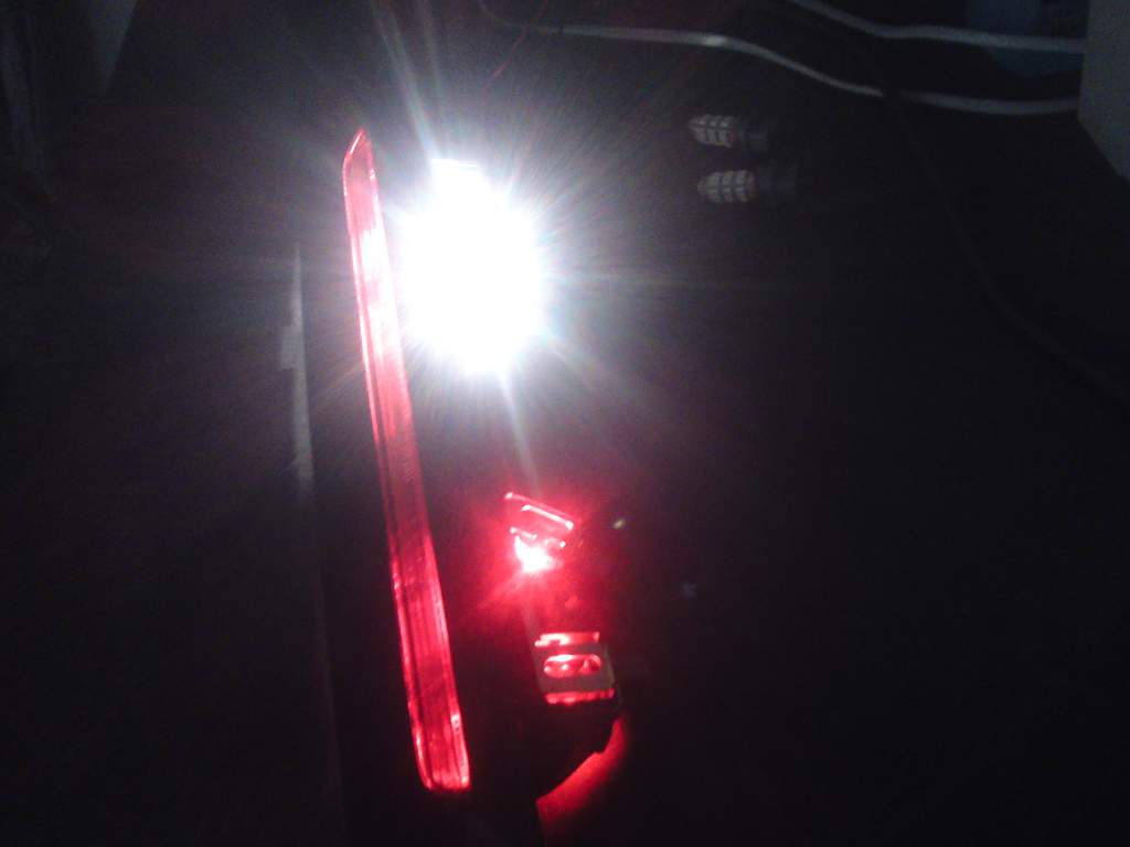

Top two positions have now got the clear factory bulbs fitted, brightness does not compare....
And from the front, side by side there is a colour difference through the red outer diffuser but otherwise you'd not notice the difference and you'd think the colour was red when you brake but really it's a tad on the orange side.

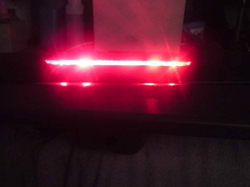

I am happy with the ones i have in my 3rd brake light and i will not go chasing anymore, led can work but i do know where Si is coming from, the pic below is with the 4 x red smd's, picture does not do it justice really, these are a lovely red :yes:.
