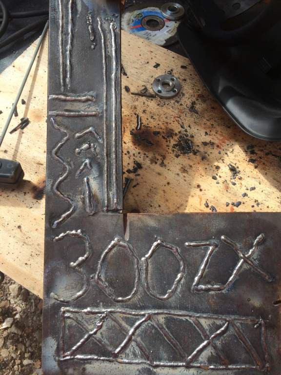

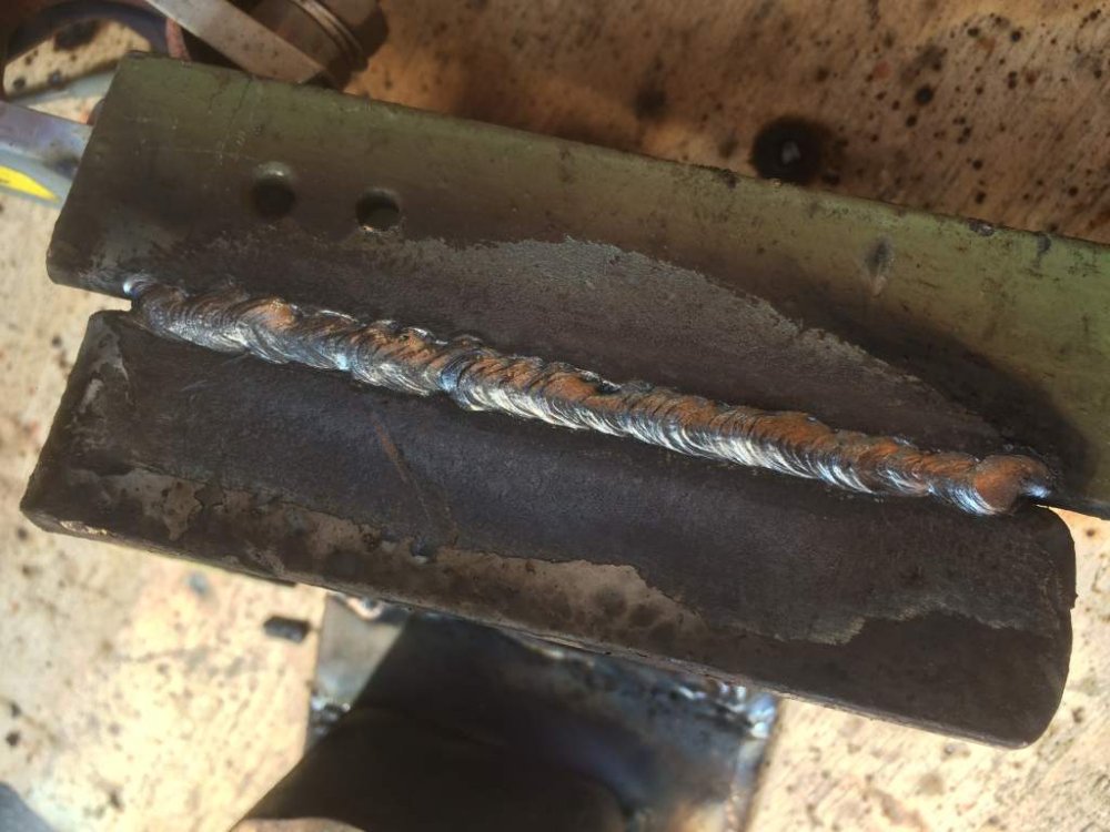

i started mig welding last year for the first time but only just started arc/stick welding a few days ago so been practicing on scraps on metal any welding heads out here ( bri ) can have a look as see what you think good or bad and any pointer on arc welding here are a few pics so car
What you can tell from that is pretty limited. Your best of making some test pieces, butt welds etc then observing the opposing side and cutting it in half to see how the weld penetrated. What made you decide to learn stick?

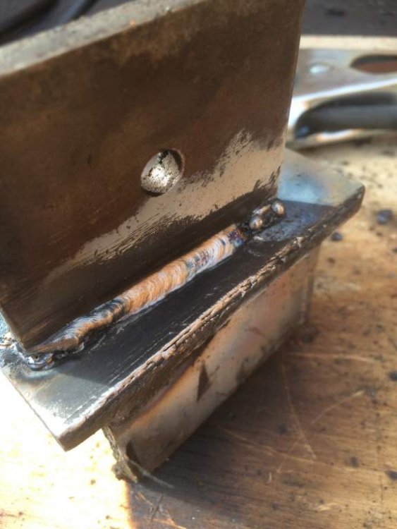

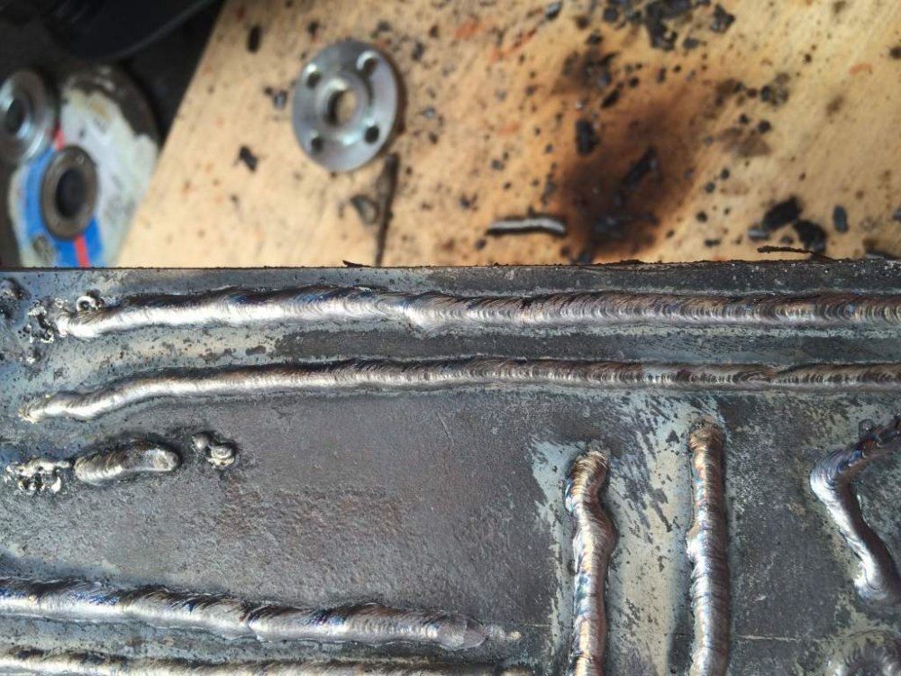

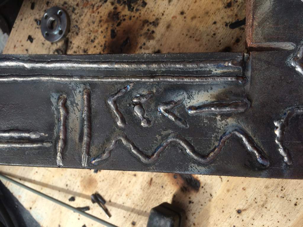

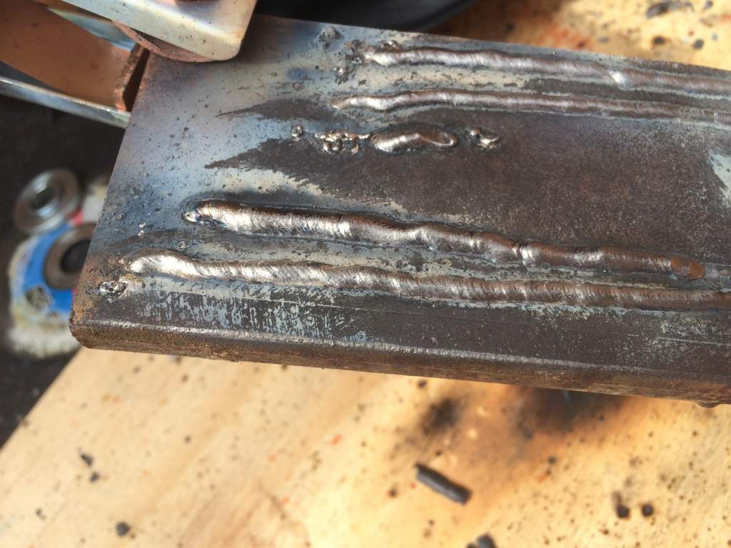

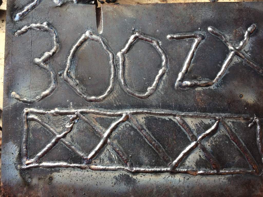

so moved on to joining metal stick welding it much harder than the mig but will keep practicing here are some joints form today
metal must be spotless Dan and steel that thick you need to turn the amps up a tad...looking a bit cold and not much penetration going on. Good flow though for a raw novice matey, what rods you using?? not the size which i persume are 2.5 but the coding at the end of box.
E6013 bri been running 60 to 80 amps
