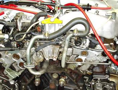

So, I have a leaking heater matrix, and short-term (until I can get up to Jimmer @ Powerzed) need to block it off. I have seen many threads on bypassing the heater matrix with a short length of hose 5/8" in dia.

So where is the best place to get this dia of hose and how long does it need to be?

Have you tried a motor factors? You will need enough to be able to do this without kinking the pipe, link below suggests 18"

I got mine from Halfrauds when i did mine years ago, a longer length helped with creating a smooth bend as the Halfords pipe isnt as reinforced and therefore a shorter length would kink.
