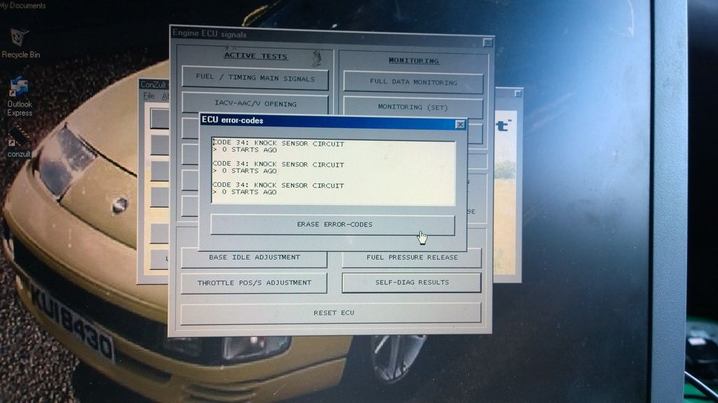

I have consult and just read the codes. Sure enough 34. So I have erased that and I'll see if it's cured tomorrow or not. Hopefully it's only holding back because I've had it all disconnected recently.

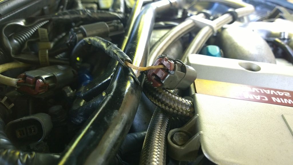

Went to bypass the plug sensor today and found this broken wire. Same on the plug but tucked away. I know it says on other forums that this is on purpose. But it looks like a bodge to me. So I reconnected it. And the plug side was the same. So I connected that aswell. Still boosting at max 7. Stuck now

Consult on a cold engine. Code 34 kept recurring so it still is an issue.
Timing looked well off to me but did decrease to 25btdc as it warmed up
That won't show your actual timing, just what it's supposed to be. You have to check with a timing light.
