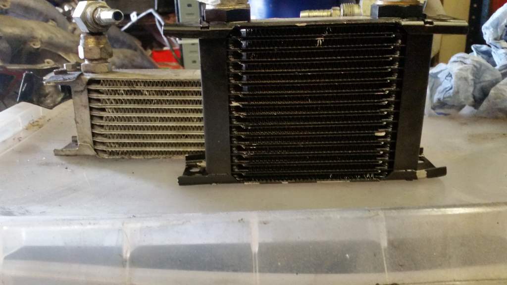

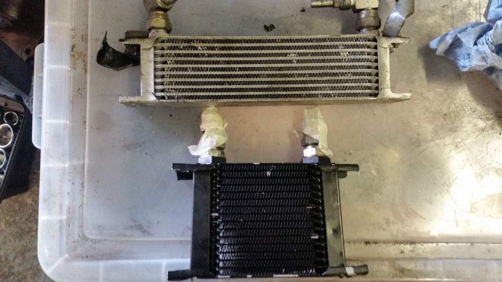

Hi all I have a dilemma I have a choice of two oil coolers to put on my z.
One is a setrab 16 row the other is a mocal 10 row
The setrab is a lot narrower but taller then the mocal ...please see pics.... which one will be more efficient?

Which one has the largest surface area? The larger surface area it has the more potential it has for thermal exchange.
yep this is how i see it too

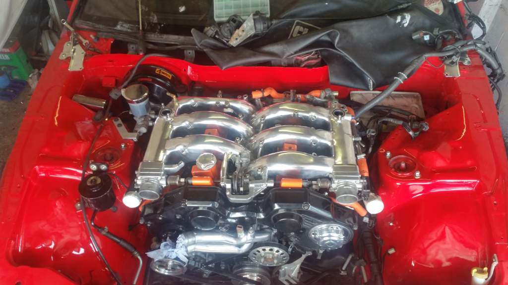

One was on my z. The other was bought from a member as a full kit z1 full flow oil cooler. They have both been flushed out thoroughly.
It's compulsory being a rebuilt engine :)
Everything is cleaned !
That's an understatement. I think I would happily eat off most of your car now :lol:
Thanks Steven very appreciated buddy. It is a labour of love not to everybody's taste but tbh I don't give a shit hahaha
Clean enough for a BBQ on it eh?
Pretty clean not to most peoples standards but it is to my limited budget
Blimey Gaz - that looks great! You've clearly moved on since the last time I was here! :bow:
CheerZ
Steve :)
'93 UK TT Manual
Hey Steve it's been a while :) . . Hope your keeping well? Yes I have progressed a bit. The club knowledge helps a lot . Very helpful people :)
Cheers dave :) she is getting there slowly.
Still need help with the cooler situation tho hahaha. I'm tempted to go with the mocal. It just looks bigger. It might be a placebo ...
There are only three variables gaz. Surface area, thermal effectively per unit area(think about the fins) and contact time as you cannot standardise the coolant (air) at a stable temp. Ideally you want a large surface area and long contact time(within reason). This would ensure that the oil would be exposed to the coolant property for the maximum effect.
I don't think logically either of those will have very much difference in flow rate. So to that end it's all down to surface area. They appear the same thickness and the fins appear the same density. So if the mocal has the larger "face" logically it's going to be the more efficient cooler.
In reality I doubt between these two you will notice measurable differences. Iirc your using a thermostatic sand which plate for this full flow design so the reality is that you will be far more efficient than the stock pressure based system which not only, only runs when your at 45psi or more of oil, so driving, but also restricts the oil pathway to an 18th of an inch meaning flow rate is exceptionally slow.

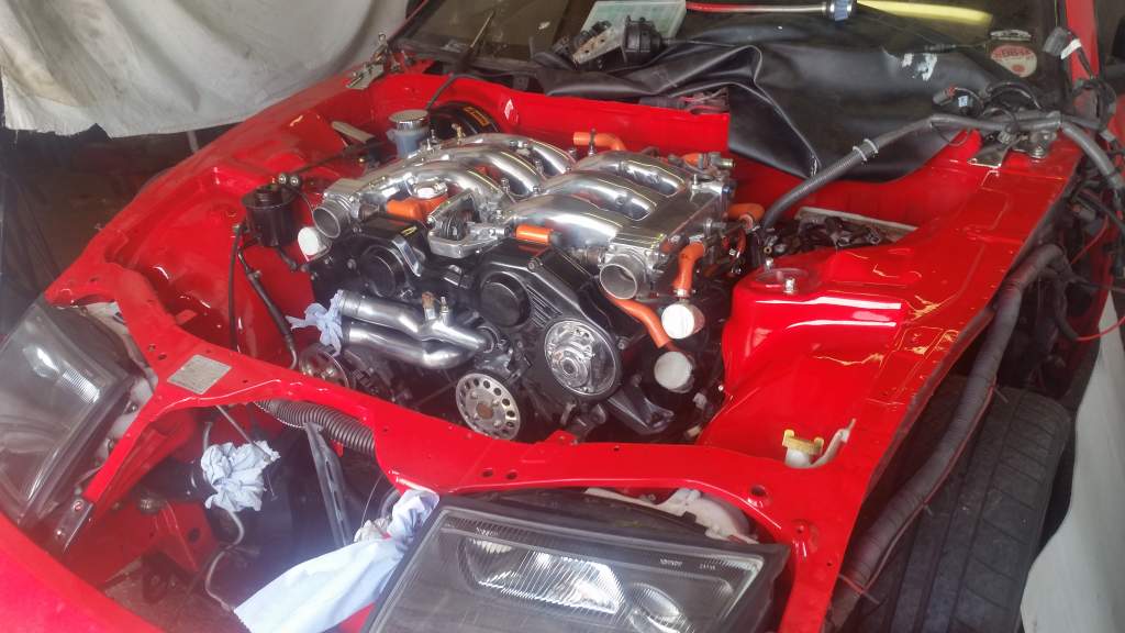

Lovely engine bay paint job! Are you keeping the rising sun?

What about core thickness?
That would come into efficentcy per unit area. Lazyness on my part there. Plus they appear to be the same thickness. Lazy.
Il nip round there and get him out of bed, get my ol' measuring stick out and create a closed loop out of it and test the time taken to reduce tempreture on both. And the tempreture gradient across them both. Probably a bit much. :lol:

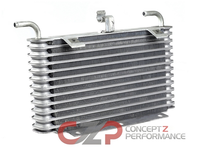

BTW - this is the Euro/UK spec oil cooler for comparison:
If I may have any input, the black one looks twice as high, but also half as wide so the difference would be in the thickness, and I think the black one is slightly thicker. Probably best to actually measure them but they should be near enough the same IMO, and also the black looks alot neater :wink:
[ATTACH=CONFIG]96851[/ATTACH]
Yes the rising sun is staying. It attracts attention from a distance at shows. The engine bay was painted by myself. I'm very happy with the result thanks
