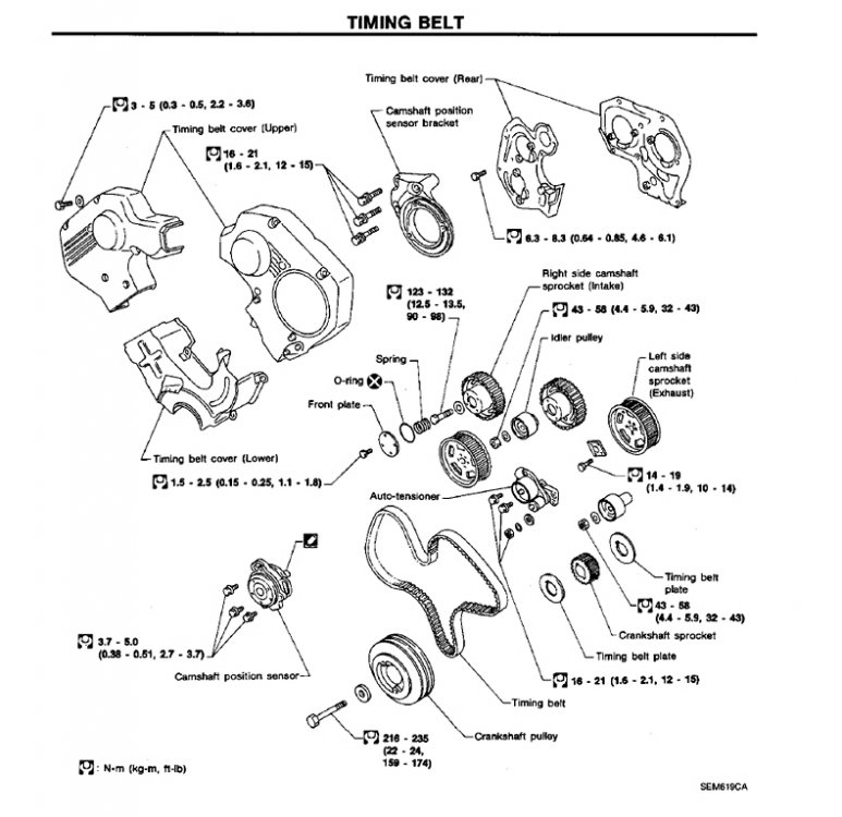

Can anyone tell me the ID, OD and thickness of the timing belt washers and how many are needed?
Cheers Andrew, can't get your link to open but I'd read 15 on a couple of other sites so wanted a second opinion :thumbup:
