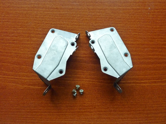

Finally, as well as removing the head unit, one of the previous owners has also removed the brackets used to attach the head unit to the dash. I’ve ordered a set of brackets on eBay, however as they were not pictured, it’s unlikely they’ll include the screws. Does anyone know what size screws/bolts I’ll need to attach the head unit to the brackets, and then the brackets to the car?

Yes, metal brackets with oval speaker holes.
Going by what I've read they're 4 X 6 speakers.
Yes they are (were) stock 6x4s. You will have had a OEM rear amp which powered the rear speakers. The OEM head unit
in this setup unit had built in front channel amps and line level outputs to the rear amp. I've attached the wiring diagram
for you so you can see what is going on and trace the wires. Your radio brackets should look like this:
If you don't get the little screws in the photo with your eBay brackets then I have a set of four you can have which fit the
radio and cassette unit/cubby hole to the brackets. The brackets are fitted to the car with standard self tapping 4mm screws
into the captive nuts which should still be in the dash.

I contacted the seller and they claim that the brackets include the 4 screws needed to attach the stereo. I should have some 4mm screws in the pack i just ordered :biggrin:
