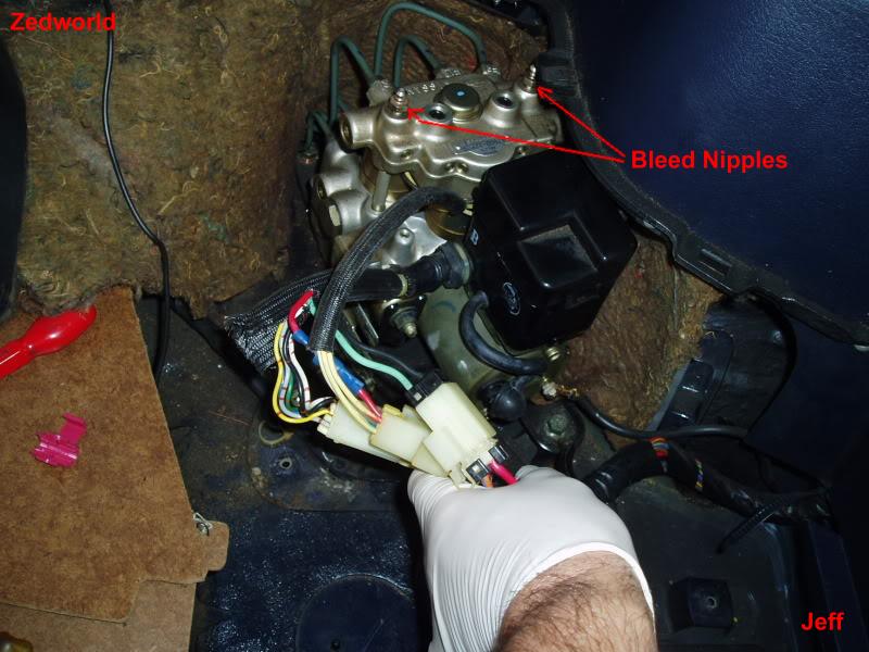

Good advice. Had a similar issue with a cortina years ago so Zed has been gunked and blasted. Where's the bleed screw for the ABS?
There are two bleed screws on top of the unit, does not matter which you do first.
See pic below.
