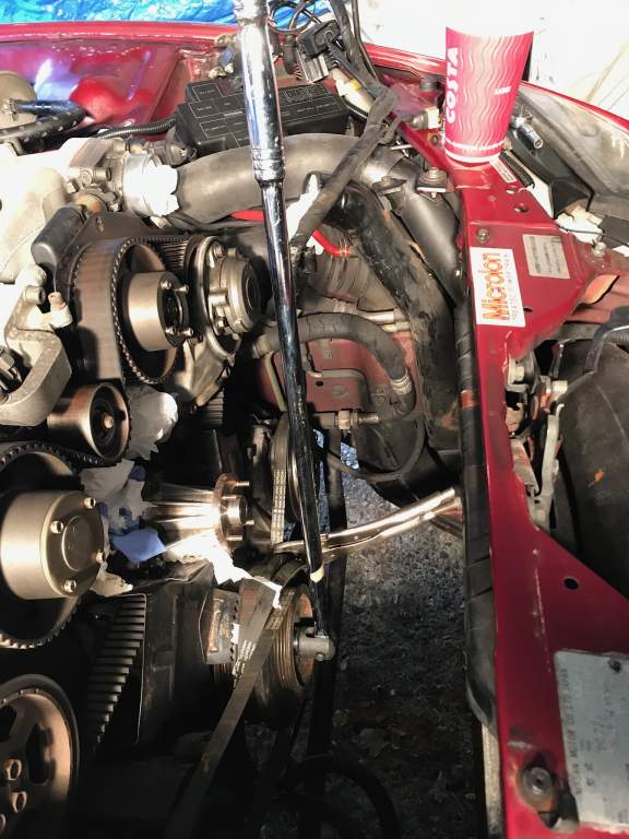

Hi guys I used this method to release the crank pulley bolt so I didn’t have to remove my starter motor. Worked great. Now I’ve done the timing belt I want to tighten the pulley bolt back up to the correct torque but my brain has stopped working and I can’t figure out how to do it. If it was a manual I’d put it in gear to stop the engine moving but it’s an auto so the only thing I can think to do is take the starter motor off and jam a gear. Any thoughts so I can carry on being lazy?
There are many different methods, I clamp the old air con belt with some large grips, you can look up the belt locking method on the net.

Thanks, I used some spring compressors on the old air con and power steer belts and it worked a treat :)
