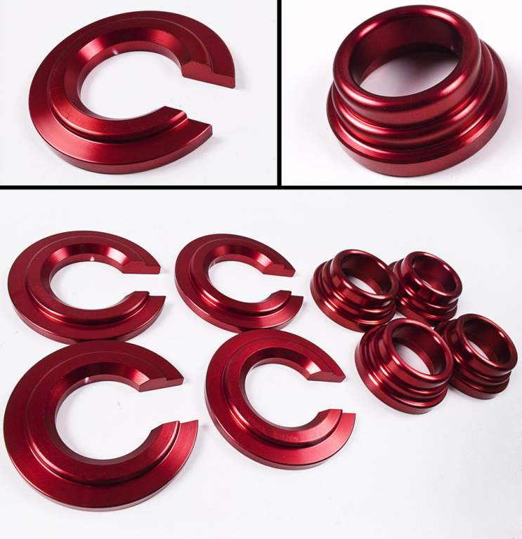

Unless your really wanting new bushes then locking collars are the way to go,simple to fit and way cheaper.Its very rare for vehicles to have bushes where the subframe meets the body,i can only guess Nissan were looking for comfort when they designed it that way.Youll not even notice the difference if im honest when the collars are fitted apart from the loose feel at the rear will be gone.

Agree with Jimmer nice and easy, do them in your lunch time, will keep the driveability as stock but with less movement from worn bushes, and MOT compliant, e-bay has many listed but have used these ones many times and only £35 free delivery or collect from your nearest argos.

http://www.ebay.co.uk/itm/NISSAN-200SX-300ZX-SKYLINE-RED-ANODIZED-REAR-SUBFRAME-C-COLLAR-BUSH-REPAIR-KIT-/230860986909?hash=item35c0631a1d:m:mSjZ30UBFLol4RhrE89ayEQ
[ATTACH=CONFIG]95845[/ATTACH]
If you say "with less movement", does this mean that the rubber bushings still do their job but become harder because they are pressed together by the collars? Or do the collars make it a "solid-mount" subframe?
Mike
Mike
What happens is the bushes that previously had voids in them full of a silicon type fluid ( now escaped ) now become compressed so the voids close up, but the collars are so designed they do not contact the subframe and body at the same time, that way the bush stays compliant and hence so no extra noise transmitted but a tighter control of the subframe location.
