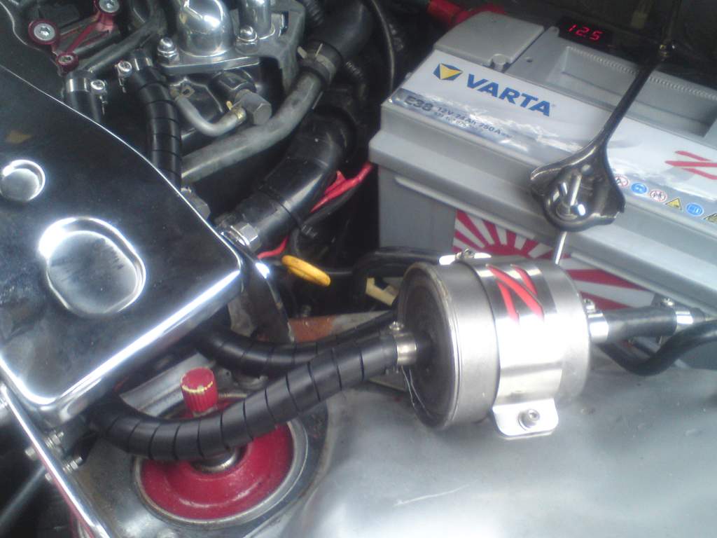

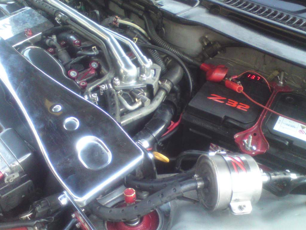

I fit my pipe today and some things i want to log.
All the 3 sheaths are not all the same size :thumbdown: don't ask me which is which, all i do know is i took the larger of what i had as a sample when i bought my pipe and of course tested and it slid in lovely.
Come to slide my new pipe into the bendy sheaths - absolutely no chance !!!
I measured my new pipe and i have bought quality and with it piece of mind.......it's 8mm id but the od is actually 15mm, so nice thick walls better than oem 14mm.
Call me what you like, i did still want the outer sheath on although i was careful when cutting to length, etc, not to have chaffing points, the only way was to slice and hide this 'cut' on the underside :sneaky2:.
Some of the eagle eyed out there might notice i put a piece of sheath on that filter inlet pipe, just love making work for myself, all that leaves me now is to furnish this post with a picture :cool:.

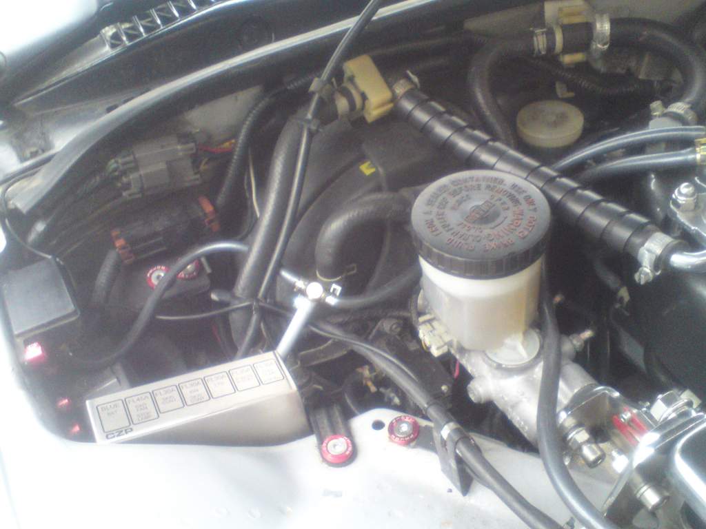

I wasn't totally taken with the recently acquired (mine as never had this fitted) oe fuel sheath, not sure the years have been too kind as it was brittle.
The catalyst for me was this pipe right up against and rubbing on the brake fluid cap, causing visible abrasion.....another 100,000 mile and it would of been through :whistling:.
So as you can see i came across some cable tidy wrap and thought i'd give it a go and do you know it does it's job.
And on the fuel hoses - i quite like it :cool:.
