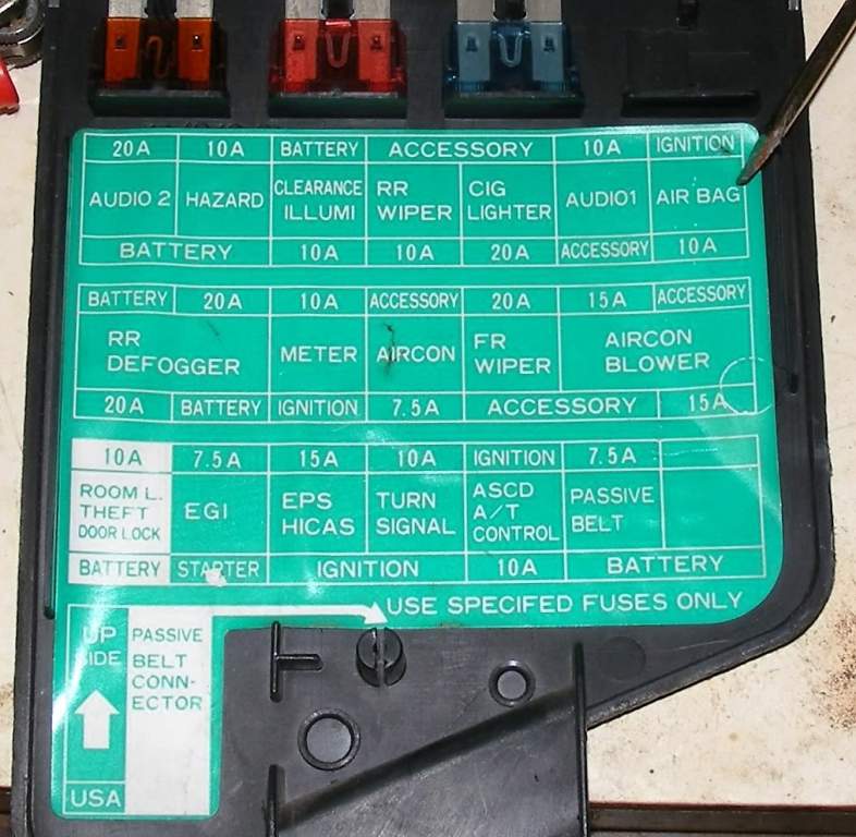

Main lights work ( main beam ) as a default even when side lights fuse has blown, check again driver`s foot well fuses top row third from left a red 10 amp one, just change it anyway for a known good one in case it has gone high resistance.

Top row fuse, should be a battery live, so check to be sure there is no fuse board issue, it the one marked clearance illumination.
Thanks Jeff. Have got on my back and checked all the fuse connections/looms and all seems OK. Have also got no indicators also, no clicking sound also. It's weird as the car starts no issue. What about the TCU? I recall replacing it a while back when my dash had issues. It's got me stumped! And it's likely to be something really simple!

There are no loom fuses under the dash for the lights, you need to check for power at the fuse with a test meter, if no power there then it could be a fusebox issue.
