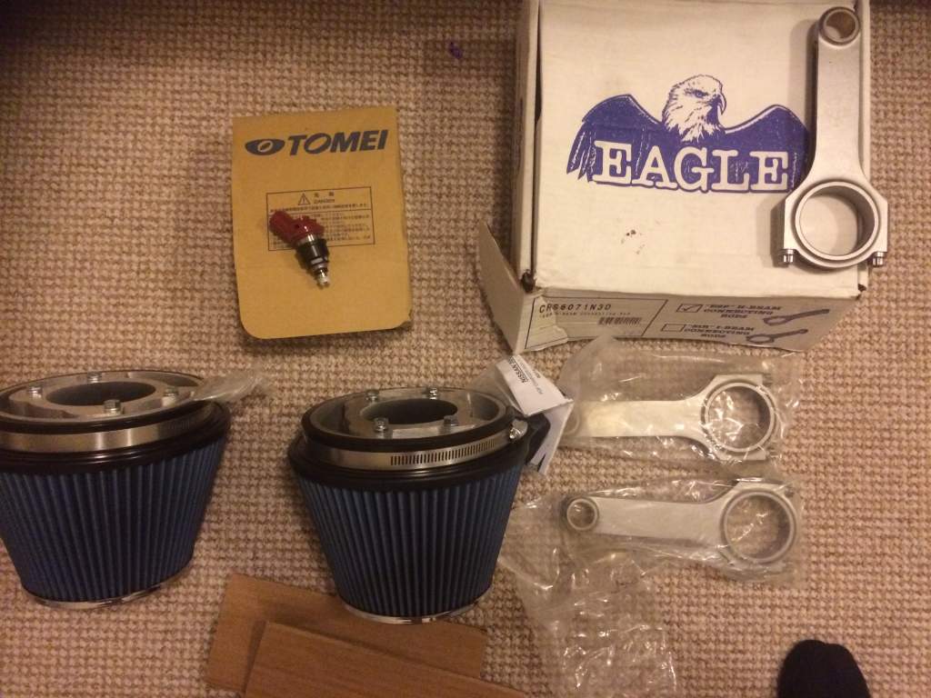

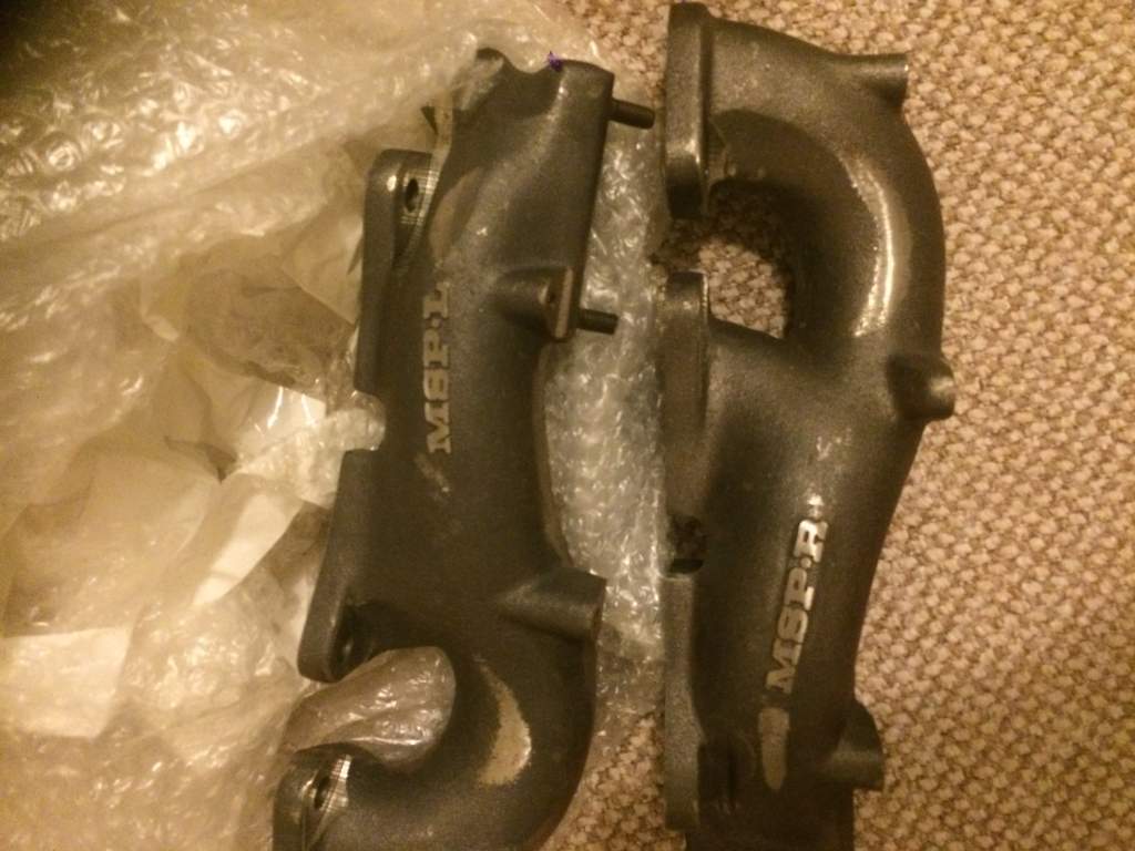

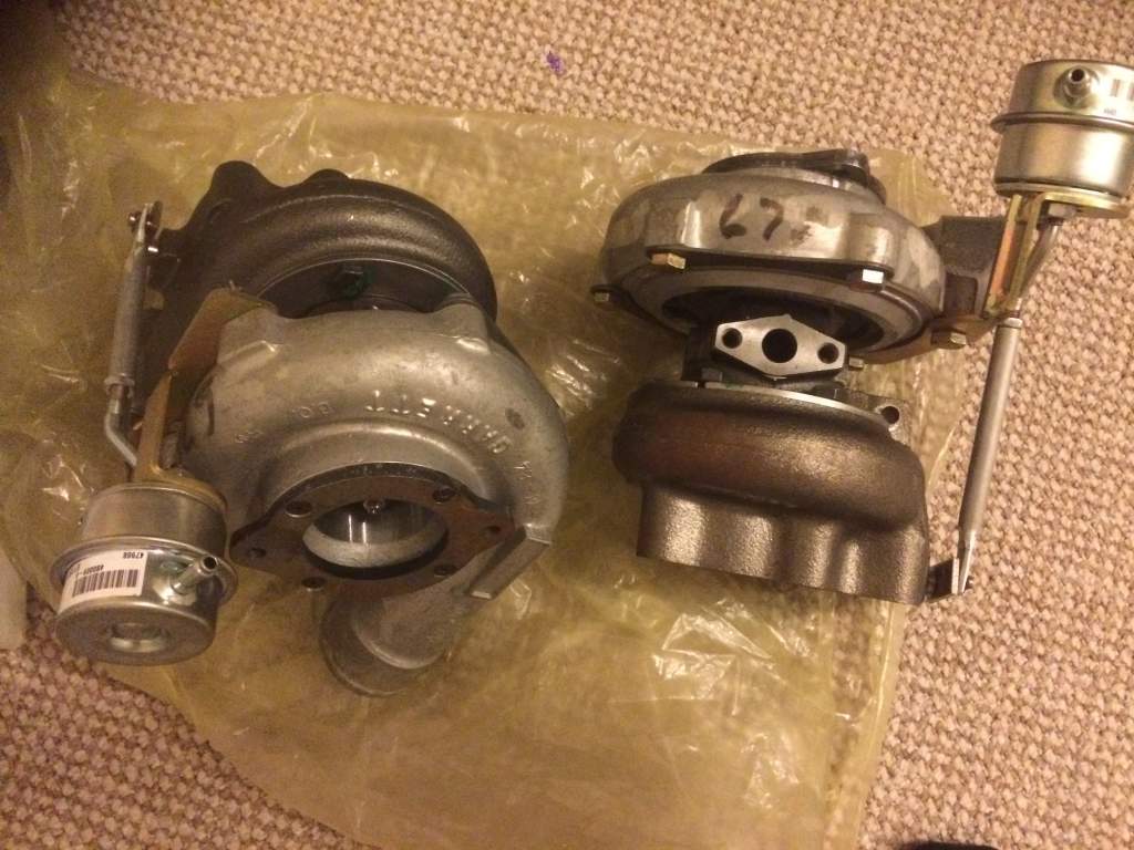

few part for the engine build but the car will be on the road with the bigger turbos i have on the car for now, but will get another engine to do a big build so far i have gt675rs turbos high flow mike smith manifolds tomei 740cc injectors eagle rods 2 air filter will be getting duel maf translater 2.5 inch intake pipe with z1 massive intercoolers the bigger throttle bodies not sure what cams am using yet a worked head maybe larger valves am loking for about 620 690 bhp

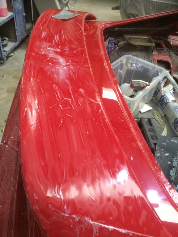

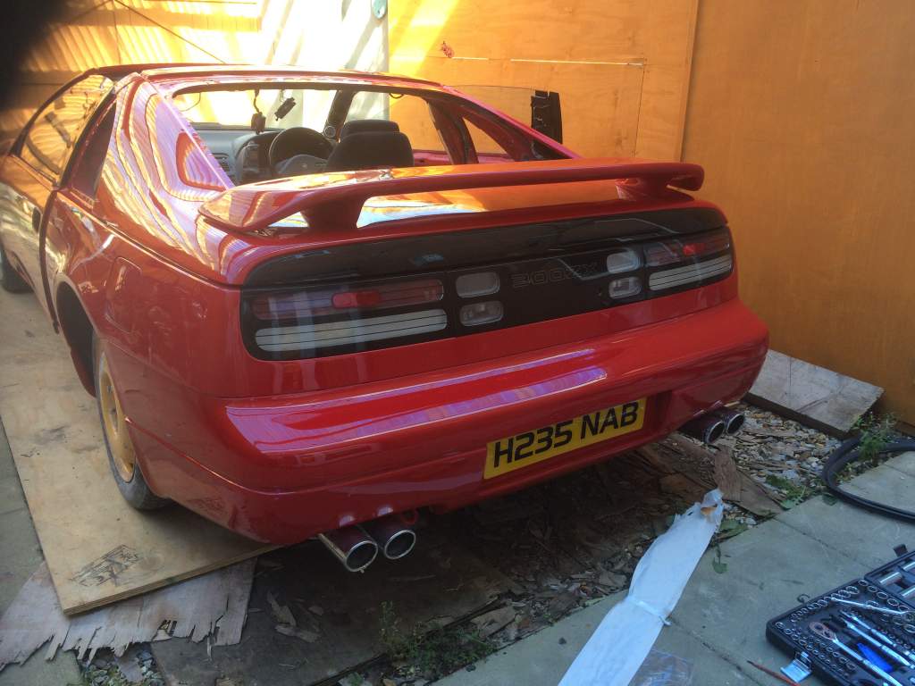

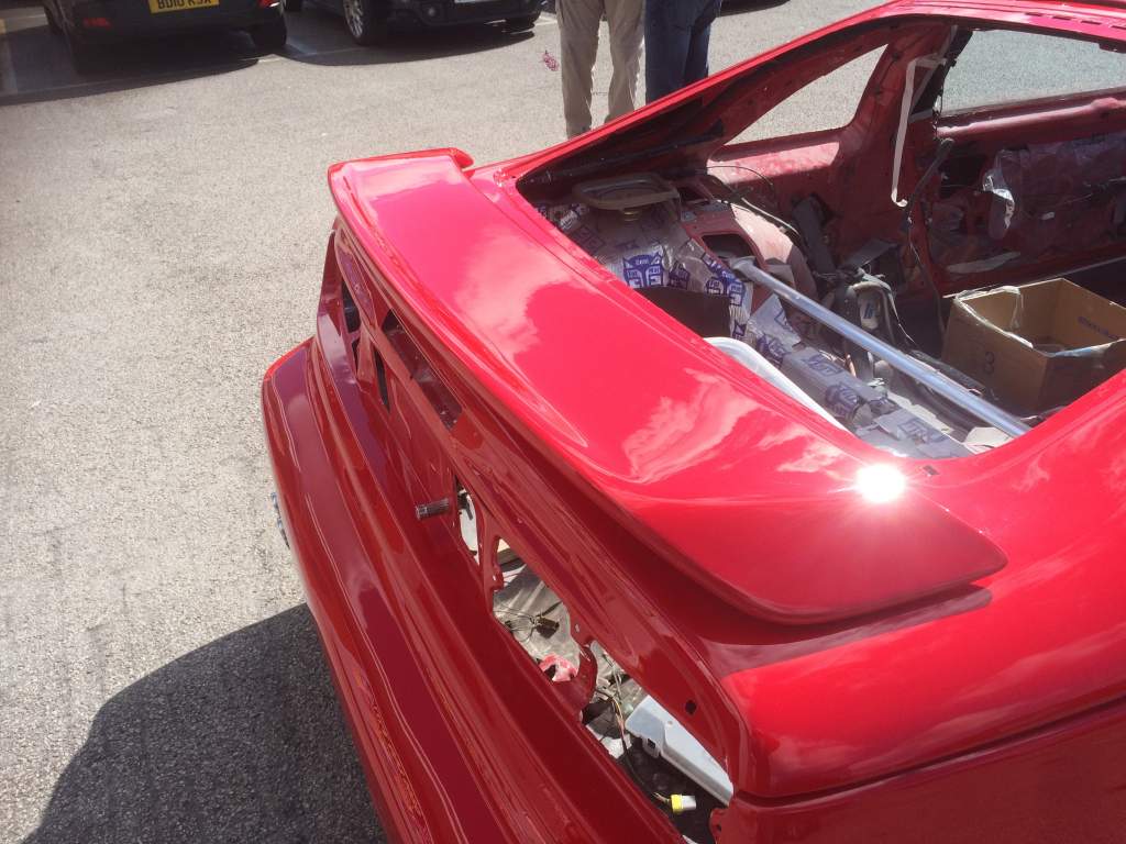

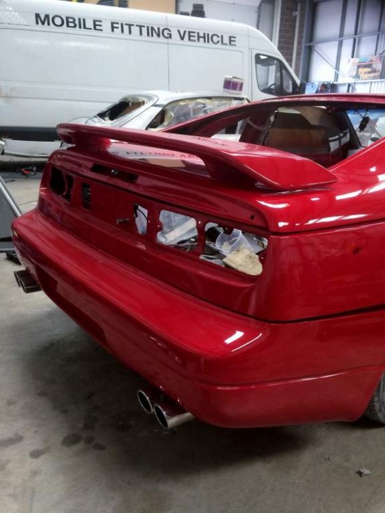

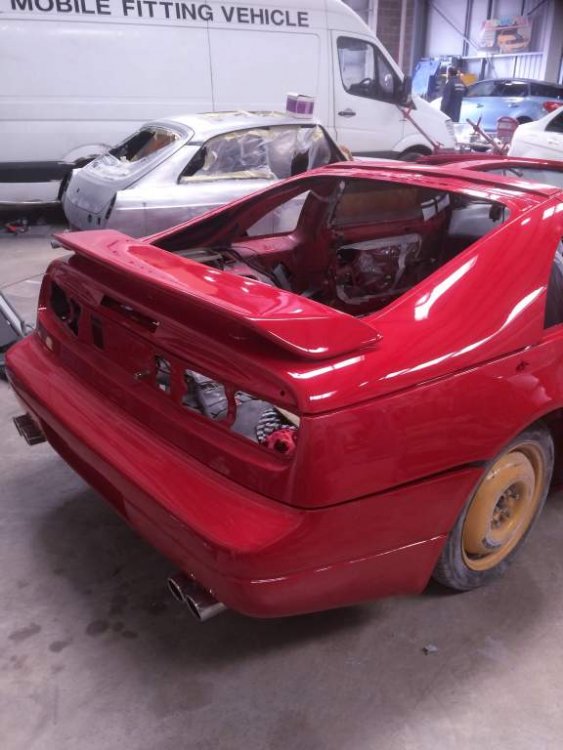

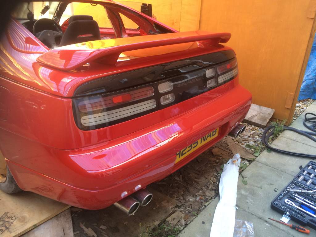

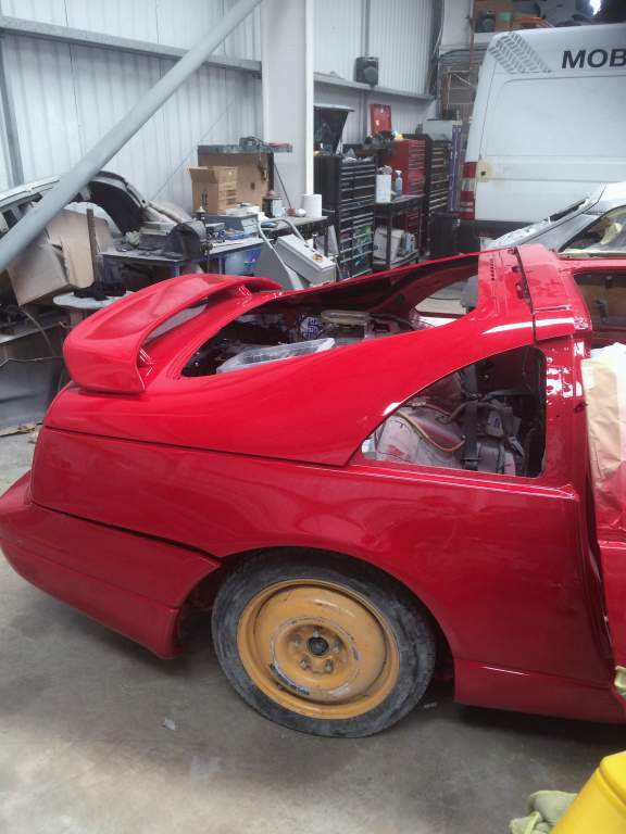

spent many hour at the body shop today got the rear boot lid on and the 99 wing fitted, so i started the wet sanding as am doing it now as the paint shop it taken to long all done by hand
A UK rear with filled in fog lamps, nice detail [emoji106]
i was waiting for some one to spot that. i have also filled in antenna hole rear wiper . front nose panel and bonnet jets
Ah yes the antenna, I didn't spot that as I'm so used to seeing mine without it now, it's become "the norm". Whilst I wasn't bothered by the washer jets, having seen it on a couple of cars now, it is another nice touch.

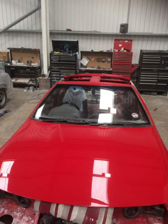

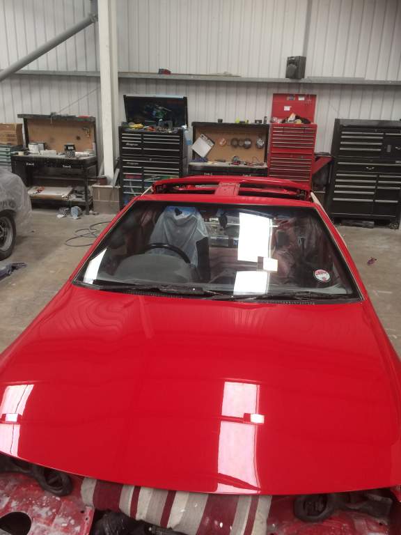

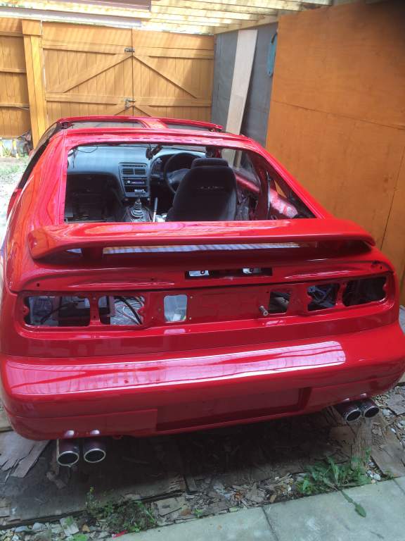

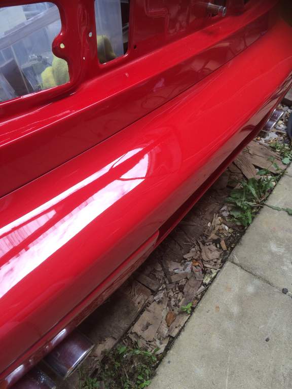

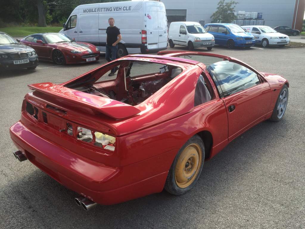

the wet sanding is done thanks god the car is coming home 2 moz at last will get some pic in the light of day but you can see here just how well its come up
the car is home at last time to build this all back up my fone cam does not pic up the colour very well its a audi red its really red in real life but fone cant pic it up

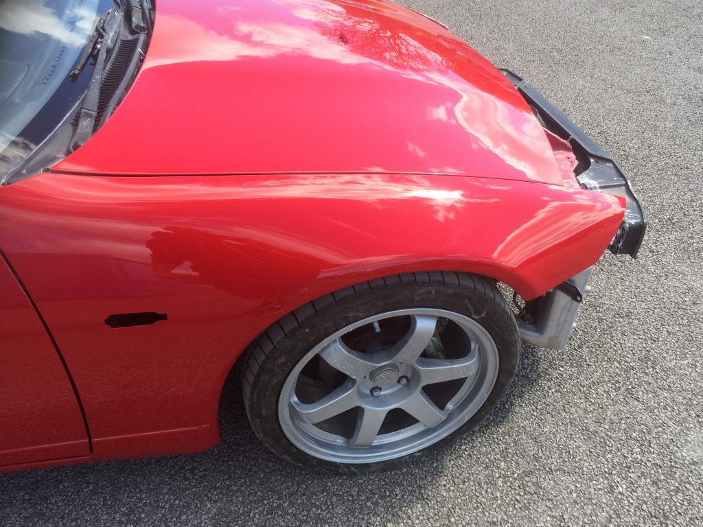

lights and panel in
Edited by dan300zx

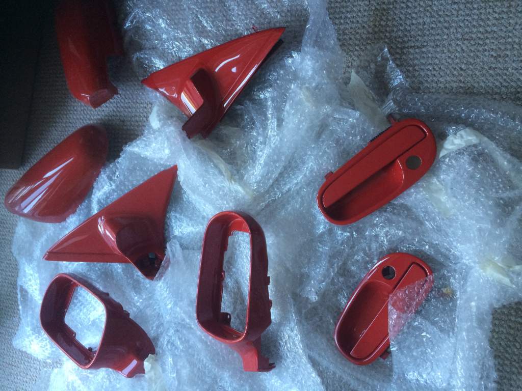

the rest of the parts painted to

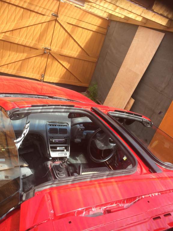

got the roof liner back in and t top seals interior mirror and few other bit had to stop for today as was getting a bit frustrating
put the mirror back together and fitted am very happy i did the same colour as the car just like the 99 cars looks much better also fitted door handles thats was a lot of messing to get the buggers back in

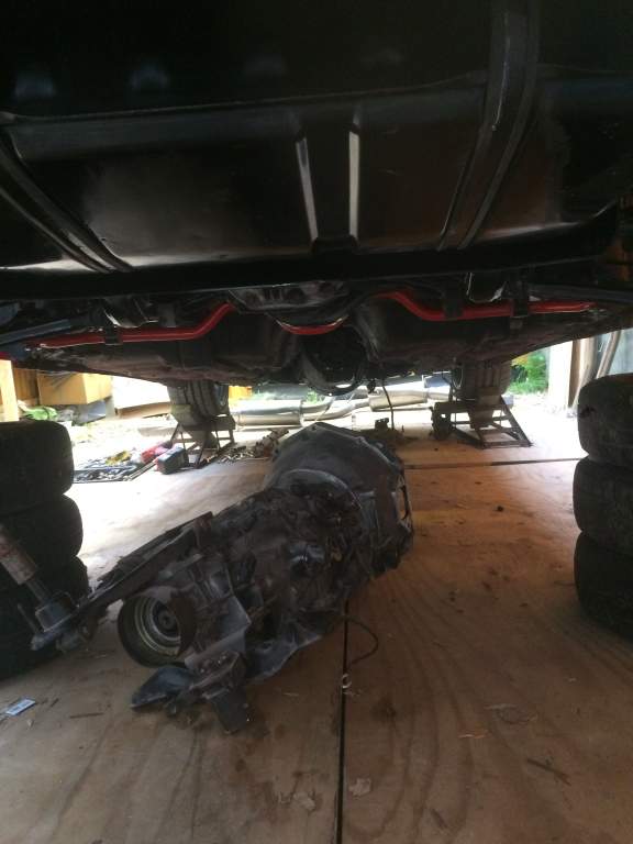

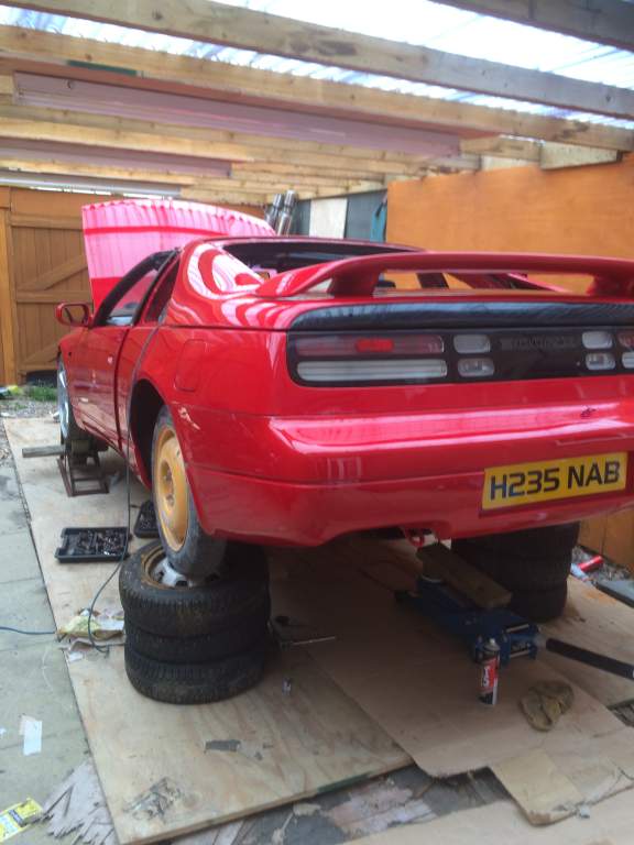

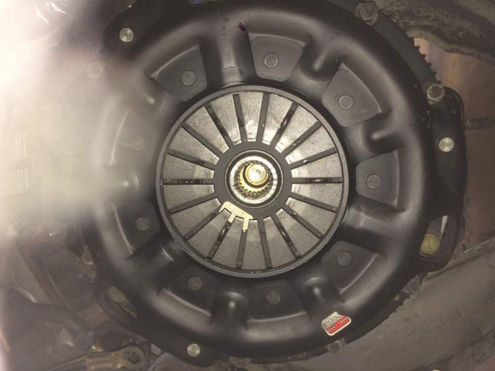

gear box out have a stupid leak buy the main seal its the were the sump meets the main seal so had to get the box out just done in on my own had nuff for today
am going to get rid of the egr while am down here to and plug the manifold,
