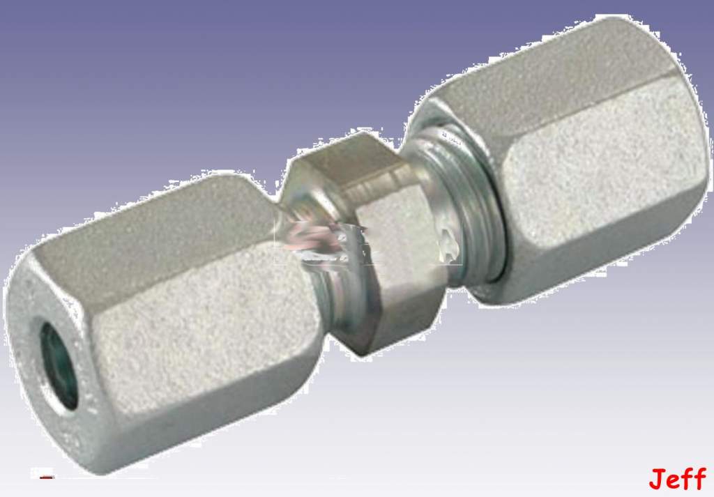

If you just have a leak at one point then you cut and fit a 10 mm line connector.
http://www.ebay.co.uk/itm/Hydraulic-Straight-Metric-Tube-Equal-Compression-Fitting-Coupling-Pipe-Joiner-G-/251226630053?var=&hash=item3a7e4627a5:m:mI8cZ3-fLseBdj6PPnq2KkQ

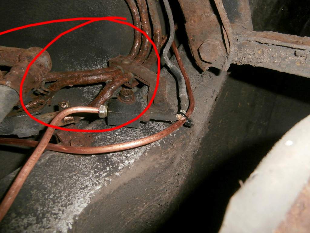

[ATTACH=CONFIG]94008[/ATTACH]
I'm not positive jeff but it looks like it's around the bend area where it goes up above the subframe.

You can buy 10mm pipe with connectors and make up a repair section, needs to be up in the air though lee, 10 mm pipe not the easiest to bend though, still cheaper than new Nissan sections, another option is to remove the hicas and the pipes become redundant.
