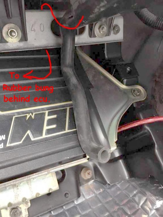

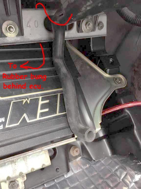

does anyone know were the end of this pipe connects to thanks

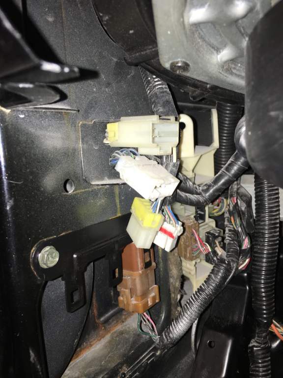

what the hell are these all for anyone know?
Looks like the drain pipe for the ac evaporator tray, when using the ac in Summer an amount of condensation forms on the evaporator and needs to drain away to outside of the car. Behind the ecu is a large rubber bung that the pipe passes through into the engine bay and when in place the end it turned down, often the water from this can worry owners thinking they have a water leak.
