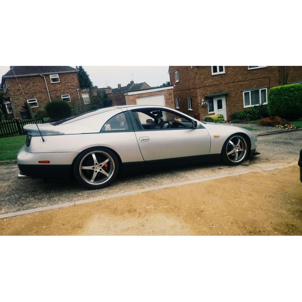

Only got the one on my computer at the moment! I will getting more up soon though
Nice zed it's laner 84 old zed think it's been to jimmer as well and was in good health
Ah that car down in somerset, sold by Ben. Good deal that was, i was going to buy it myself :p
Here are the pictures i have of your car http://imgur.com/a/QgIlF
