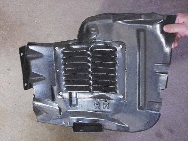

Not at all, valid points I think. Especially the exhaust part as that seems to be a poor design. My Peugeot 308 which has a small 3cyl turbo has a side mounted intercooler, with a big louvred exhaust vent on the inner fender liner. Seems like a good design and the vent is removable so I'm thinking of buying a couple to retrofit to my zx when I upgrade the smics, I've seen people use those bathroom/household vents but those are pretty rigid plastic and not soft like the arch liner
Sent fra min GT-I9100 via Tapatalk
Sport Compact Car's project 300ZX covered vents in the liners (scroll down to Improved Intercooler Airflow):
http://www.superstreetonline.com/how-to/project-car/0102scc-project-nissan-300zx-part-vii/
[ATTACH=CONFIG]93817[/ATTACH]
