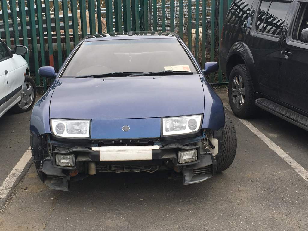

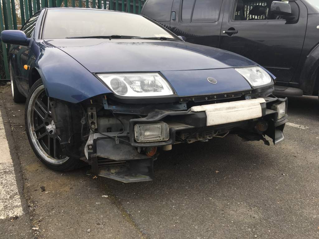

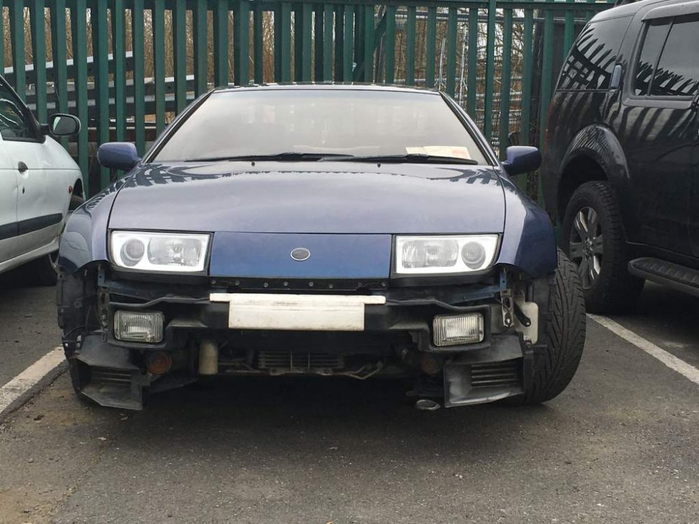

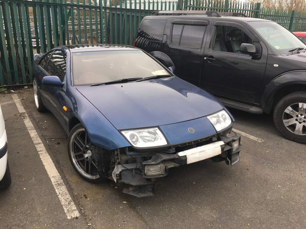

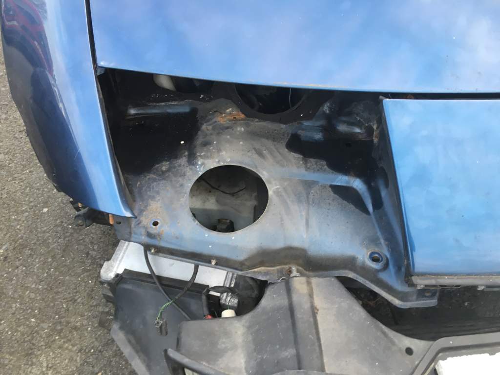

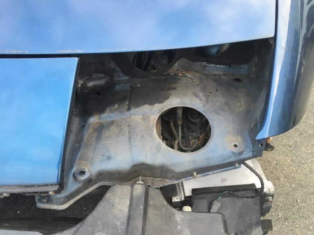

Had a go at removing the Headlights today, fortunately for me I started at the passenger side (which is a major PITA!!!) but everything after that inside left bolt was a walk in the park compared to it:biggrin: Grazed knuckles later and I've deleted the airbox pipes and am ready to fit the 99 Spec's. Still can't get over how clean this car is compared to others I've seen:thumbup:
Took the MAF off as well as the Induction kit while removing the lights, so I said I'd give her a run to see if she idled better.

Cut a slot into the end of the inside rear headlight bolts so you can wind them in and out using a flat head screwdriver.
Yeah, thanks buddy, I'd seen that on a link on here:thumbup1:, Going to the shed to do it this evening:yes:

I hope you'll be cleaning those small patches of corrosion :whistling:
Most definitely mate, don't EVER want to have to pull the headlights again (although, should be easier now I've slotted the inside bolts):yes:

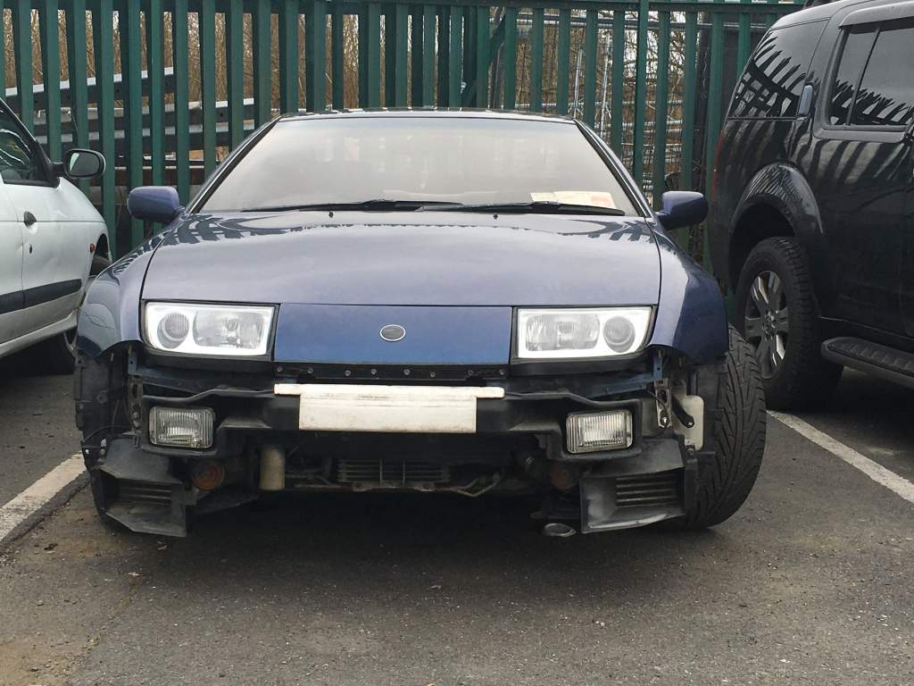

Went down to the garage this morning and fitted my '99 Spec headlights, I have to say they went in a lot easier than the old headlights came out:biggrin:
Anyway, I think they look 100 times better than the originals as the chrome inserts pop nicely against the blue:thumbup::thumbup:

I need a close shot of that tax disc :lol:
Ha!! I think it's 11/09:tt2:
They do indeed

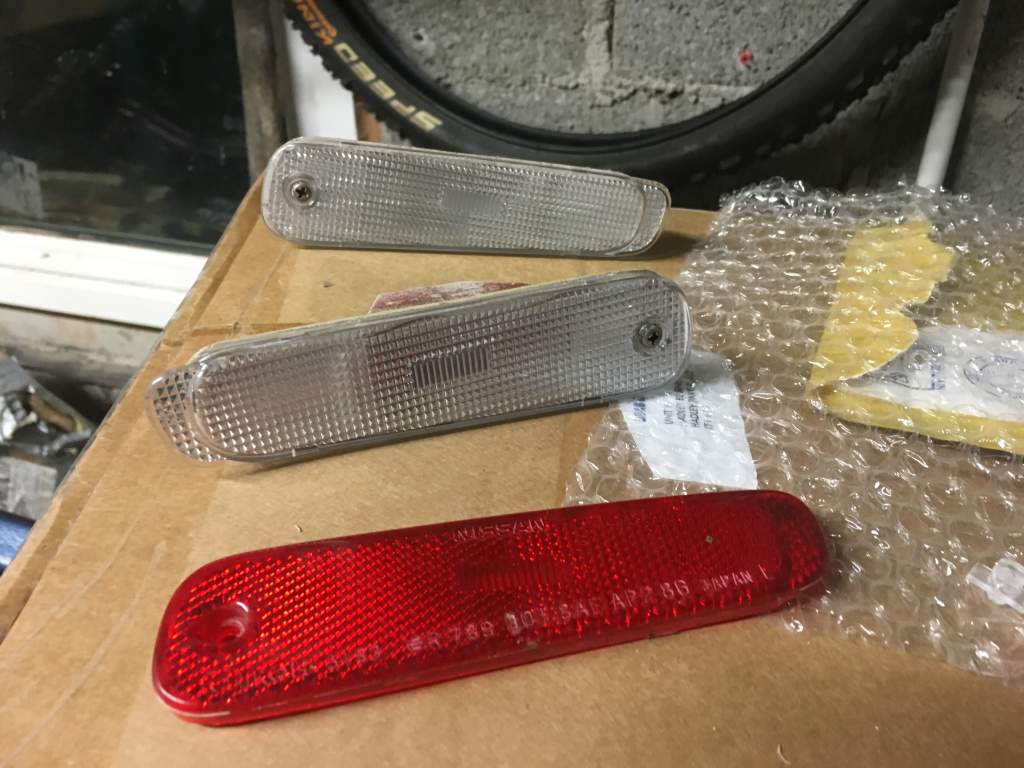

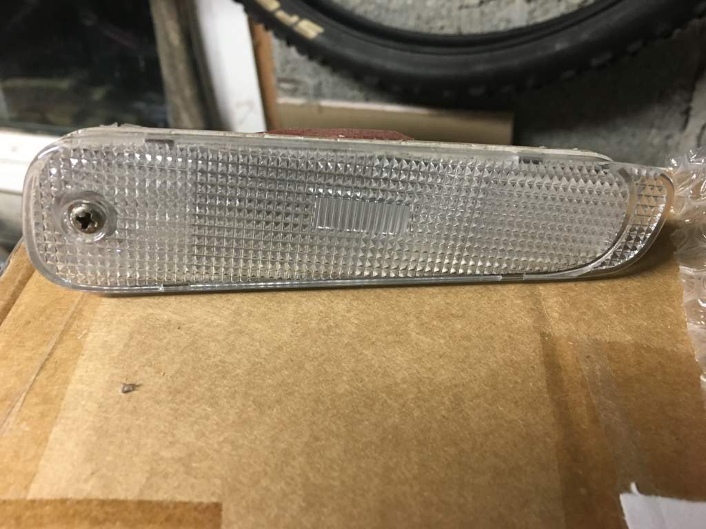

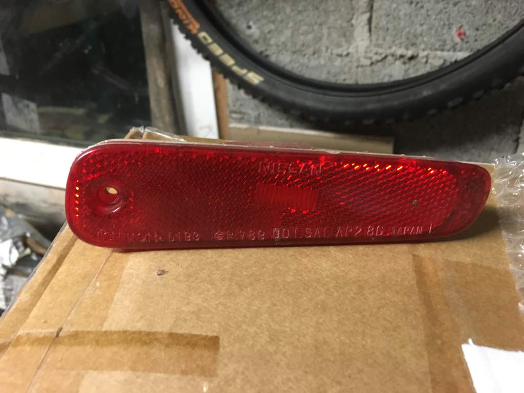

Went out to the shed last night and butchered my red rear side markers, fitted the Z1 clear covers to the casing instead, I think these will look ok:yes:
