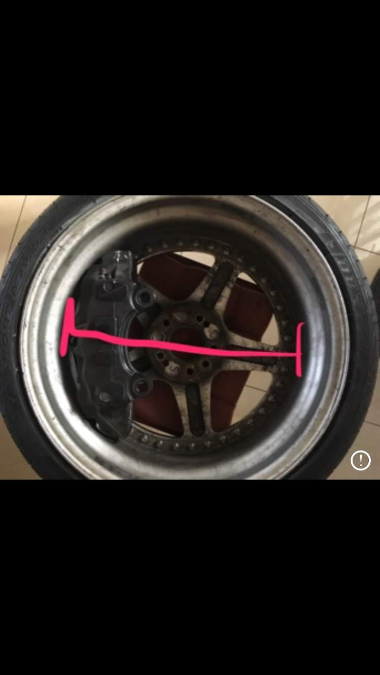

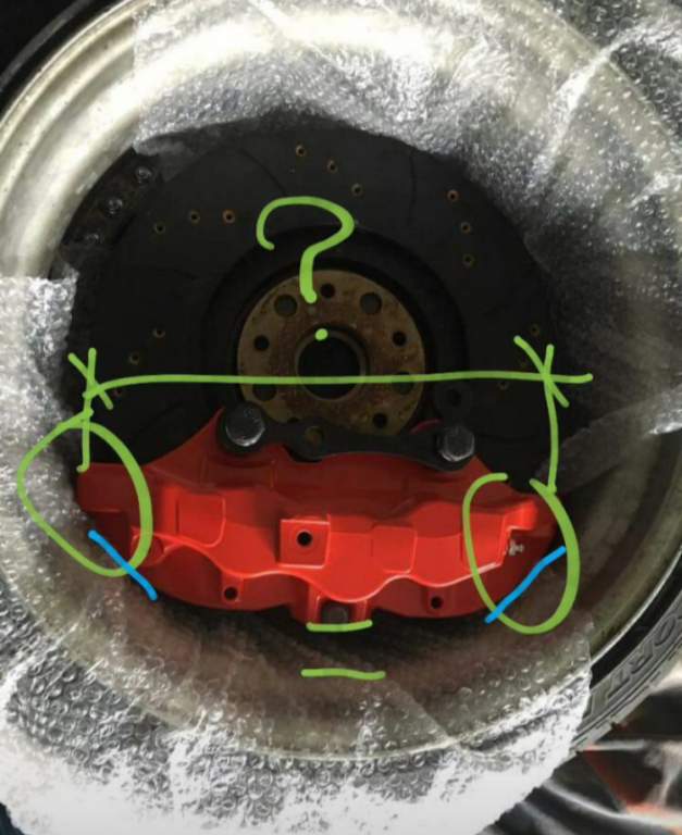

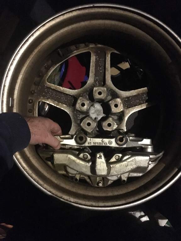

Wait!...so the AMG's will clear the inside double lip of the Veilsides and the SRT8's won't?
What size rotor will you be using for the AMG's?
Very interested on this as both my Blitz and my SSR's have a double lips inside.

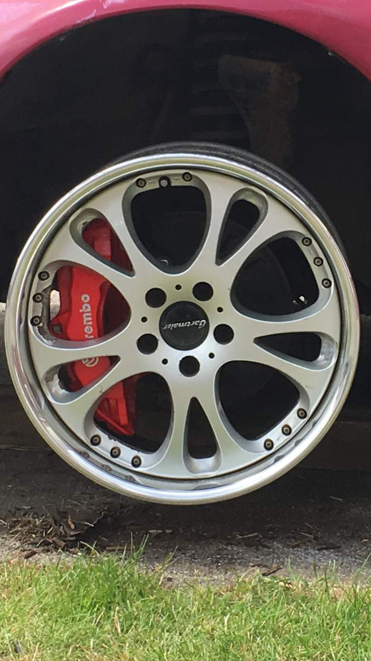

Yup, the SRT8’s are a chunkier caliper, whereas the AMG and Brembo 18z’s are narrower at the ends, thus making them fit inside all my 3 & 2 piece 18” wheels.
I’ll show you what I mean...
AMG inside 19” Equip
Porsche Brembo 18Z inside my 18” Veilsides
Brembo 18Z inside my 18” SSR Gartmaeir’s
The fatter ends make it hard to fit a 3 piece 18” wheel over the caliper, Forged 18” 1 piece wheels like Volk TE37’s and Enkei’s will clear them as they don’t need as much of a step:thumbup1:
I’m selling the Brembo 18Z setup which will fit inside both your wheels Rob:thumbup1:
You really should try and subscribe to see what’s on offer in our Buy, Sell and Wanted section:thumbup:
SRT8's inside the 18" Veilsides, note the ends are all that catches.
Edited by Richie K
Very nice...Thanks for the photos Rich...Is that a 370Z disk?
Yup 355mm

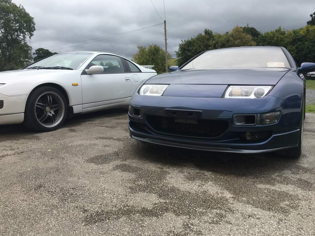

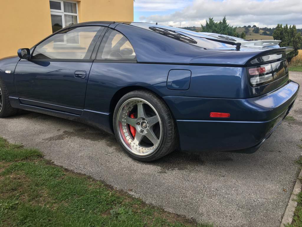

So, after a year and a half, I finally saw my blue Z with all its goodies fitted and a fresh coat of paint... to say I’m ecstatic is an understatement :punk::punk::punk:
Keith has done a fantastic job and I’m back loving at least one of my Z cars :thumbup:
So Thanks Keith, you LEGEND
I’m loving my new rear Ass :clap:

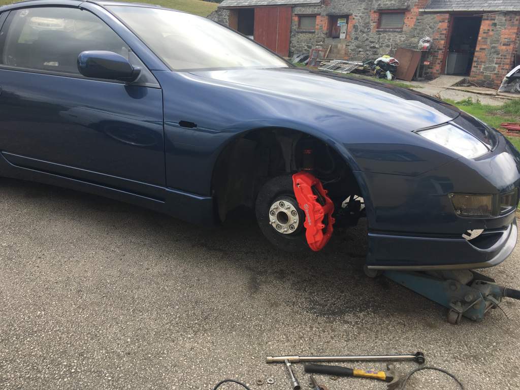

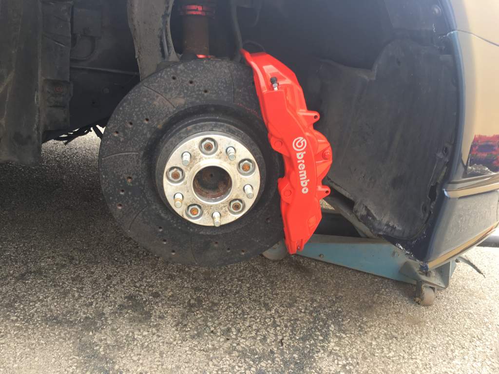

Today, we (mostly Keith) swapped out my big chunky Brembo 6 pots for the more wheel friendly, svelte Brembo 8 pots, I now have loads of room behind the 19’s and enough room for 18’s also:clap:
The Master at work :yes:

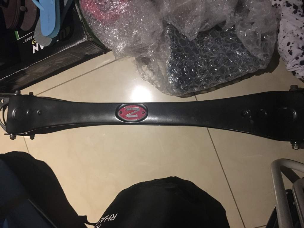

Forgot to mention that when I met the guys in Manchester for the Cafe XL meet, Ian Greenfield was so kind to bring along another rare JDM piece of the jigsaw....
My Tokyo Auto strut brace :clap: Ian has been minding this for me since I bought it off him approximately 2 years ago, so thanks for minding it for me matey and thanks for dropping it over :thumbup:
Question is, do I strip it down and polish it, powdercoat it silver, blue, grey etc or leave it as it is ??
[ATTACH=CONFIG]114075[/ATTACH]
Mine was powdercoated by Wheel Wizards in close to the original silver, and it came out great.
I painted the Z badge myself though and the paint was immediately flaking off. Need to do a better job with that!
Any pics of it in silver Jay??
And mine is chrome plated and like you a badge that I did myself, i'd powdercoat if I was you in a silver sparkle :).

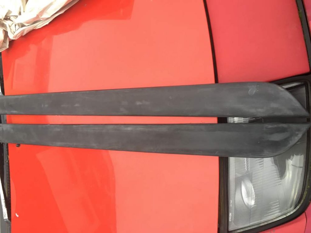

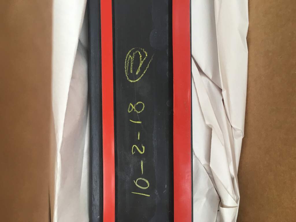

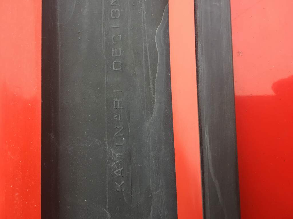

Last piece of the jigsaw puzzle that is my blue Z :clap:
Brand new genuine Kaminari door fillers to match up with my skirts, produced on the 2/10/18 :clap:
