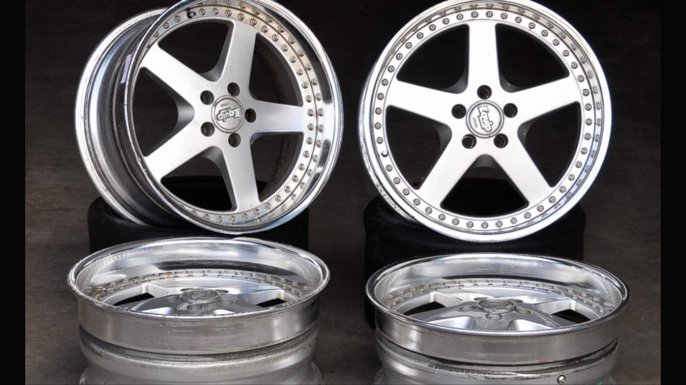

So I bit the bullet regarding my mahooosive Brembo's, took Slick Pete's advice and pulled the trigger on a set of 19's:whistling:
Won't have them for a while, but I figure there's no rush:innocent:
I've been told that these are quite rare in a 19", not my perfect fitment, but might be able to play around with them. Thinking of putting the 9.5 to the front and adding 1.5 - 2 inches to the 8.5's. Need to get someone to work out offsets. The Veilsides are 11x18 et36 and just clear the rear calipers, both the front and rears are et25, I can always go 8.5 front and add .5" - 1" to the 9.5 rear, or am I as well off going 8.5 front / 9.5 rear with a 10 mil spacer all around??
Si, Joel and any other "Wheel Guru's" could I have your input and opinions please??
Anyway, here's a pic:thumbup:
Lovely wheels, 19" Work Equips [emoji7]
So to clarify, these are 2x 19x8.5 ET25 and 2x9.5 ET25?
YUP:thumbup:
For reference, my rears are 9.5" ET25 and my fronts are 8.5" ET22 so a pretty close comparison. It really depends on whether you want straight fitment out of the box and whether you will modify arches or remove arch liners etc. You also need to consider whether you want meaty, flat or stretched tyres and the ride height/camber options.
I'm personally reasonably happy with mine, although aesthetically I feel the fronts could do with small spacers to match the "flushness" of the rear. However, with only a 5mm spacer, the tyre rubs on the arch liners slightly on full lock so I left them as is.
If you want more width from the rears, I'd say leave the spokes and front barrel as they are and get a wider inner barrel, you'll have an inch or 2 to play with (you'll have to measure).

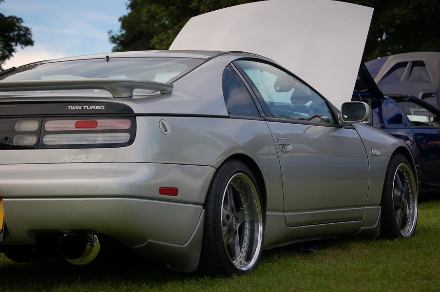

Partly for me posting is that i stumbled across this picture of mine from about 4 years ago, reminding me that less is more.
What about mine :crying:.
[ATTACH=CONFIG]107963[/ATTACH]
I knew you had Equips Andy, Love them, they're period specific and cool as feck, I think Joel means the sizing, as i've been told these are rare in a 19" fitment. What's the specs on yours ??
19's on a shorty will look too big but i must admit i do look for other Quips but never find much better than what i have.
Anyway, here's the spec you asked for.....
17" Work Equip 05 3 Piece Split Rims, polished rims with Light Shadow Chrome centers, refurbed Oct '16.
Fronts 8J +30 offset can bolt straight on but I have them fit with 15mm hubcentric Eibach spacers, tyres are 235/40/17.
Rears 9J +28 offset bolt straight on, tyres are 255/40/17.
