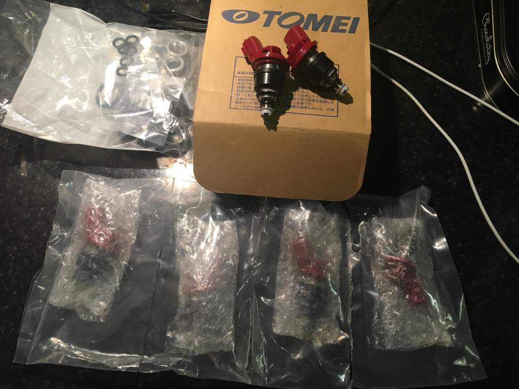

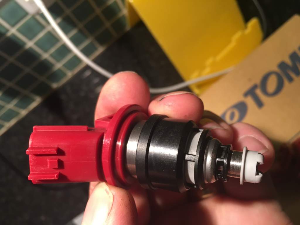

Oh and yesterday i got these....
Tomei 740cc injectors

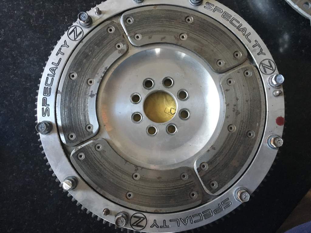

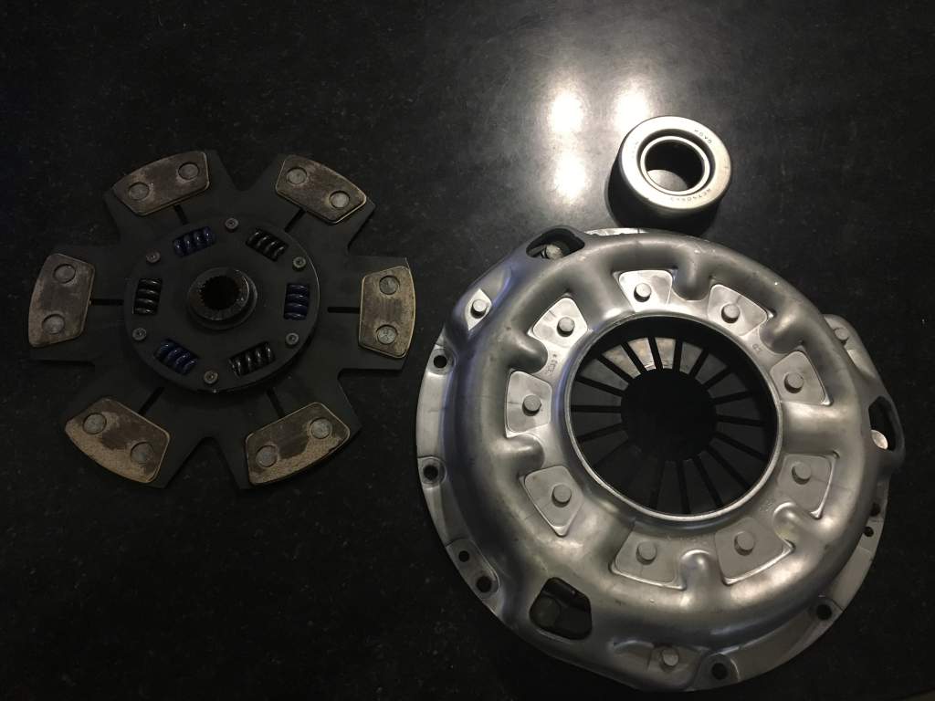

This afternoon I got these little gems
[ATTACH=CONFIG]102944[/ATTACH]
[ATTACH=CONFIG]102945[/ATTACH]
Specialty Z / RPS segmented flywheel and RPS 6 puck sports clutch:clap:

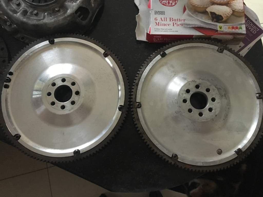

What's the advantage of the segmented flywheel. Surely it would just wear out the clutch quicker?

When you have a min, can you take a photo of the other side? SZ improved the starter ring gear to flywheel mounting
and I would like to see what they did.
I did wonder who bought the 740cc injectors, tempted as I was...

Thanks, sounds interesting but is warping flywheels a big problem? or only for a problem intense track or drag use? I can't imagine a traditional flywheel warping under normal conditions otherwise they would all be segmented.
If you slip the clutch (for whatever reason) - then the problem can occur with lightweight aluminium flywheels and their one piece steel facings.

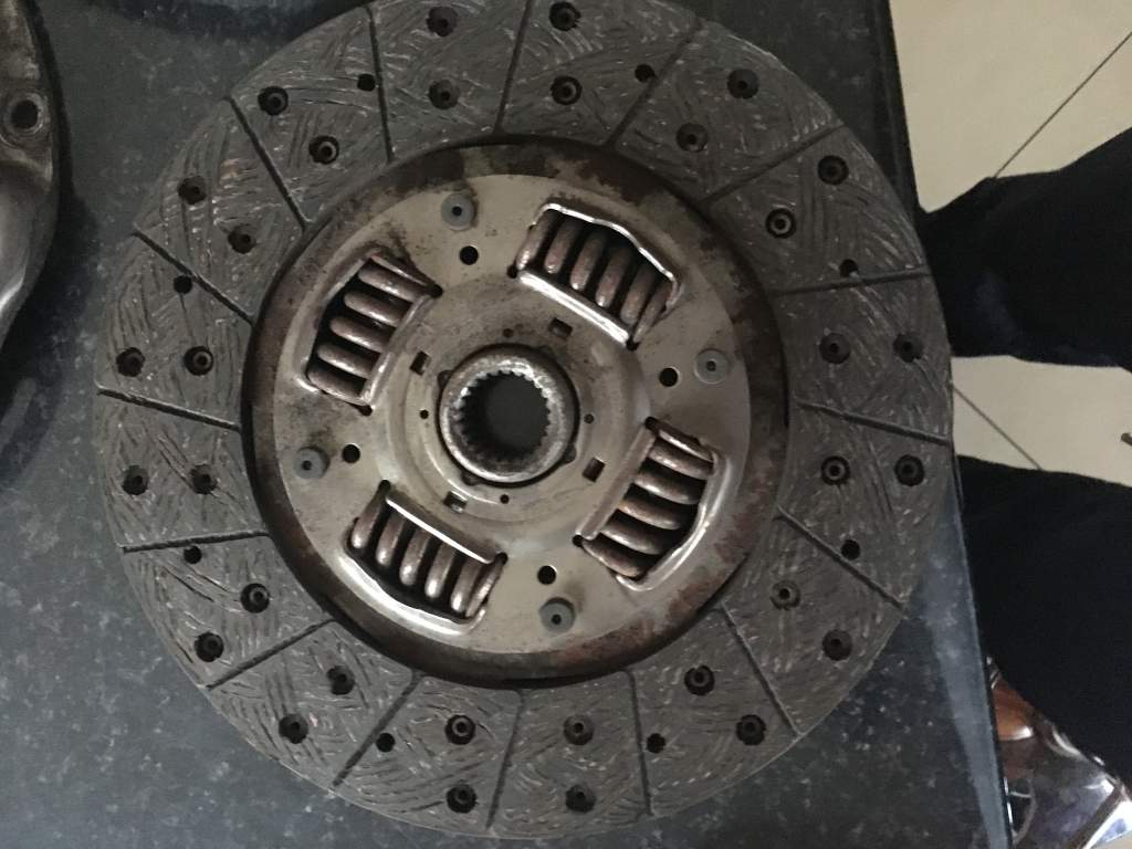

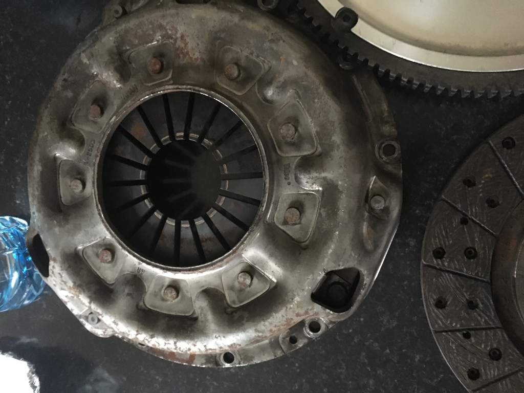

Went down to the garage today and removed my near new Exedy stage 1 organic clutch and RPS segmented flywheel. (300 miles max)
Andrew, here's a pic of the rear of both flywheels buddy

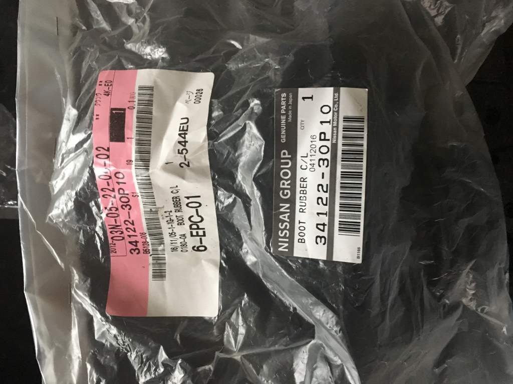

Picked up another oem part, nothing special but want the car put back together right:thumbup1:
Top shifter boot

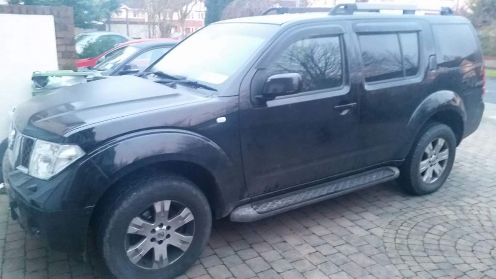

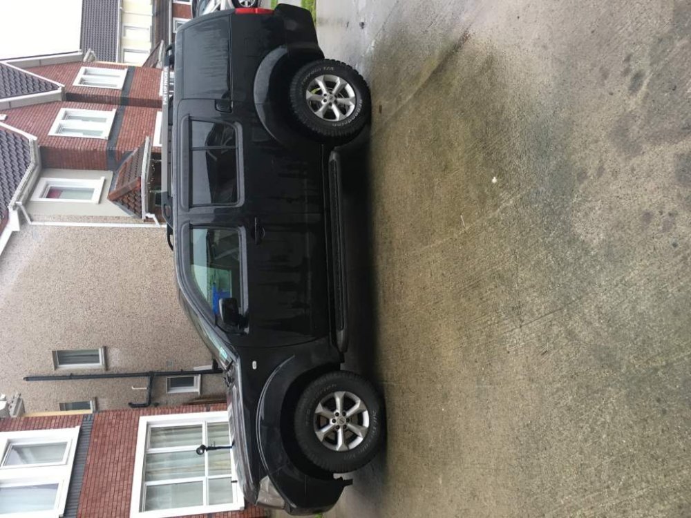

Spent the last week concentrating on tidying up my daily driver, got a great deal on a set of 5 brand new Navara alloys and near new BF Goodrich All-Terrains, these are in a much more chunky size (265/70/17) which is what I wanted but couldn't afford, for a total bargain of €400 :clap: (was going to change just the front tyres for €330):thumbup: He was suing Nissan due to a rotted chassis on his 06 Navara, so told me if I needed anything else to work away and help myself. Switched out my broken Auto Climate Control blower module (€140ish), and my boring black plastic interior handle that I'd used to replace my broken chrome one. I've both front wings dented/bashed by the previous lady owner and commented on how his also had dings and dents. He then told me that he'd gotten his replacement worn tyres and wheels off a Pathfinder at his friends breaker yard down the road, He told me that it was black and in great condition body wise, I called down and mentioned his name to the owner of the breakers, who then told me to have a look and then "make a deal" with him. Heal of the hunt... Walked away with two perfect matching front wings, 4 factory mudflaps, factory rubber boot mat (€60) and the expensive Nissan option of a rear spoiler (close to €450 painted + fitted). Got the lot for €70:punk:.

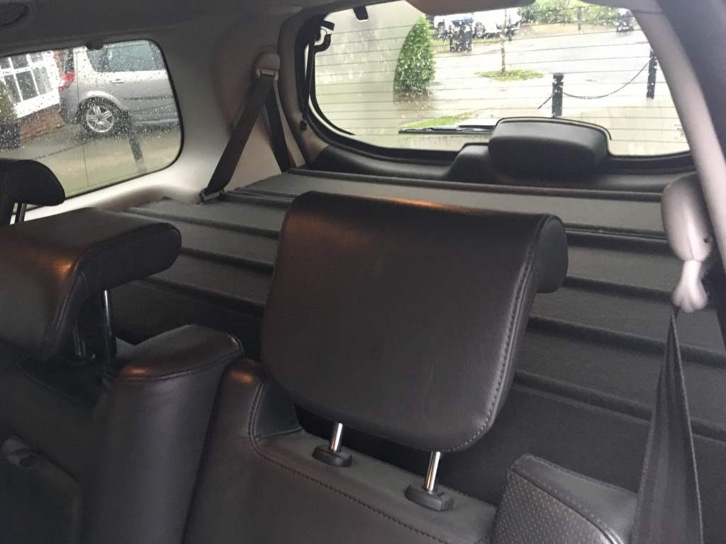

Did a search on various sites for the rear parcel shelf as the Pathie felt like a van with the boot exposed, Seen one on an Irish "Buy & Sell" site for €60, offered €30, he let it go for €40, later I looked at EBay (to make sure I wasn't being ripped off) it had two for sale, €183 & €210 plus shipping from the UK:scared:. So another bargain. Found a 2 month old Pioneer App Radio with €90 worth of leads and accessories (Steering control harness / HDMI / Lightning cable) on another Irish site 20 mins North of Dublin and as I was already in Dublin Christmas shopping made a cheeky offer, got it for €290:thumbup: Told Jo that it can be my Christmas pressie:thumbup1:. It will also fit both the Zed and the Pathie:thumbup:
Planned on doing the wings and spoiler today but it's so wet over here.
Anyway here's a before and after (so far)
After
Doesn't look like much, but she's sitting nearly 2" higher on the bigger tyres, makes it look much more purposeful. The parcel shelf makes it feel more refined than just having a gaping, open space. She's to get a further 2" lift (shipped) when they arrive. Stereo looks near factory with fit etc. Getting the rear reversing camera fitted tomorrow for peace of mind when reversing the beast.
Can someone rotate the pics for me??
